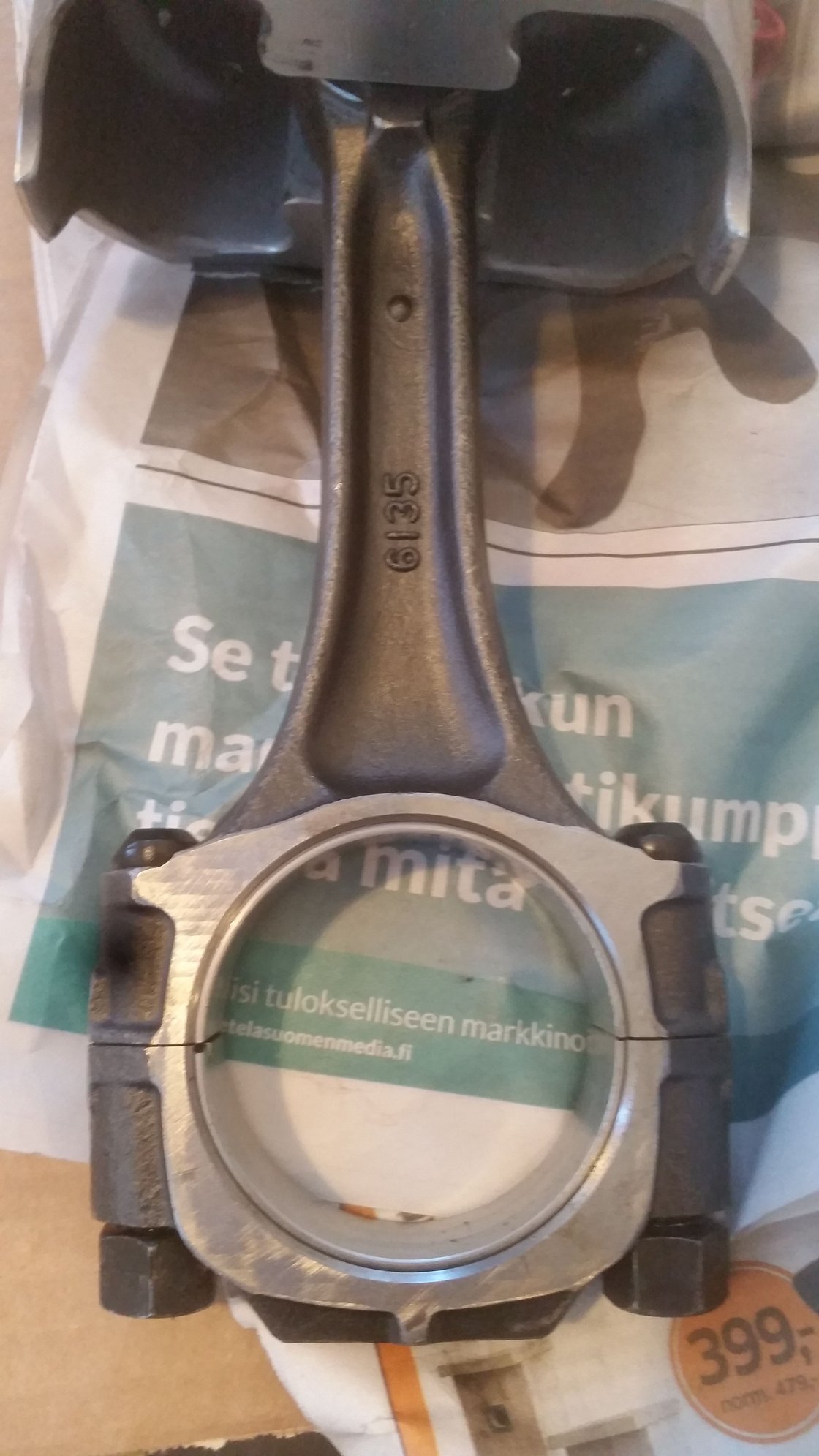

What bbc rods?
Acording to the seller these are eagle rods, cannot find any info about these. Lenght 6.135". 7/16" bolts. https://cimg1.ibsrv.net/gimg/www.off...1645e39cae.jpg
https://cimg7.ibsrv.net/gimg/www.off...6390508bed.jpg
https://cimg1.ibsrv.net/gimg/www.off...b66cb216f1.jpg
https://cimg2.ibsrv.net/gimg/www.off...2132d124db.jpg
BBYSTWY 03-26-2019 11:05 AM
I may be wrong but those look like regular ole gm dimple rods to me...from the eagle ones I found in a google search they all had bolts like 12 point arp bolts bolting the cap on....those look like the standard gm nuts to me...like I said could be wrong
JaniH 03-26-2019 11:19 AM
i think so too. pistons are je700 series with very slight dome, could be stock bbc 502 rods and pistons.
BillK 03-26-2019 11:23 AM
The stock GM rods would not have the "6135" cast into the beam or the numbers etched into the parting line. Those are most likely either Eagle or Scat. I cant remember if the Eagle's have "ES" along with the "6135" on the beam.
ThisIsLivin 03-26-2019 12:18 PM
I have a set of the GM dimple rods and the 6135 is not on the rod.
JaniH 03-26-2019 02:12 PM
This is confusing. 😤
F-2 Speedy 03-26-2019 02:22 PM
Ive never seen a GM rod with the length embossed in it,
JaniH 03-26-2019 02:34 PM
KXV, stamped to the rod bolts.
https://cimg2.ibsrv.net/gimg/www.off...0f5a7e3716.jpg
f_inscreenname 03-28-2019 11:41 PM
Sounds like you will have to take the sellers word for it. Its the part that sucks when buying from someone else and they don't come in the original package.
BillK 03-29-2019 06:07 AM
You might want to also give Eagle a call. They are pretty good about answering questions. They might be able to tell you something based on the rod bolts and the etched numbers at the parting lines.
