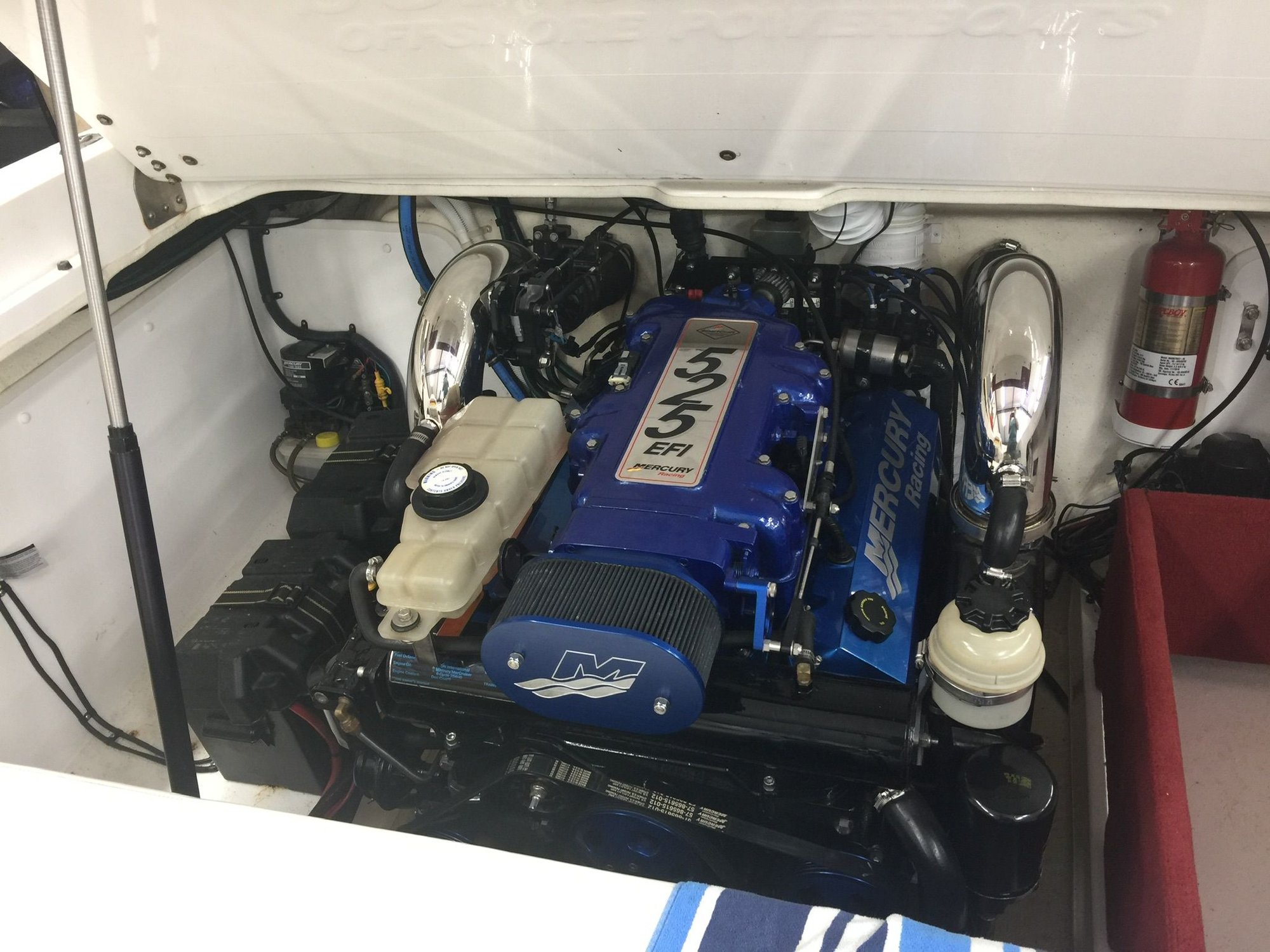

Just some clarification I should have put in the initial post. We did the initial bleeding without running the engine when it was connected. Once we ran the motor it seems to still have air trapped that will not work its way out. The system also has Automatic transmission fluid in it should I change it out for power steering fluid? That is what was in it before the motor swap. What is happening now is the fluid is foaming due to the excess air and overflowing the reservoir when running the engine.
14 apache 04-08-2019 09:06 PM
does it have remote reservoir ?
Lil Mick 04-08-2019 09:30 PM
yes that is what is overflowing when it foams up.
F-2 Speedy 04-09-2019 07:43 AM
What pump do you have, where does the return from the helm connect, does the remote reservoir have 1 or 2 ports ( fittings )
Lil Mick 04-09-2019 07:16 PM
The pump looks like stock PS pump. The reservoir has 2 lines one to the pump and the other looks like it goes to the cooler.
14 apache 04-09-2019 07:20 PM
Is the cap to fill it on the pump?
Lil Mick 04-09-2019 07:28 PM
No on the remote reservoir.
14 apache 04-09-2019 07:50 PM
Post a picture of reservoir and pump
Lil Mick 04-09-2019 08:09 PM
Lil Mick 04-09-2019 08:23 PM
Thanks to 30Outlaw for giving me a copy of the manual. We will try to bleed it tomorrow according to the manual. I know this was not done like the manual shows when we installed the engine. I will let you know how it goes.
