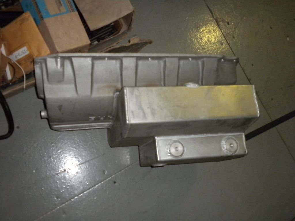

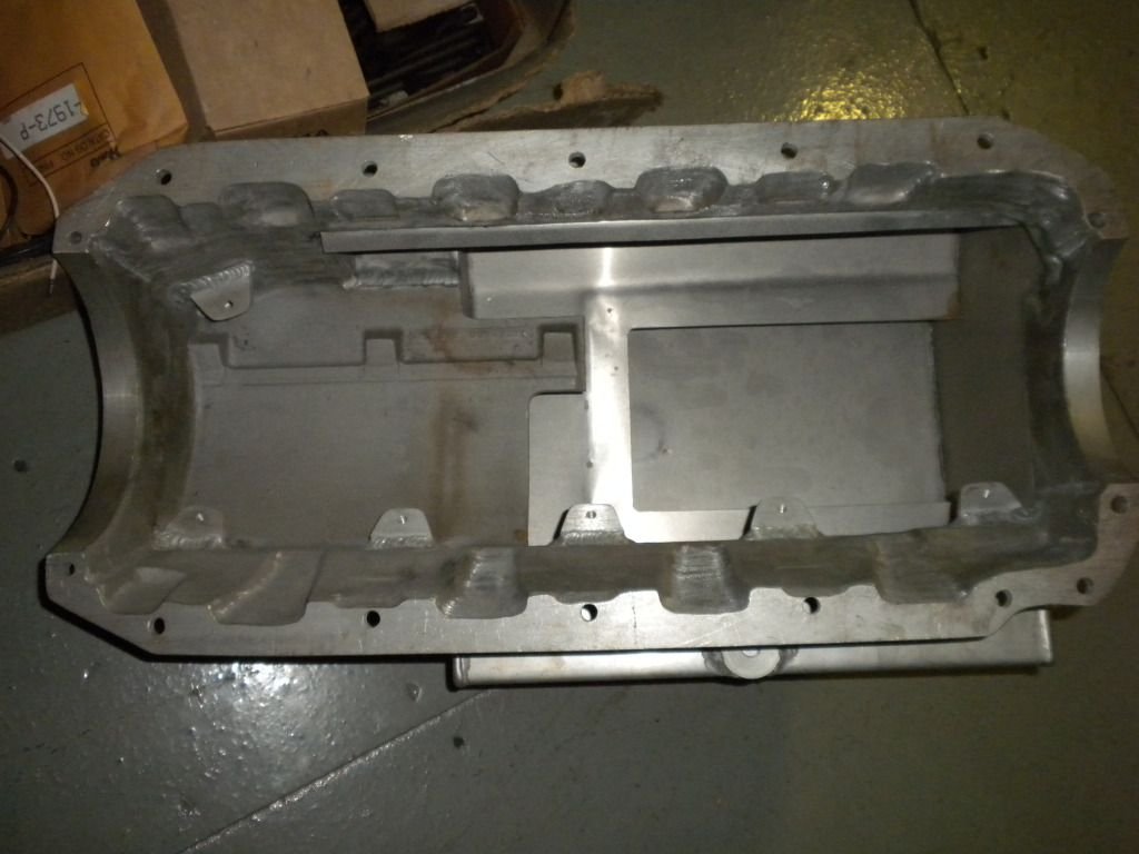

Mbam 08-23-2019 02:41 PM
https://cimg1.ibsrv.net/gimg/www.off...3bc257f923.jpg
https://cimg2.ibsrv.net/gimg/www.off...a04b00996c.jpg
https://cimg3.ibsrv.net/gimg/www.off...ee01182aa1.jpg
This is a really nice pan for a big motor. The small sump on the bottom keeps the pickup submerged very nicely. Too bad you can't use it :(
