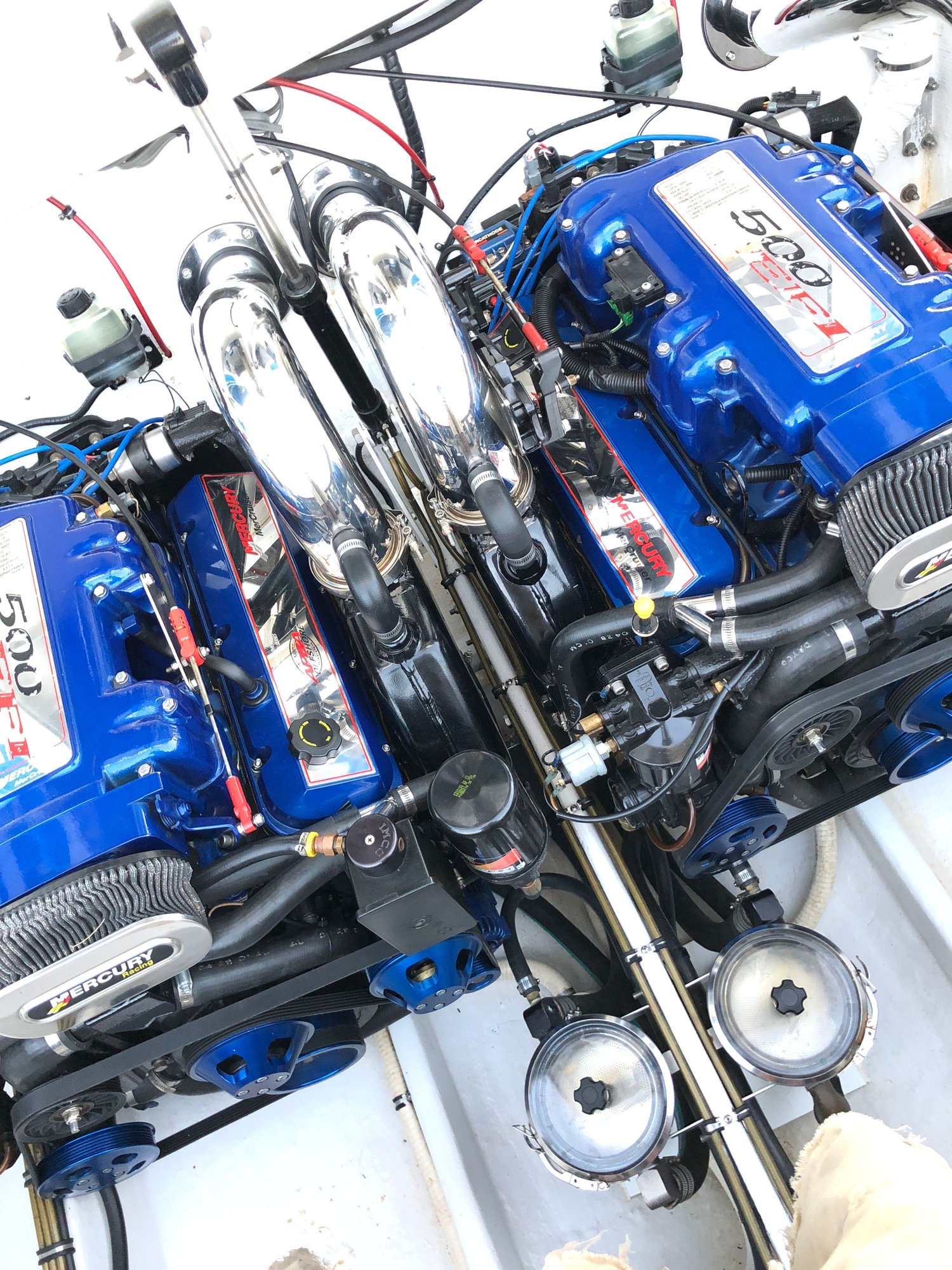

You have Stainless Marine with nice risers.... DON'T TOUCH IT !!!!!
Performance wise you have good exhaust... Dependability wise you have good exhaust, A little extra bling is not worth header headaches. Do a search on here for cmi/header cracks/leaks......
You want bling?? for what you would spend on headers which are going to net you zero performance wise, you could stick a say, 250 blower on it and actually gain some performance
EMARTELL65 09-21-2019 05:30 PM
Thanks for the feedback. In other words save the money.

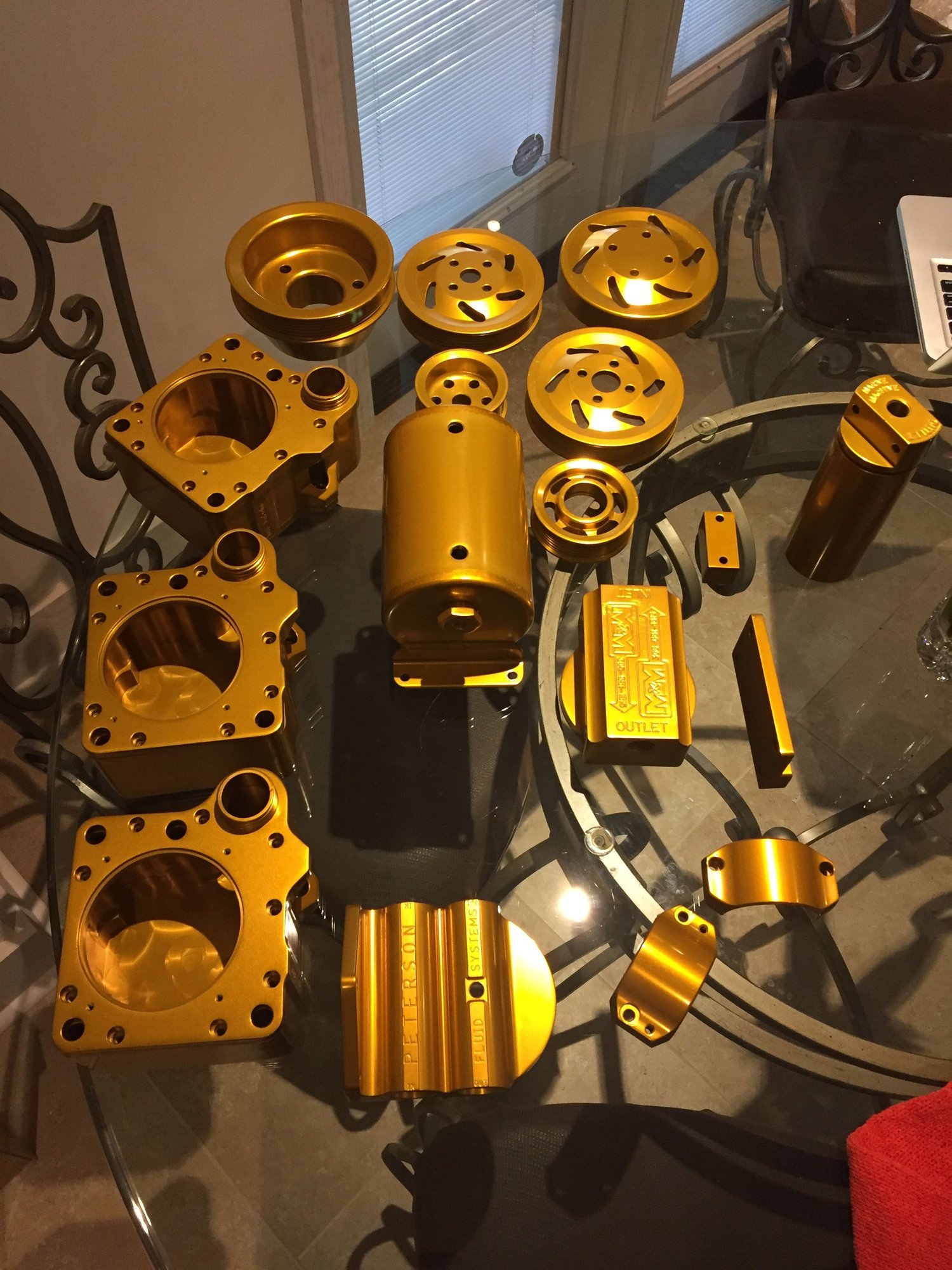

Save yourself the headaches and keep the SM . You really won't see any gain in speed to justify . I assume you have a platform on the back as to why they are fabed like that. The cost of tubes you should be able to bling out the bilge . Wait until holidays and Teauge has great sale on the pieces they manufacture, Scored my 3 trim tanks last year and 25% off went along way to buy other pieces.
