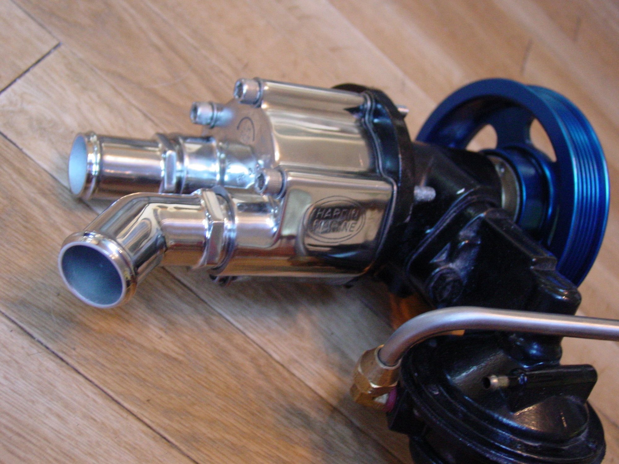

I ordered the Hardin gen 4 and it really wasn't much more than I'd I bought the Merc. I didn't want to pay fifty bucks for the fittings and I'm a machinist so I bought a 4in stainless nipple for six bucks and cut it in half. I'll turn some barbs / grooves on them but it won't be much. I also bought a merc bracket but it's really close to my fuel pump so I bought a new pump that I can clock out of the way for forty bucks. I also didn't want to pay what they wanted for their pulley so I'm using an arbor and pulley for a regular Chevy waterpump.
I sure am glad I went with the Hardin pump, it looks fantastic and I'm glad to hear you guys are getting multiple years out of them. I'll check mine after this season and see how it looks, probably run it two years.

When pressing the arbor on you will need to have the pump apart so the back end of the shaft is not able to push in and damage the bearing. I know some OSO members have had this issue bite them in the past. You made a great choice with that pump. Happy boating.
