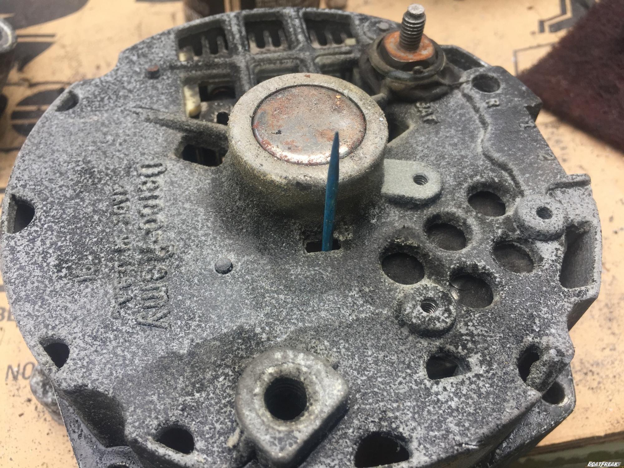

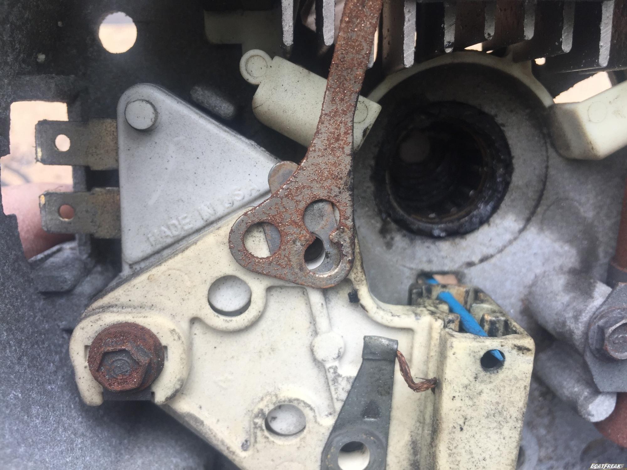

Originally Posted by resurrected (Post 4746861)
With the blue paint down the shaft, looks like an alternator bolt to me, that holds the two halves together
Maybe.
Not the type ) a 1994 ABC Merc but not HP500 I pulled apart this week-end though to redo the brushes.
https://cimg9.ibsrv.net/gimg/www.off...9b42cf3206.jpg
https://cimg2.ibsrv.net/gimg/www.off...363307ff6a.jpg

resurrected 07-07-2020 06:24 AM
After seeing that alternator, I'm so glad I play in fresh water. That looks like it was used on salty roads in the winter
SB 07-07-2020 07:21 AM
So, who has the closest guess ? I would guess the combo hex head with phillips would help alot, lol.
Lake Winni, NH for 26 yrs. 4 months in west coast Fl about 22-23 yrs ago.On lift. No other corrosion anywhere, even outdrive. Unprotected aluminum gets chalky for sure.

resurrected 07-07-2020 08:38 AM
Out in the middle of the lake with dead batteries because his alternator fell apart!
F-2 Speedy 07-07-2020 08:58 AM
Agree ^^^ Im pretty sure its a 1/4 20 alternator housing bolt about 3 - 3.5 inch long
Cool, so this is final ?
I measured his bolt with my note paer. See above some posts.
So, must be screw/bolt for ground wire since the philips option I’m guessing ? And probably why removed (and dropped by mistake into bilge ? Some changed out sltetnator at some point and new alternators obviously cone with new housing screws.
You guys are good.
Case closed ?
Resurected was first to guess right while in line for cookies:
