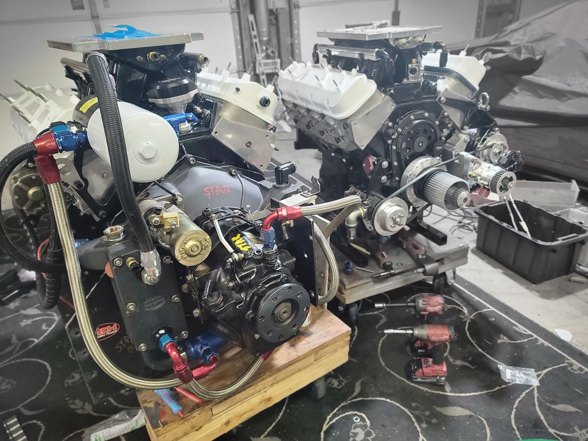

ICDEDPPL 01-03-2024 09:47 AM
Not sure if that`s what youre asking but I run 2 coolers in series for oil.
Bellhousing cooler then to tube cooler.
I could have gone with a smaller cooler, the temps stay around 130ish cruising and 160ish at wot
