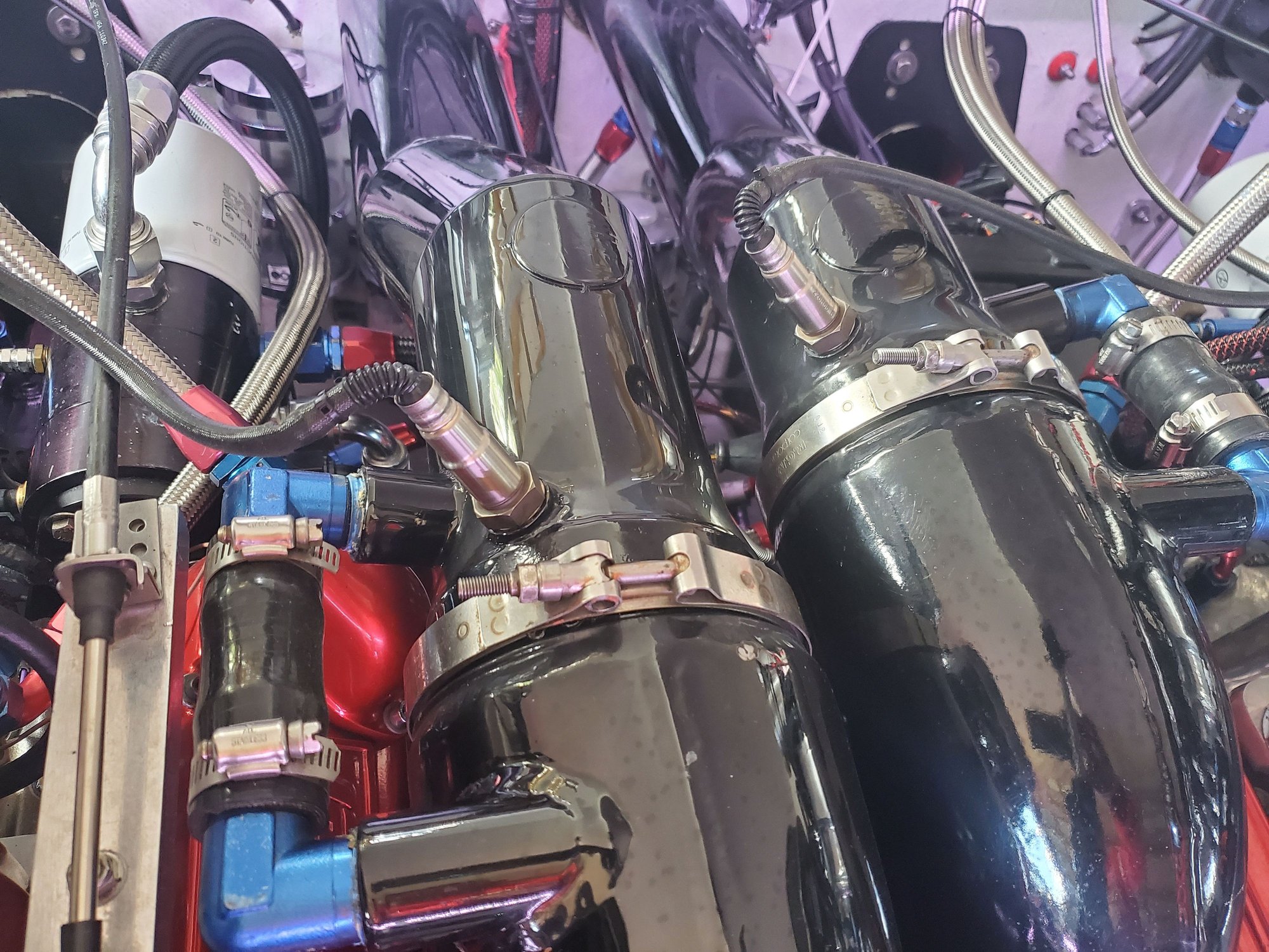

after the collector ... and at an angle is ideal.
ICDEDPPL is offline

So yours is in the tail piece, not the header if I'm looking at that picture right.....
seafordguy is offline
Old 12-06-2020 | 04:29 PM
Joined: Jun 2009
Posts: 9,989
Likes: 6,484
From: Chicago
Right .. after all the gasses come together .After the collector .
ICDEDPPL is offline

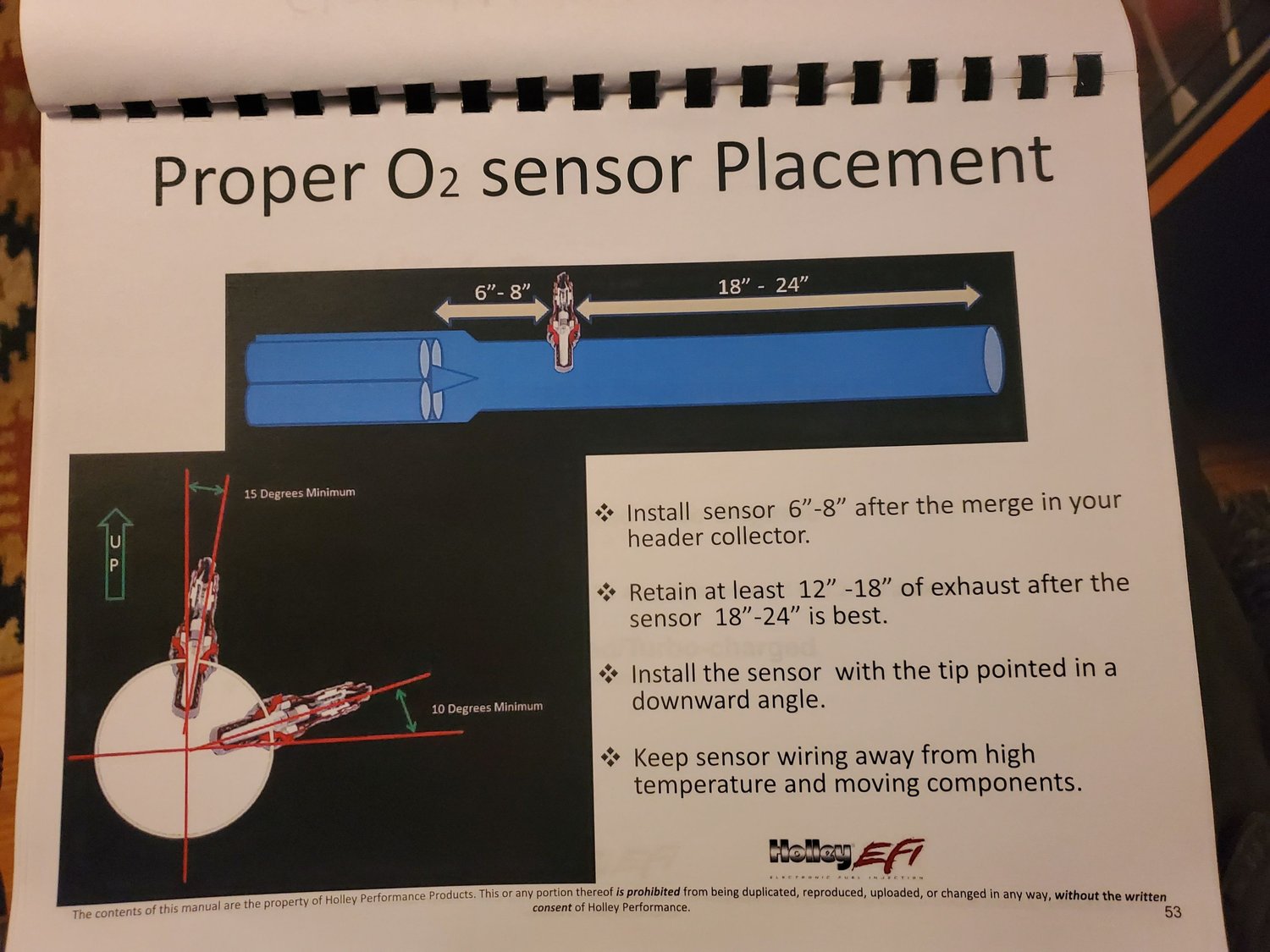

Does the Holley Sniper require O2 bungs on both cylinder Banks?
No, the sniper is only a 1-O2 system. Usually on the odd bank side BBC.
Rookie is offline
Old 12-07-2020 | 06:27 PM
seafordguy's Avatar
Joined: Jun 2006
Posts: 5,123
Likes: 967
From: Seaford, VA
That's the way I read it in their literature, but was just checking.......
Thanks Rookie.
