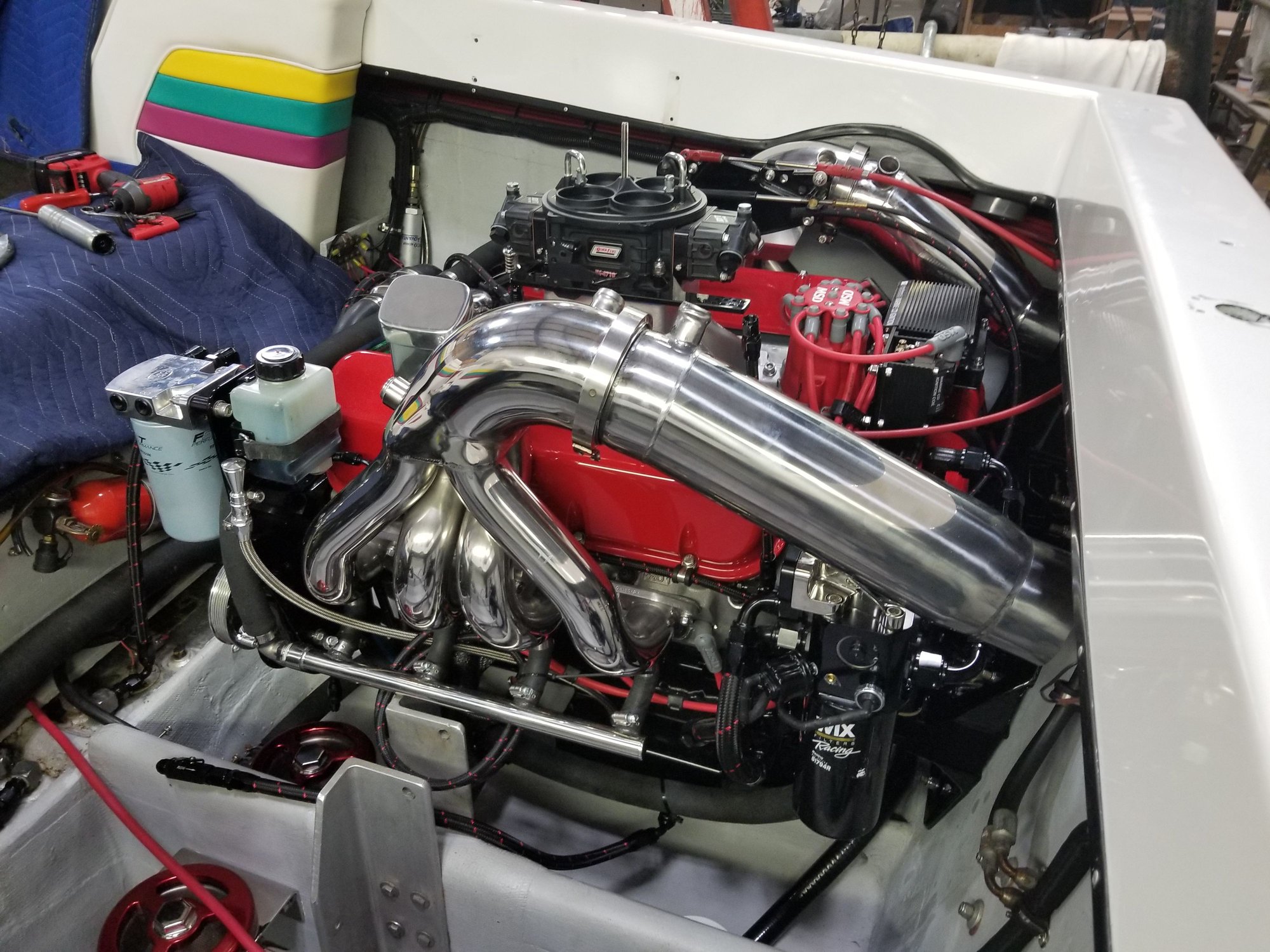

Where have you guys mounted the ignition coil? I've ordered the CPPerfornance mount for the back of the Stbd head but was looking for some pictures of where you have mounted the coil.
I have the mount across the back of the engine that has the main wiring harness, start solenoid and breaker. Don't want to relocate that. I have some thoughts but wondered what you guys have done....
So I bought this one from CP, but looking at yours I think I'll just have a small piece fabbed to go up and over the box and the coil can sit up top on a "shelf"
https://www.cpperformance.com/p-1327...g-bracket.aspx
i made mine. just gave the drawing to a metal shop with a plasma cutter. think they were about $20 a piece done in stainless. bolts to the bellhousing upper row of threads.

I mounted my box on the transom to reduce vibration and heat and the coil on a plate on the back of the starboard cylinder head. Both are on isolators.
