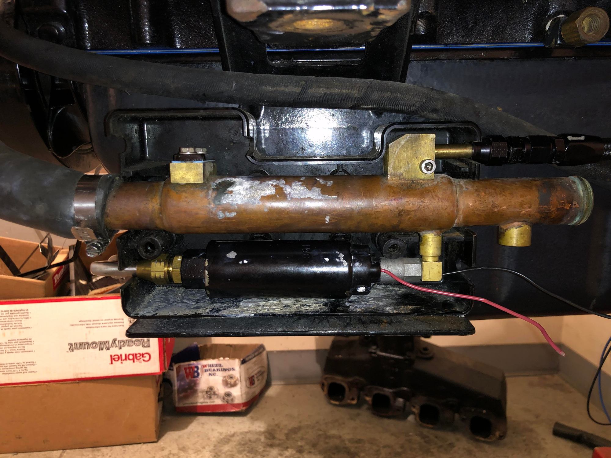

We looked at the MPI set-up tonight and after doing the math as well as trying to figure out other options for fuel cooling and such, it was decided that the Holley pumps with bypass regulators dumping back to the tanks are the best option.
I will use the brackets that the cool fuel assembly used to mount the pumps since they put the pumps in a really good position for packaging. The inlet/outlet of the pumps will end up being roughly five inches below crankshaft centerline and about foot or so below the filter head. This position worked with no issues supplying fuel to the MPi set-up so feeding the carb should be no problem. And the bypass regulator should keep vapor lock and pump failure in check. It will also allow me to package everything at the engine so wiring and all should be easy.
The only rub will be pump servicing (odd bank header removal required), but I had that issue already. The Holley pump will be less complicated so easier to remove if I have to so that’s a plus.
Thanks for all the feedback and guidance! Much appreciated.
