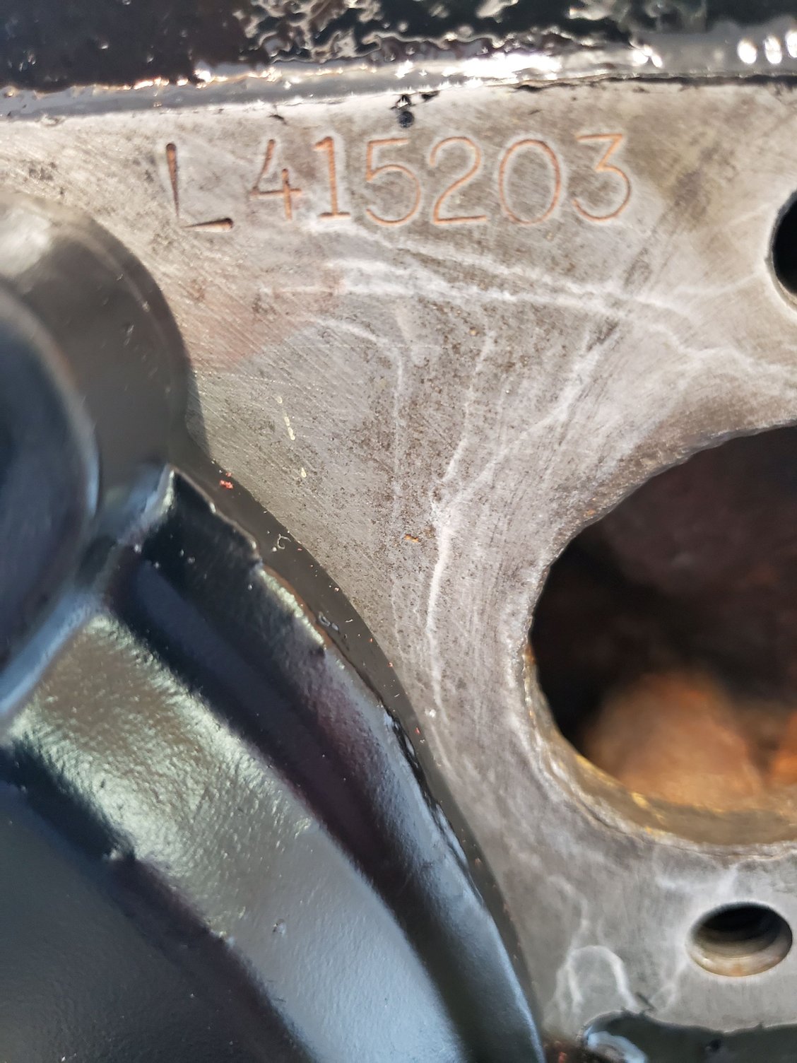

F-2 Speedy 04-04-2021 09:09 AM
The serial # should tell you what they started life as.
https://cimg9.ibsrv.net/gimg/www.off...832a0cb3f6.jpg
MDG_Jason 04-04-2021 11:44 AM
First generation 500efis had GM dimple rods. Later generation had Manley rods.
Unlimited jd 04-04-2021 01:12 PM
A 502 mag short block and early generation 500 efi have the same internals. Pistons, rings, crank, rods, block, hardware etc. only difference was who assembled it. Then the heads cam lifters etc all too end is different.
articfriends 04-06-2021 06:00 PM
Theres different variations of 500 efis, I have rebuilt "early ones", they used the same 1053 steel crank, rods, pistons, rings, windage tray, oil pan, harmonic balancer, timing chain, gen 6 block etc. The heads had 1 piece manley inconel valves vs two piece a 502 mag uses, 7/16 studs vs the non adjustable smaller threads a mag used, crane gold rockers vs stamped steel, a 731 crane cam vs a low performance cam. later ones used better rods that were full floating
