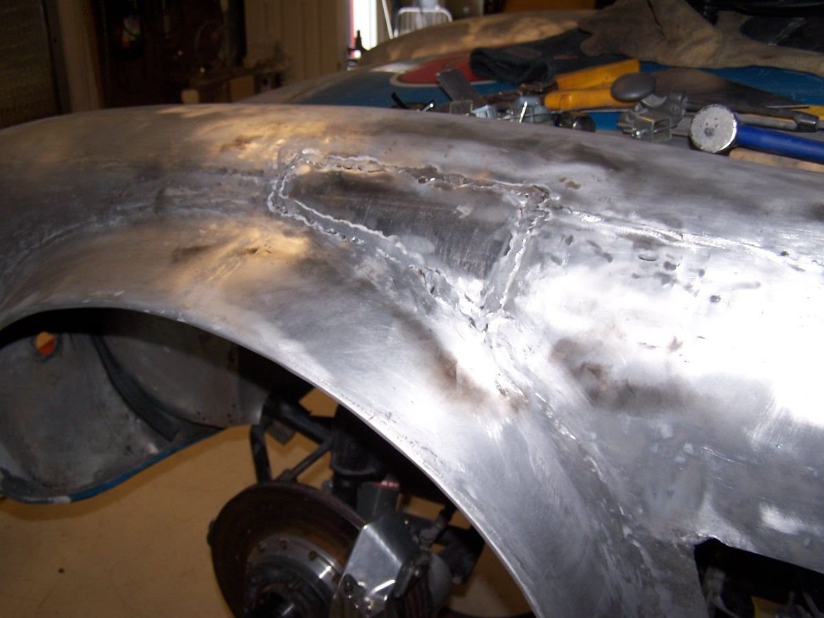

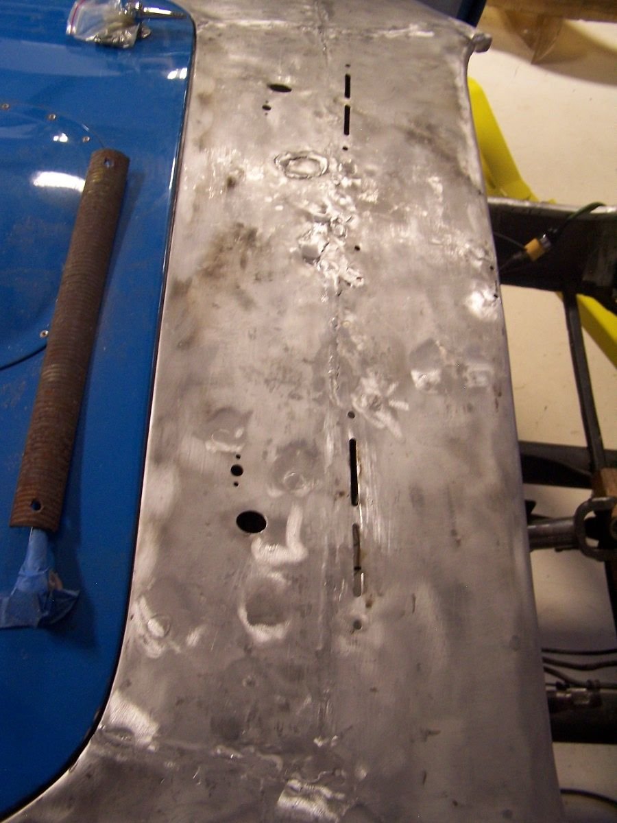

compedgemarine 05-12-2021 05:01 PM
just an update, thanks for all the tips, made some changes and seems to be going good other than the paper thin spots that show up. annealed the worst areas and they are smoothing out much better so it was work harden pretty bad in the areas that have been hammered on from all the wrecks. seems to be no end to the holes and cracks in the worst areas but gaining on it. the real fun was that when the FIA flares were added back in the 80's they put the right rear on one inch forward of the left rear so I cut the entire flare off and moved it back to where it is supposed to be. she's only worth a couple million be hey it's not mine so full steam ahead.
thanks again for all the tips.
compedgemarine 05-16-2021 08:31 PM
here are a couple pics of the repairs as they are progressing
