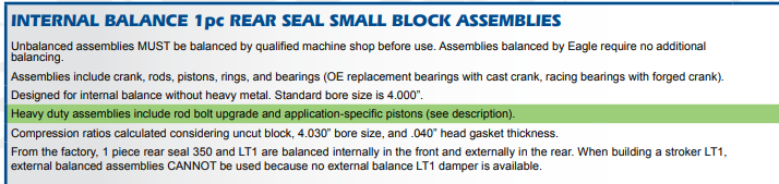

FWIW, I've ran across this bottom note in the Eagle crank catalog recently.
Other than that I have no experience to shed on your situation.

TomZ 06-29-2021 11:05 PM
https://cimg1.ibsrv.net/gimg/www.off...69c5ae9e95.png
Bingo.
Insane87 06-30-2021 06:29 AM
Hi
I took my flywheel off last night.
It does look like external balance.
https://ibb.co/N9t5fpM
Last night I also ordered the external balanced 153t flywheel which TomZ suggested. Part number 14088650.
mit does say that it is for 5.0l and 5.7l so it should work from a balancing perspective I believe.
A mini starter motor I ordered as well, so that should work too.
Internal balancing is not an option yet due to the complexity of the internal balancing procedure.
I hope it does work with the external balanced 153t flywheel.
