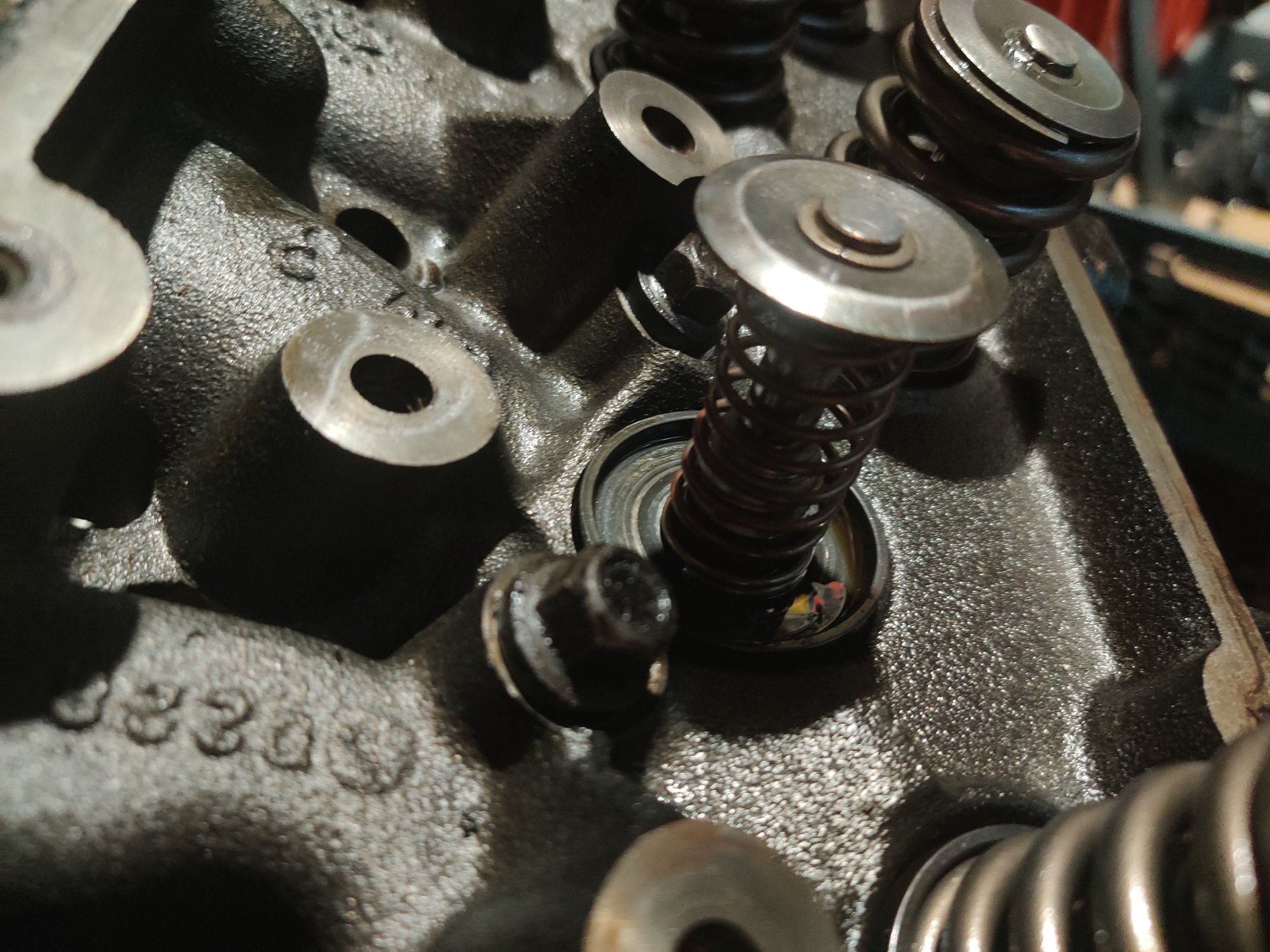

TomZ 08-09-2021 02:54 PM
The valves hit and the lifters really don’t give when it’s running. The one that gave up was probably the closest (hardest hit) due to variances in deck height, but they all made contact and should all be considered a liability. If the valves seal, you’re going to get some RPM out of it and that will increase the chances for failure and even more damage.
Have you seen an engine come apart at speed from dropping a valve head? The damage is usually catastrophic (you got lucky on this).
Personally, I wouldn’t take a chance with it. A couple hundred bucks for valves isn’t a lot of money when compared to replacing pistons and rods, cranks, blocks, heads, etc.

I’d also look for bent push rods too.

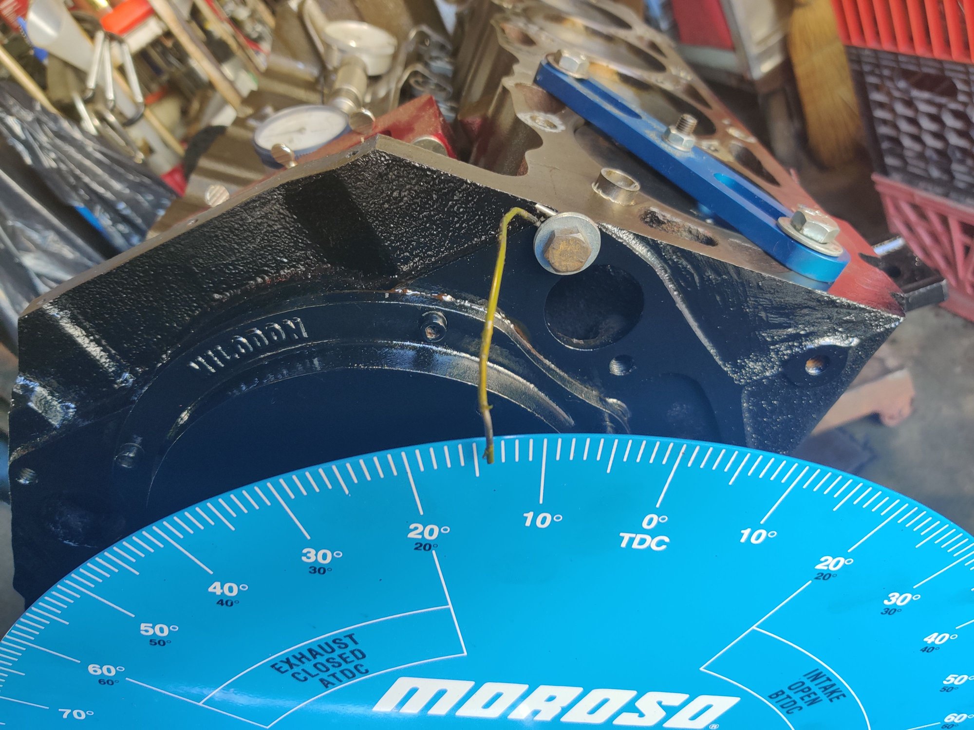

While I was just degreeing the cam I was thinking about the valves. You guys are obviously right about the lifters not having any give. Hydrolocking was a good analogy. I have ones that I already prepped from the original set of heads which are the same size. I'll put the ones that are in the heads now on the valve grinding machine and that will tell the real story. In the mean time I won't have to worry about it. Push rods are an easy check before I install them. I would have done that either way.
Cam degree #s:
Exhaust Opens 47.5*
Intake Opens 3*
Exhaust lift .4828"
Intake lift .483"
​​​​​​Exhaust closes 2*
Intake closes 49*
​​​Exhaust duration 47.5+2+180=229.5*
Intake duration 3+49+180=232*
Exhaust c/l (161+65.5)/2=113.25*
Intake c/l (69+165)/2=117*
(113.25+117)/2=115.125* lsa
TomZ 08-09-2021 06:05 PM
Not sure it’s just the picture, but what I can see of the bore of number 8 doesn’t look happy either.
Sorry if it seems like we’re nitpicking. Just trying to get you set in the right direction.
SB 08-09-2021 06:10 PM
That cam is in 2* degrees retarded.
Neutral woukd be 115 icl and 115 ecl
4* advanced woukd be 111icl and 119ecl

Hmmm... Possible it's just another grind? There's no question about it being in right this time. I know, famous last words. I have pics lol Let's say it is 2* retarded. How do you think that would affect performance? In theory I'd just have slightly more top end and a little less in the lower rpms right?
https://cimg9.ibsrv.net/gimg/www.off...fbf797f7d9.jpg
https://cimg3.ibsrv.net/gimg/www.off...5faa4bd07a.jpg
SB 08-09-2021 07:35 PM
You bought a multi keyway timing set and cam degree tools for ?
Merc also install their bbc ‘blue motor’ Crane cams 5* advance.
More midrange, less overap after top dead center, to name a few reasons, I’m sure.

edit: calcs were off. I just realized I didn't subtract for ATDC.
I advanced my cam this morning. Here is what I came up with moving the crank sprocket 2 degrees advanced.
Looks like all is right with the cam world now.
Duration @ .050" (2* crank advance)
Exhaust 49-5+180=224*
Int -2+47+180=225*
Valve opens
Exh 49*
Int -2*
Valve Closing @ .050"
Exh -5*
Int 47*
Valve lift
Exh (.284")
Int (.284")
Max Lift. 482.8
CL
exh (167+63)/2=115
int (63+167)/2=115
LSA 115*
https://cimg3.ibsrv.net/gimg/www.off...3862676e6e.jpg

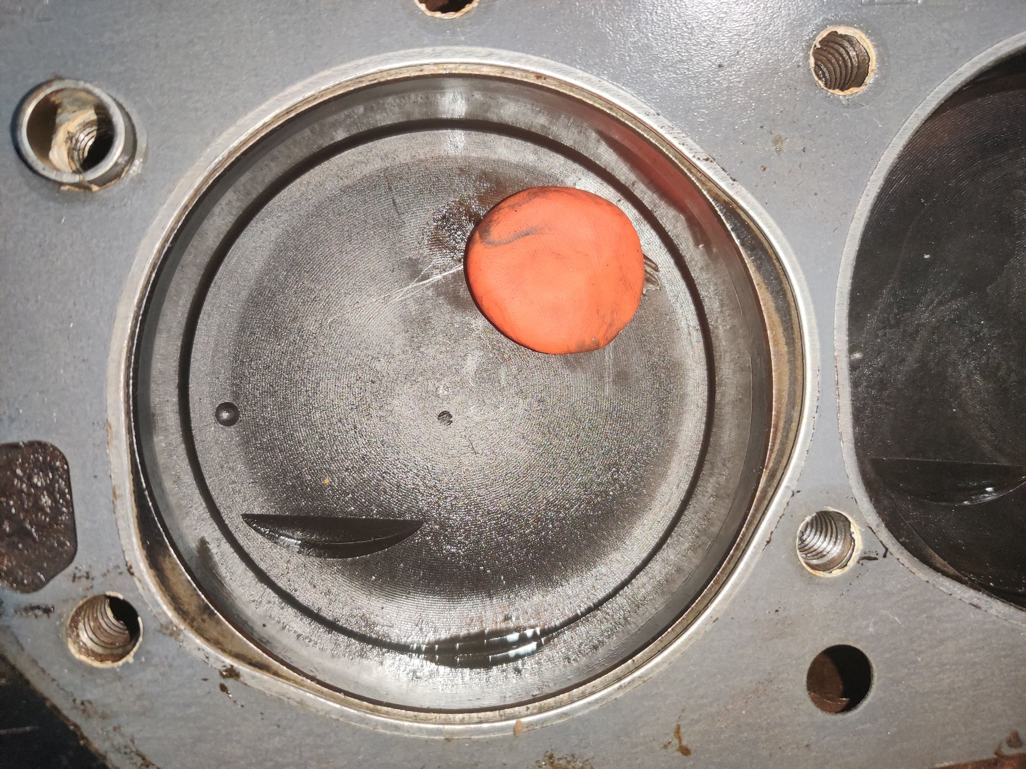

I checked the real ptv clearance and squish tonight. I threw a light spring on the intake and a once torqued down head gasket that's the same as the ones I'm running. .102" int PTV and .066" squish.
https://cimg5.ibsrv.net/gimg/www.off...a1a9a5bded.jpg
https://cimg2.ibsrv.net/gimg/www.off...2bbb8b9d30.jpg
https://cimg5.ibsrv.net/gimg/www.off...fb6a44b5db.jpg
why is the head gasket out of round?
HawkX66 09-17-2021 05:47 AM
It's just the way they're manufactured. Good question though. I'm not sure why they do it.
sutphen 30 09-17-2021 05:47 AM
^^^^^^ thats how they are,its the hiperf. set up for when you bore notch the block.it allows the valves to be unshrouded and flow more air and exhaust.
