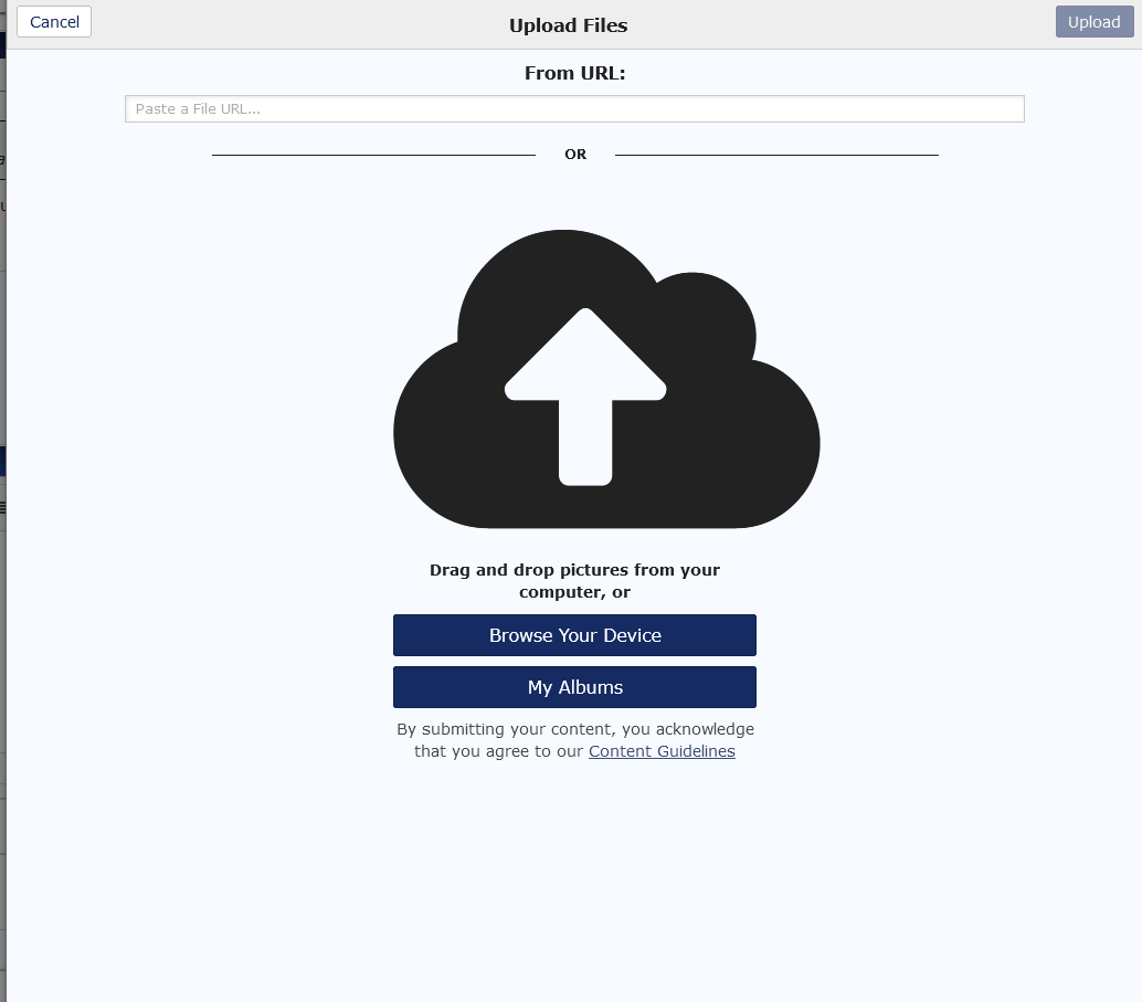

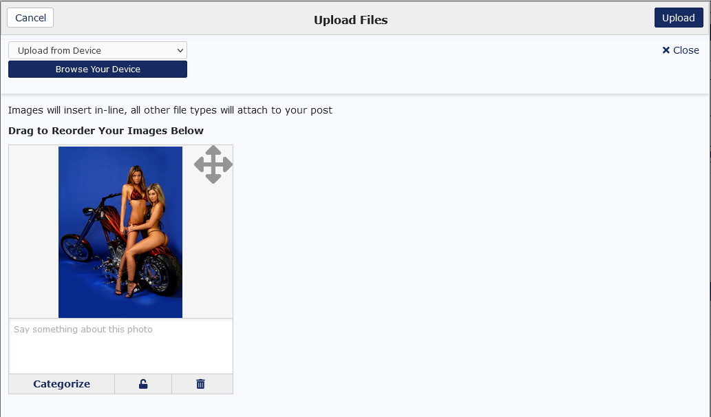

OP excuse the slight hijack.
1) Hit the "double mountain" box next to the smiley. 2) The upload screen appears. 3) Browse your device for an image or insert a URL where the file is hosted. In this sample it's from my device. 4) Hit the upload tab.
Screen grabs of the process in order below.

BillK 07-16-2021 03:02 PM
Dummy me :) I have been looking at the bottom where it says "you may not post attachments" Thank you !!!!!!!
