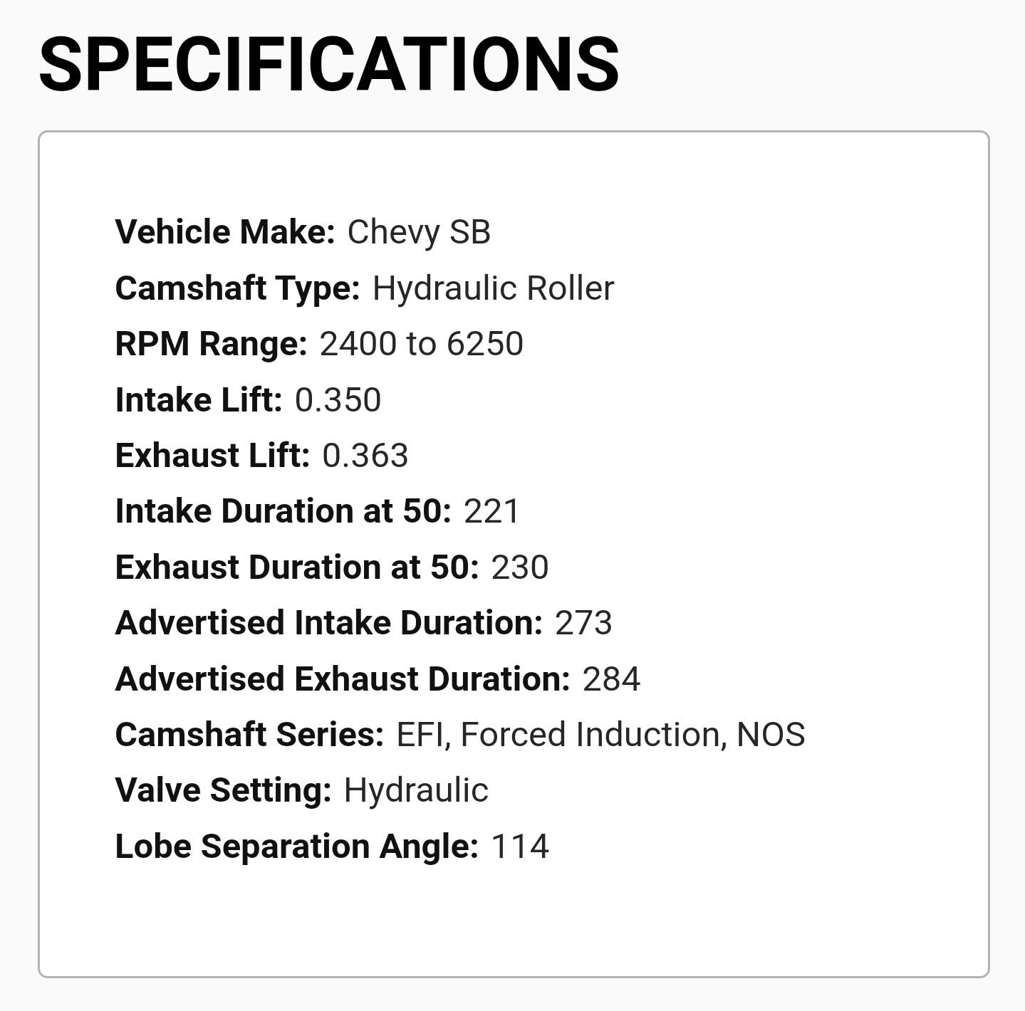

I'm looking at getting a crower cam similar to the cam in the 377 scorpion for my current mpi build. I currently have IMCO powerflow exhaust with 12 inch risers. Would I be looking at reversion issues?

I run this exact cam on a 377 stroker (standard bore ) with GLM exhaust, stock Merc elbows and 4" through hull. I have a wide band sensor running full time and have been doing so for the last 11-12 years. Reversion is not an issue with my setup.

Good to hear! Man i Would love to hear what it sounds like! How do you like the power? Are you injected or carb?
SB 09-01-2022 05:00 PM
Will sound mild, with that duration and 114lsa. Pretty much just Like a 365hp 454.
Franks292 09-01-2022 07:08 PM
would more duration than this be safe with a 114 LSA and wet exhaust?
