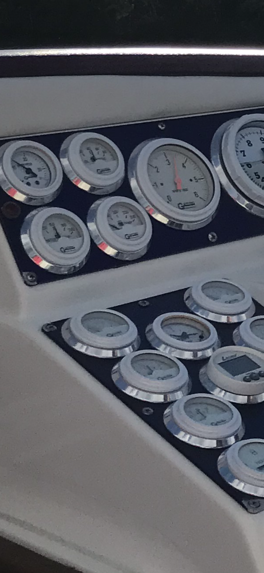

Here is a snap of our 500efi gauges for reference…
https://cimg5.ibsrv.net/gimg/www.off...8ad1fe1217.png
https://cimg6.ibsrv.net/gimg/www.off...3104cf5eac.png
