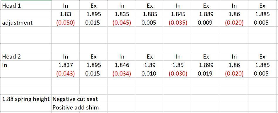

Right. It's an L29 including the heads which are 297s. When I had the engine machined, I also had the machinist check the springs. They're the ones that came with the cam. They spec'd out well.
Here are the numbers:
145# @ 1.88"
360# @ 1.297"
Coil bind 1.130"
When I built the heads, I measured the valves and used shims to get everything in spec. I set them at 1.88". I also removed the rotators and cut them for posilocks at the same time.
