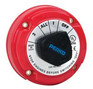

Do you have a battery switch and know how to use it and how it works ?
https://cimg3.ibsrv.net/gimg/www.off...ed264e8ba.jpeg
