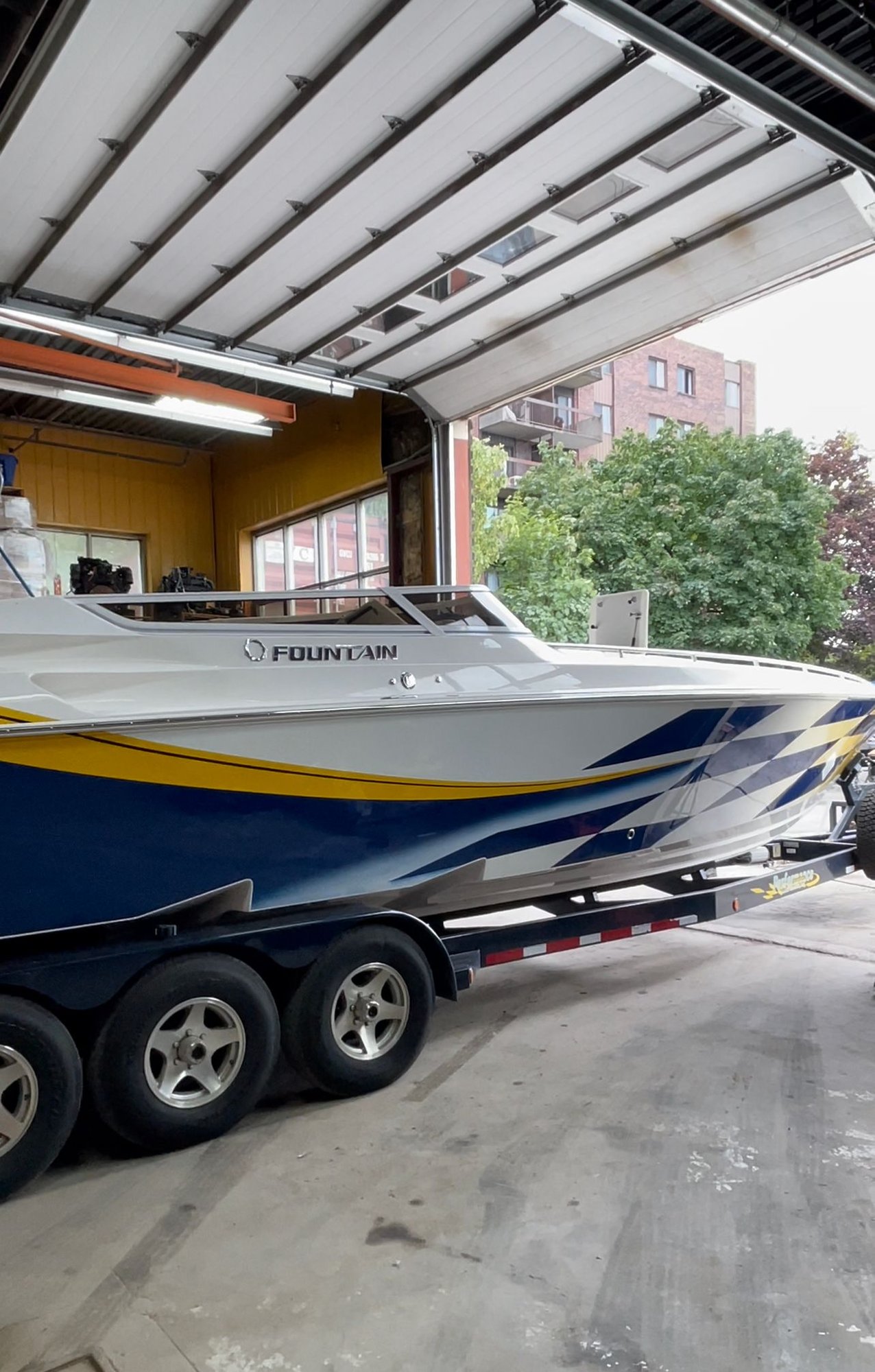

Barryama1124 09-06-2021 09:58 PM
https://cimg4.ibsrv.net/gimg/www.off...c536b73be.jpeg
This puppy is like new 😁 next year hopefully I’ll have time to go glass cockpit and new power plants….woot woot lol
