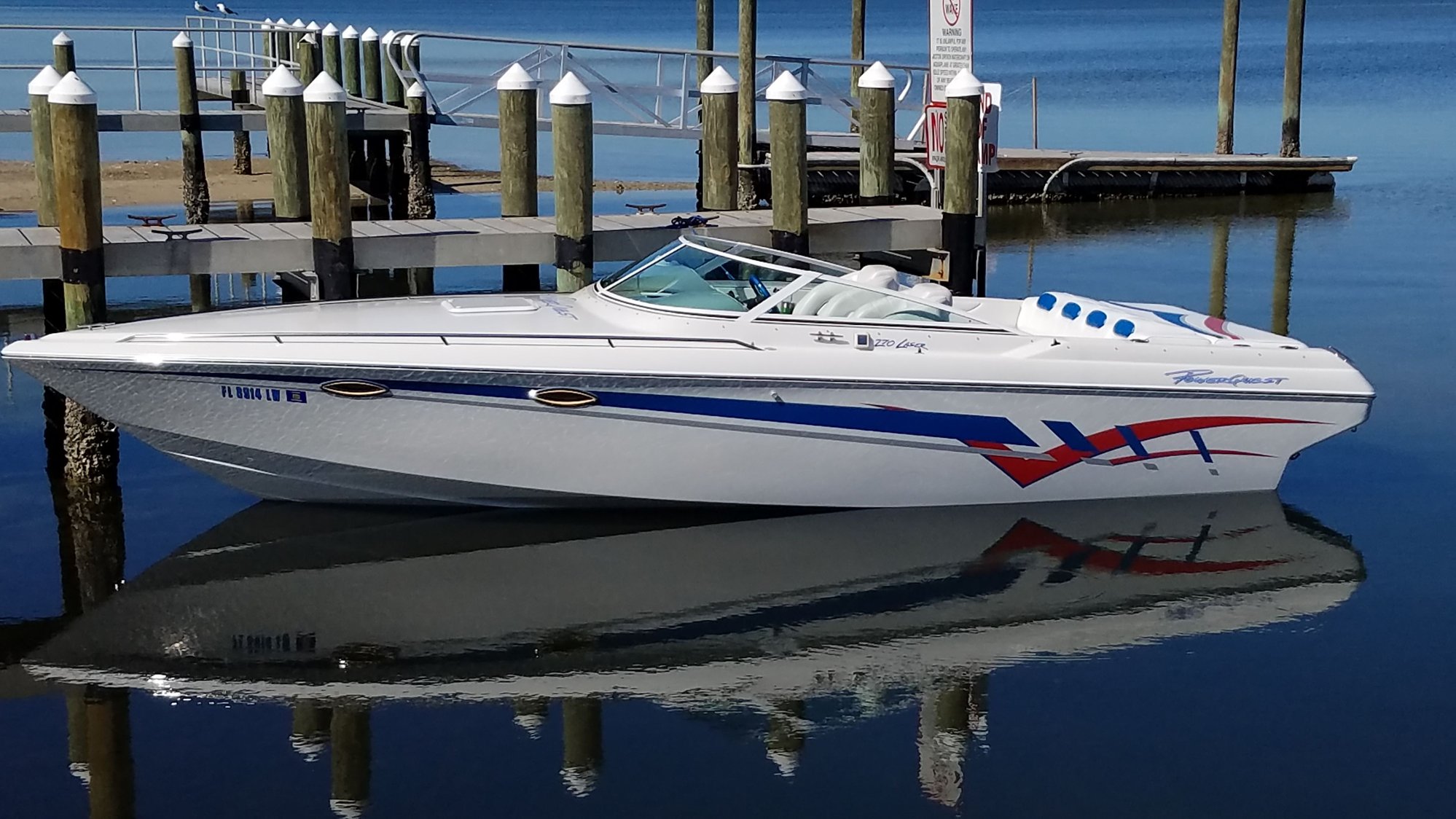

niteridder64 04-01-2022 09:56 PM
Looking for a tuner in Florida
I have a 1996 27 powerquest w/ a built 502. I was running 61 gps before the rust in the head opened up water into the cyl and needed a rebuild. I spent a lot of money and put awesome Merlin heads w/ big intake vlvs, eng bored .060 over, big cam ,cmi headers sniper throttle body inj.etc and only run 62 at 5100 rpms.I expected a 70mph boat. Since I had one guy make the heads, one guy do the machine work, another guy do the build up and I installed the eng and put on the sniper there is not one guy I can take it back to and say WTF it is no faster than my stock eng.
What I am looking for is a shop in Florida, preferably near Tampa that knows how to make these things sing and has a prop dyno or can water test and see if we can find the weak link that is keeping this thing down on power.
niteridder64 04-01-2022 09:57 PM
https://cimg0.ibsrv.net/gimg/www.off...fb44de11bf.jpg

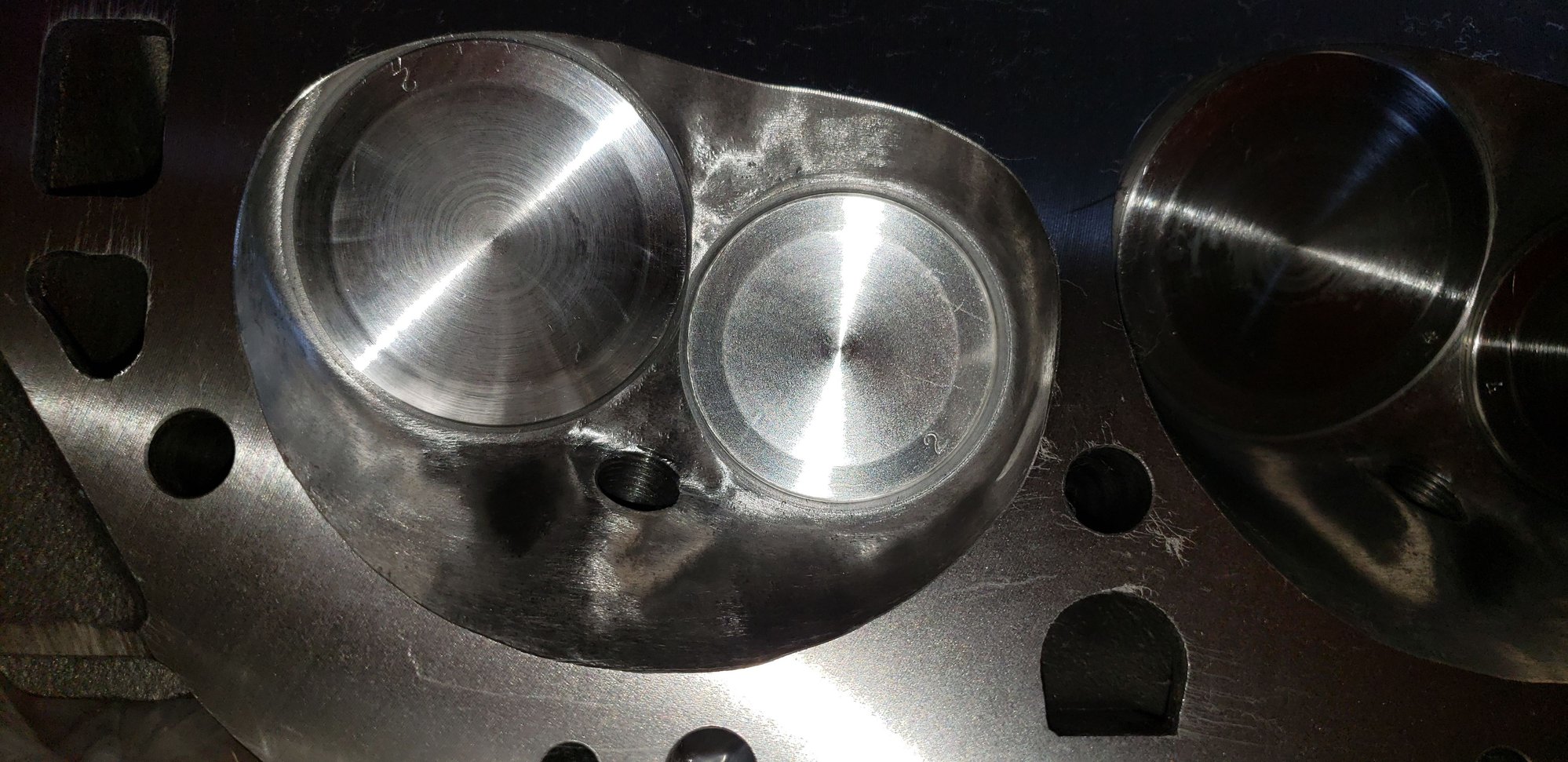

niteridder64 04-01-2022 09:59 PM
https://cimg3.ibsrv.net/gimg/www.off...ea02820d4e.jpg
https://cimg6.ibsrv.net/gimg/www.off...9b9443c2d4.jpg
heads

I think the merlin heads are your problem,,they suck,even if work them over,thin casting around the exhaust port,,work them to much and a few years down the rode,they spring a leak.salt water makes it happen way faster.

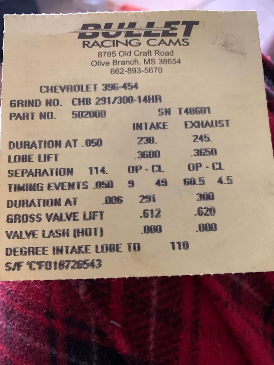

https://cimg8.ibsrv.net/gimg/www.off...34f3938663.jpg
niteridder64 04-02-2022 11:26 AM
SB.
running 12g wire right from bat thru relay to distrib
I purchased the heads new from Ron Sporl Performance, Manley Inconel ex Manley intake, can't remember the size but next bigger than 2.25 runners ported pockets bored out to bring comp down to 9.5 pistons were down .010 in block

sutphen 30 04-02-2022 12:07 PM
cams installed to advanced,should be around 109-110icl

polishing chamber is okay,,really need to see that exhaust port,that will tell if your gonna make some hp,,plus,that cam doesn't have near enough spred,its not a street car,8-10° will be the norm w/ good exhaust ports,,merlin probably needs 12-14°.run it for the season then change some parts.

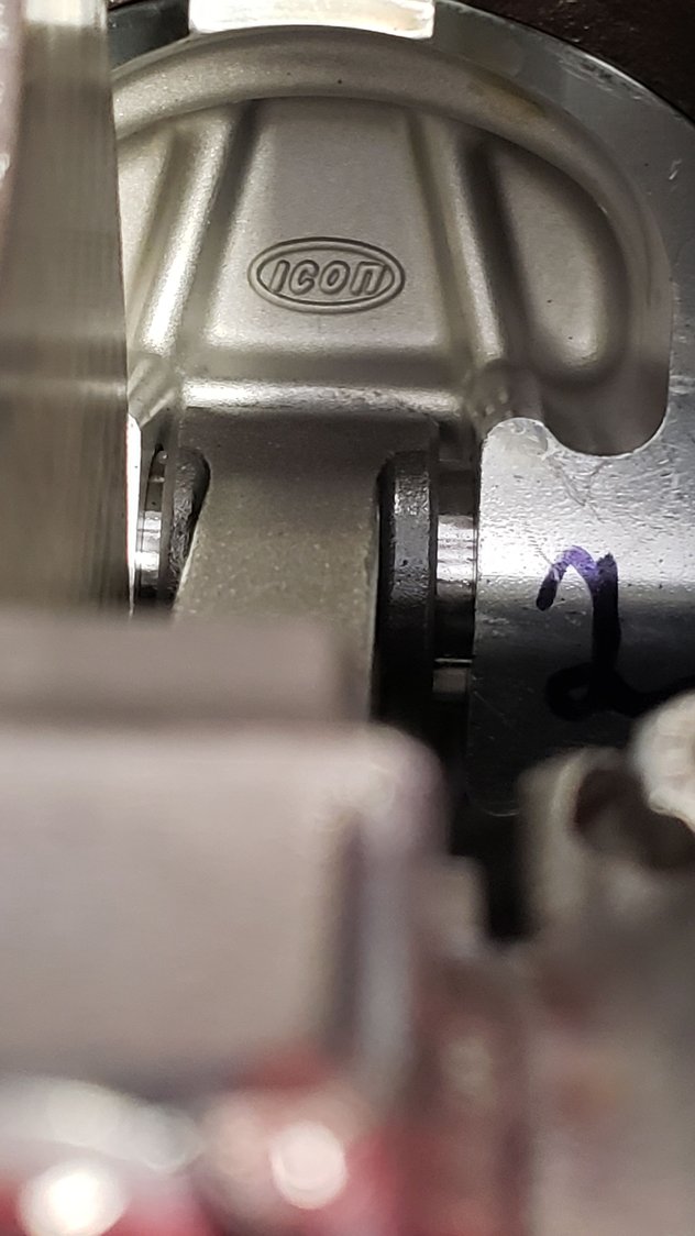

MORE INFO: I am running the stock gm intake manifold dual plane but cut down the center divider about half way. Icon forged pistons, run 93 octane, long rod eng. sniper keeps wot f/a ratio at 11.8 which I can set to whatever I want so that helps against detonation but I do not have knock sensors or electronic timing reduction. I set my timing at 29 to be safe for break in and I just havent had the balls to bump it up to 33/34. I would like to do that w/ an experienced tuner either on water or prop dyno. My overhaul had a lot of Chiefs but no 1 person in charge. I should have just take the boat to a reputable guy and dropped it off and said call me when its perfect. I really did respect what Ron Sporl told me to do regarding the heads and cam selection and timing pos, now weather or not my builder knew what he was doing and actually set it to 104/106 I don't know. I now Stuphen 30 has been on this forum quite a bit and maybe you are right about 109/110. Not sure if this makes sense but I remember Ron saying the pistons I had would give me too much comp so he ground open the pocket and I think he set the cam to lower the running comp to give me about 9.5/1, does that make any sense?
https://cimg1.ibsrv.net/gimg/www.off...ea2d5454ac.jpg
https://cimg1.ibsrv.net/gimg/www.off...24dbd5a731.jpg

my bullet custom grind 238/245 at .050 has a an icl of 110.have done many 454's and 502's at 109-110 and all the motors rip.but if you want the motor to peter out around 5000-5200 all the power to you.merc uses 106 so their motors don't rev up,built in rev limiter.
SB 04-03-2022 10:36 AM
From s30
https://cimg7.ibsrv.net/gimg/www.off...90ab7560b.jpeg
