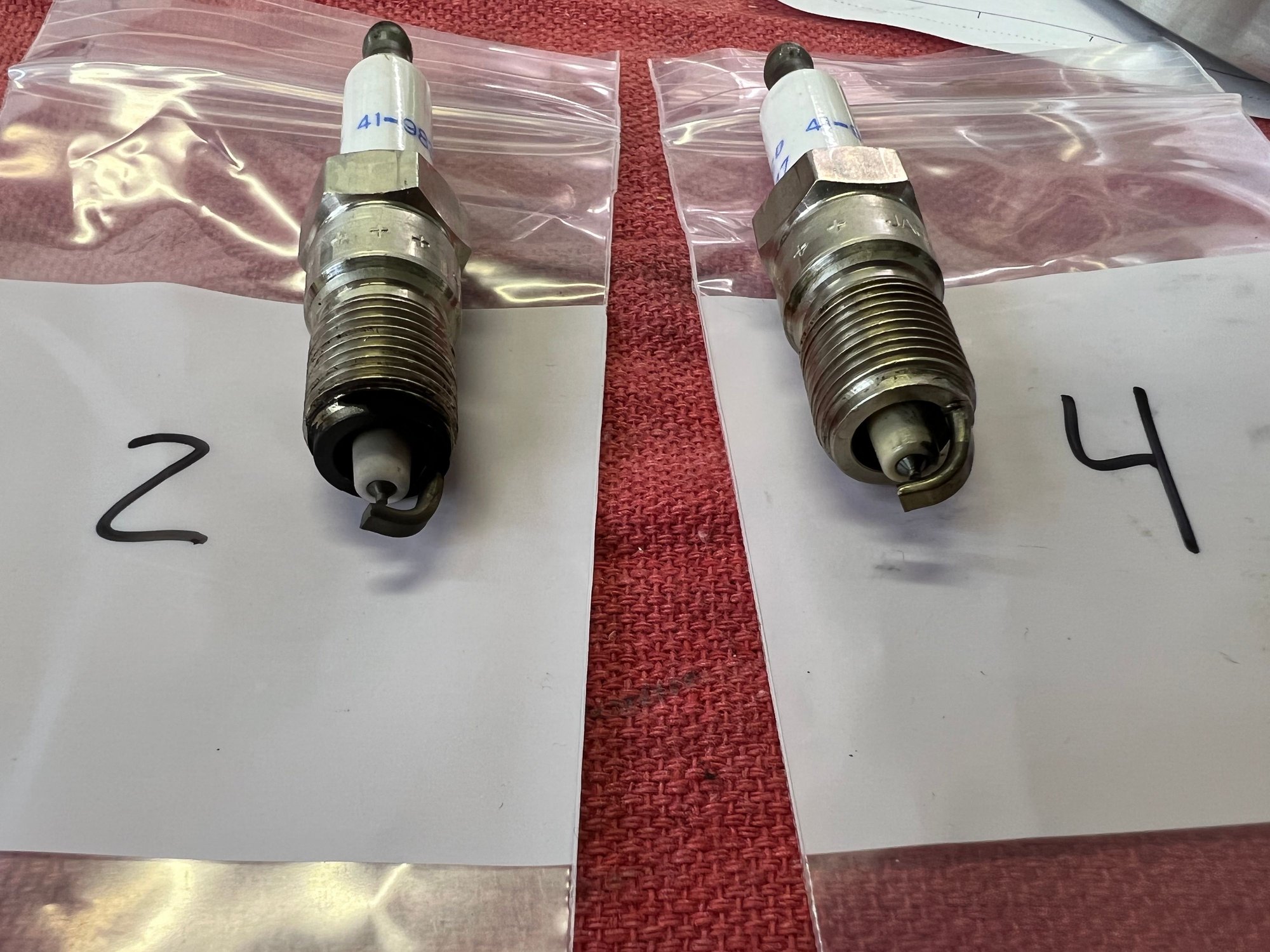

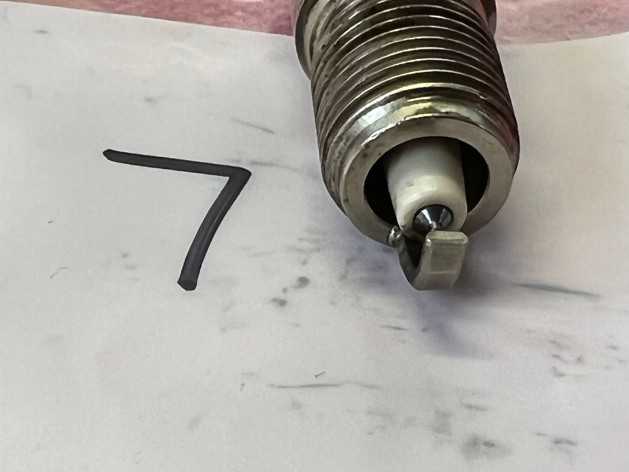

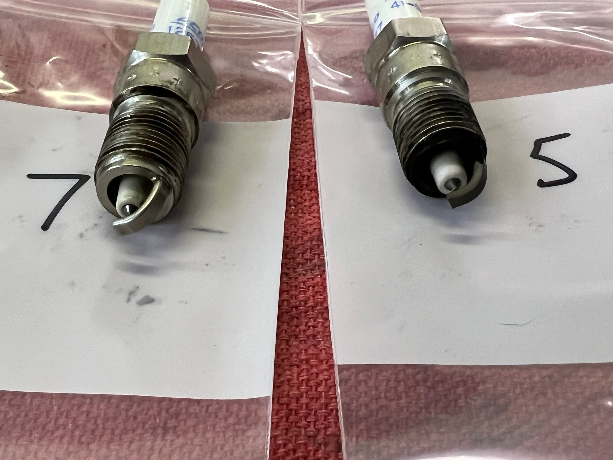

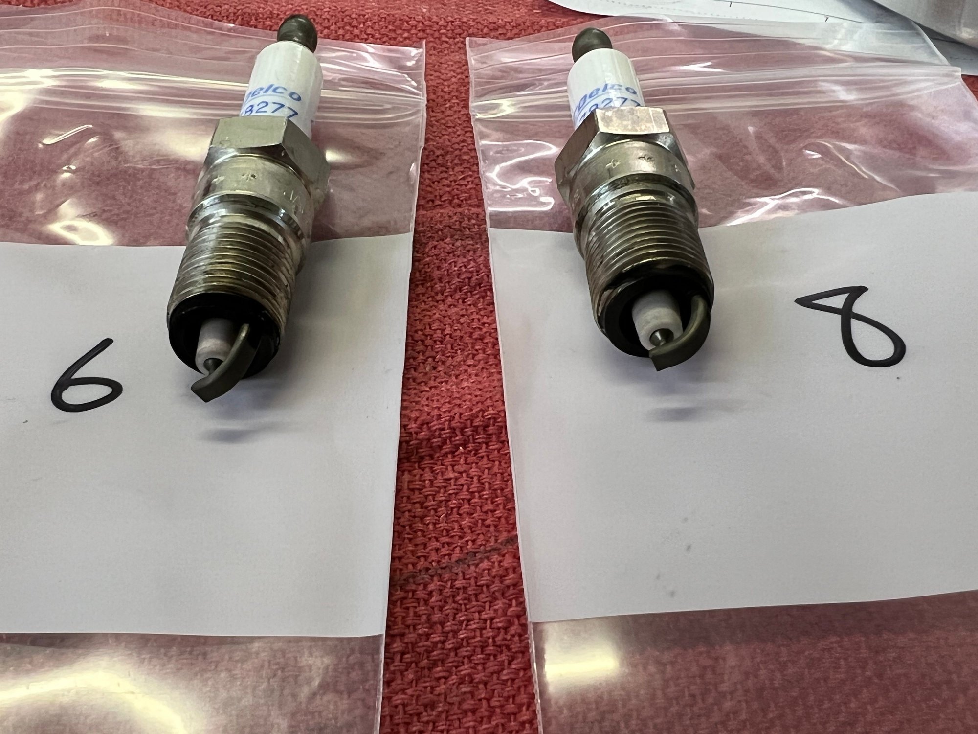

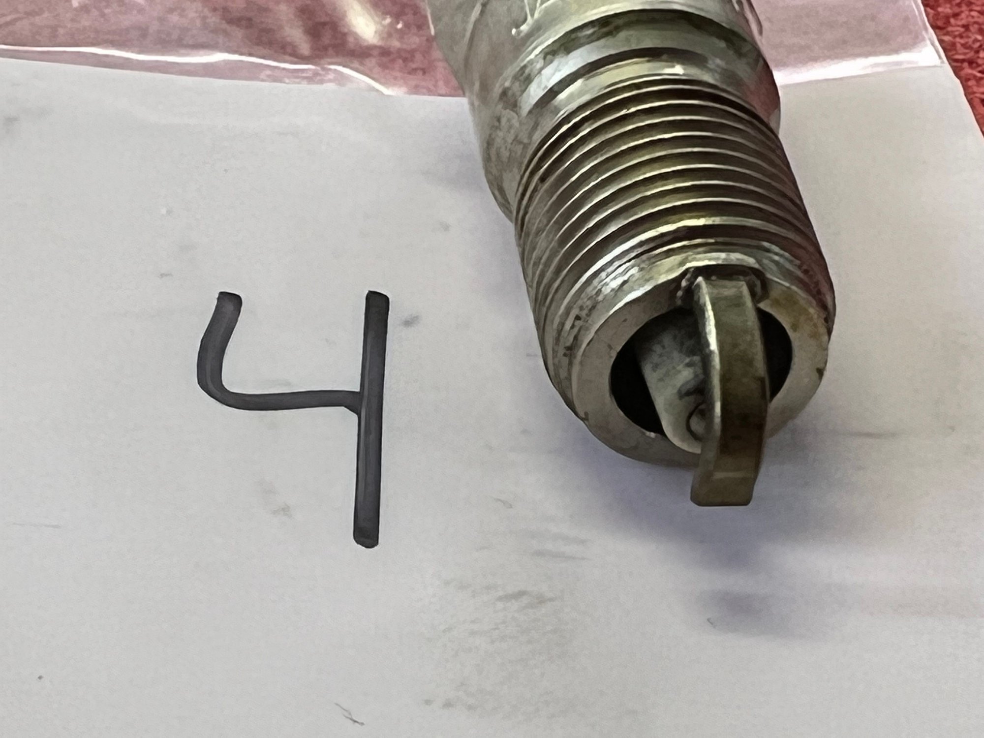

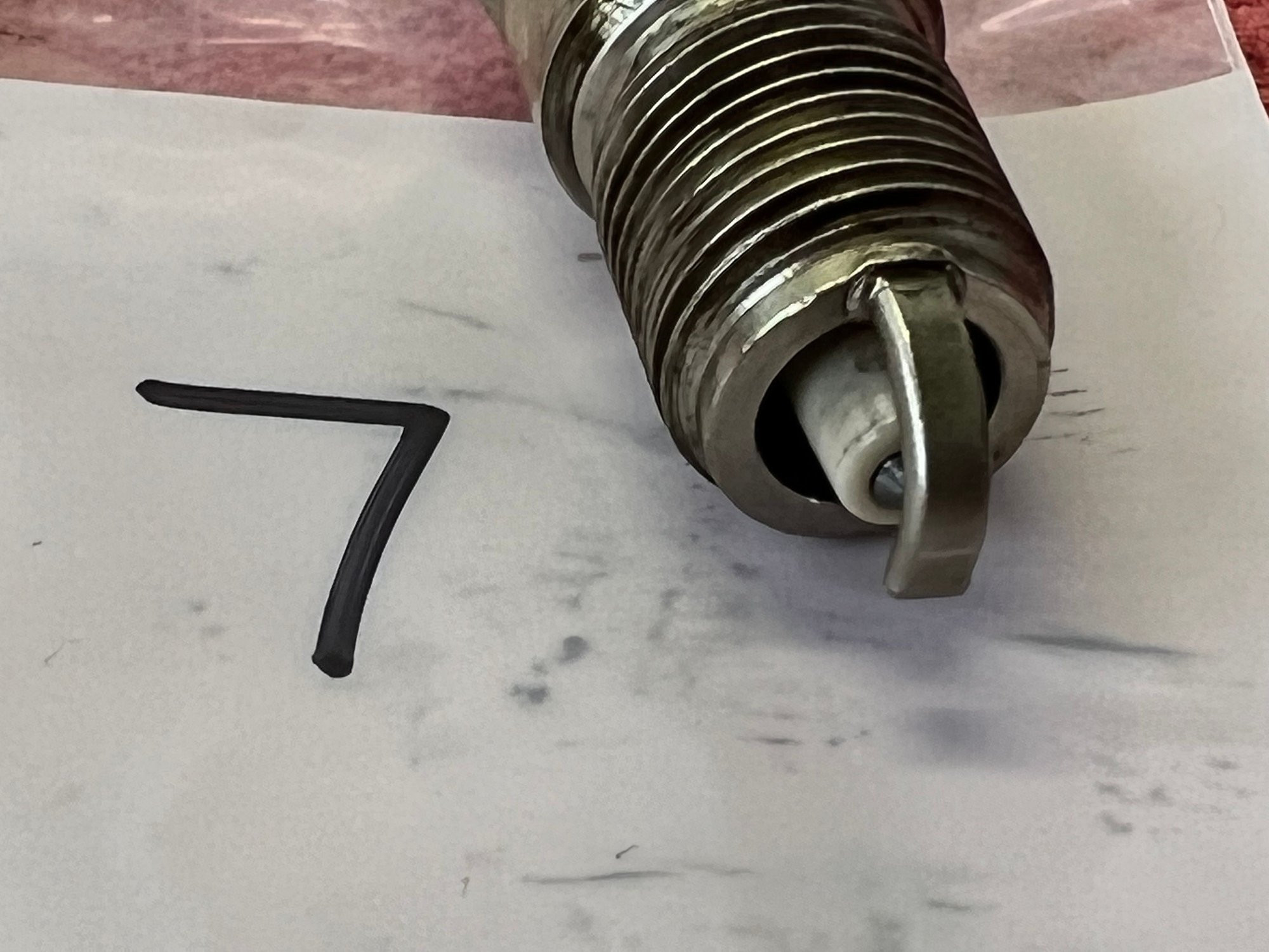

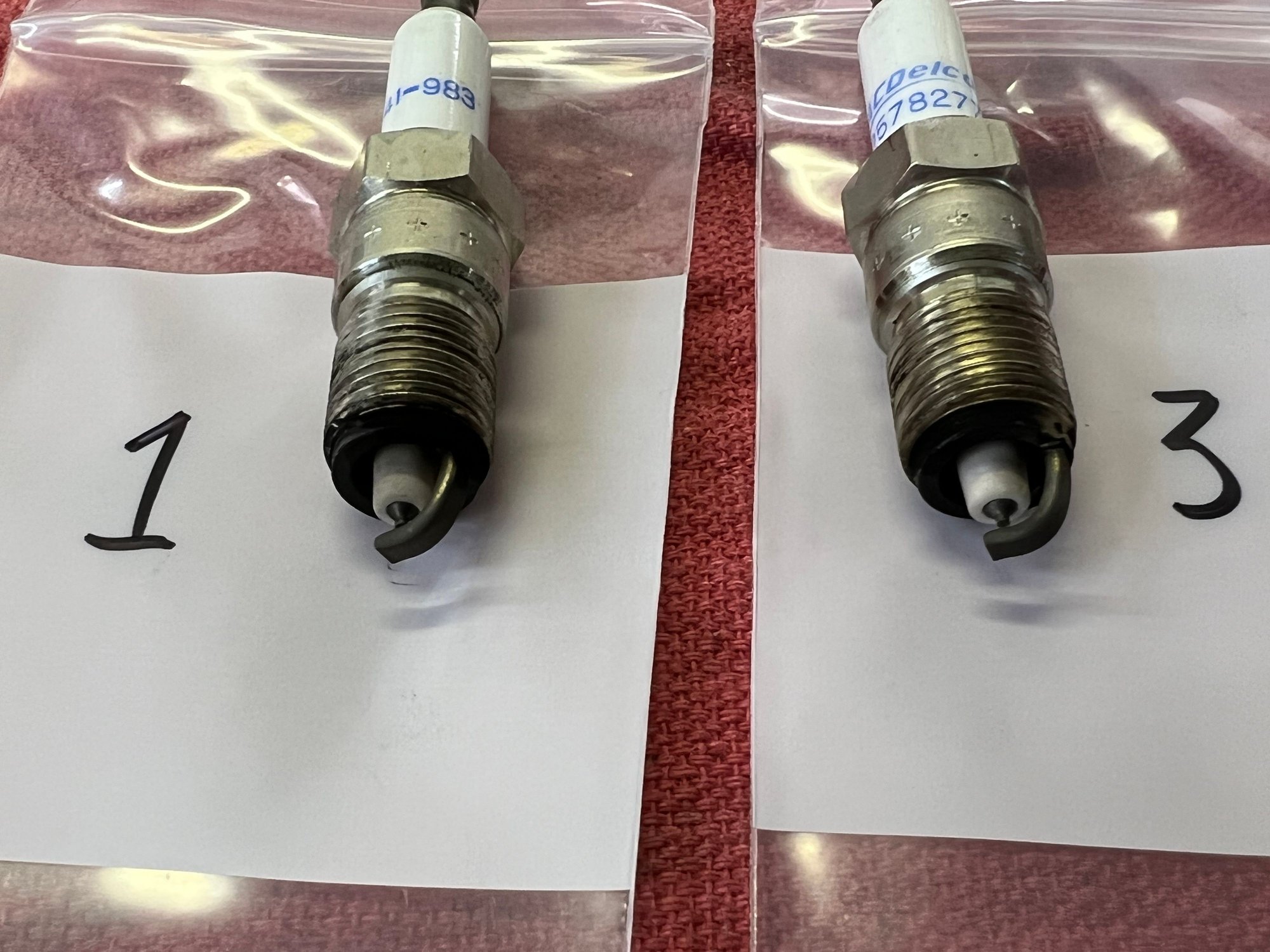

Brad Christy 08-03-2022 05:29 PM
Guys,
Plugs out. Same as last findings. #4 and #7 showing no signs of combustion. Squeaky clean. MAYBE a hint of a smell of gas on these two. Kind of hard to be sure.
I’ve also noticed a consistent appearance of oil around the threads of #7 each time I’ve taken it out. Not a lot. And not inside the cylinder. Outside. Might have a leak. 🤨
https://cimg8.ibsrv.net/gimg/www.off...2876c9baf.jpeg
https://cimg1.ibsrv.net/gimg/www.off...51bf44d9c.jpeg
https://cimg2.ibsrv.net/gimg/www.off...01f69b371.jpeg
https://cimg3.ibsrv.net/gimg/www.off...a7fbb0ce9.jpeg
https://cimg4.ibsrv.net/gimg/www.off...e109bf1b0.jpeg
https://cimg5.ibsrv.net/gimg/www.off...3a322632a.jpeg
https://cimg6.ibsrv.net/gimg/www.off...dd0a90df7.jpeg
https://cimg7.ibsrv.net/gimg/www.off...237c71b62.jpeg
https://cimg1.ibsrv.net/gimg/www.off...1322d18a2.jpeg
https://cimg2.ibsrv.net/gimg/www.off...49ef8aa9e.jpeg

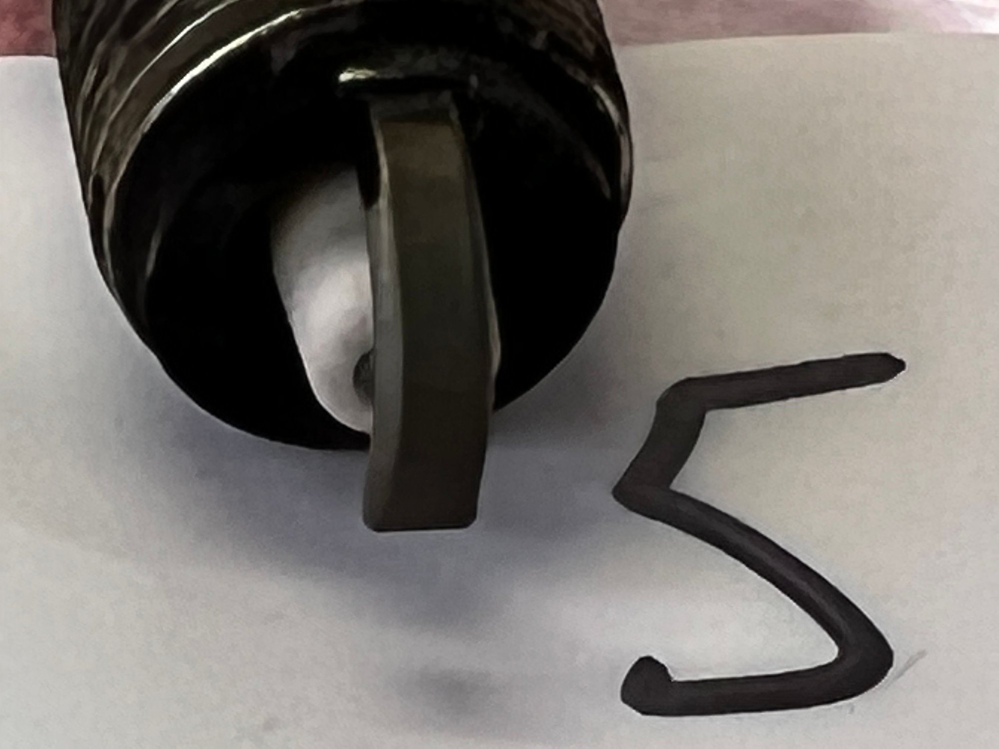

Since #5 was of interest previously, I took some closeups of it, as well. I’m not sure what was going on with it last time, but it looks pretty much identical to the others this time around, excepting #4 and #7, of course.
Thoughts?
Next, I plan on swapping the injectors. Ill swap them the same I did the coil packs; 4-6 and 7-5. I’ll take pictures of them as I do so. I’ll also figure out a way of getting some video of the spark tester in use, under load, on the water.
Repeat…. Anybody have any actual dealings with Kunkel’s?
My hips and shoulders are going to mount a protest before long….. 🙄
Thanks. Brad.
(937)545-8991
SB 08-03-2022 06:23 PM
Water can clean’m too. I see this slot on various engines, usually ones with some cam and marginal exhaust for them.
