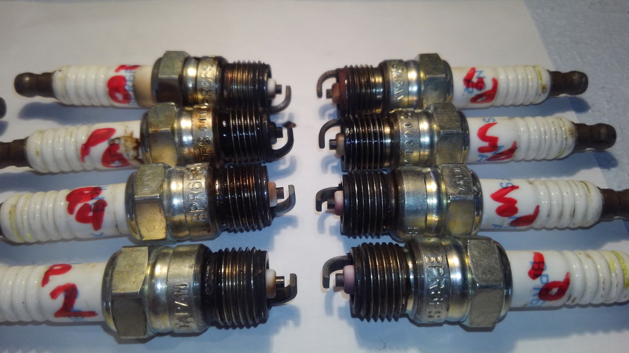

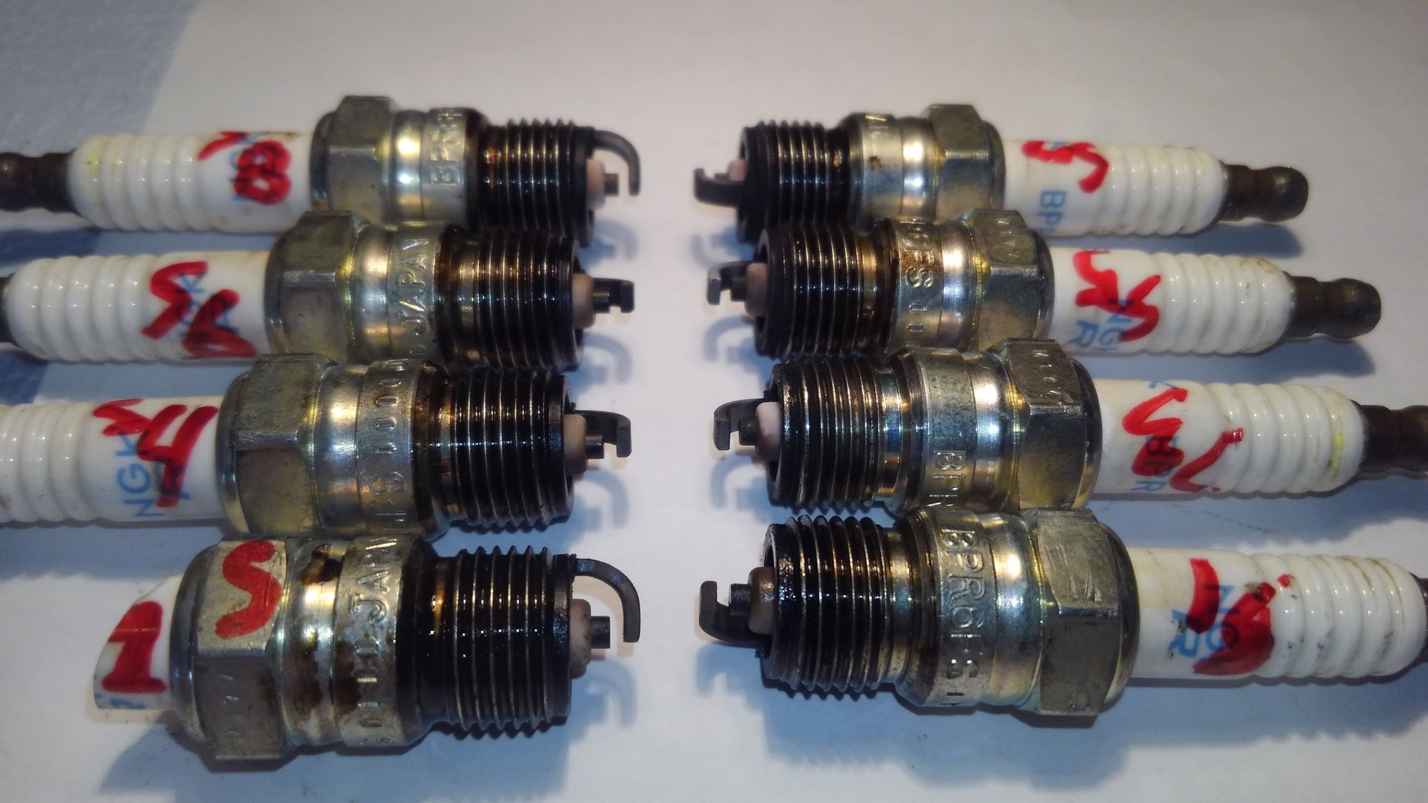

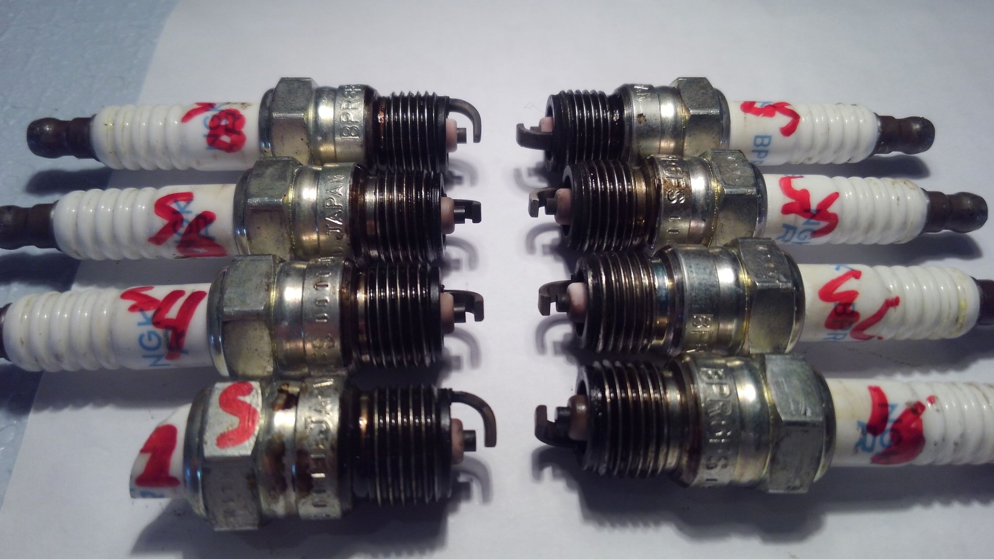

DrFeelgood 07-24-2022 03:25 PM
Plug Pics, labeled S and P plus cyl number

[email protected] 07-24-2022 04:18 PM
Do you know what afr and how much time is on those plugs?
F-2 Speedy 07-24-2022 04:26 PM
At a minimum looks like the heads need rebuilt, did you check the valve springs on those leakers
DrFeelgood 07-24-2022 05:08 PM
No clue on AFR. These plugs probably have 8-9 hours on em.

BillK 07-24-2022 06:34 PM
I think your readings on those two are flukes. Probably got a piece of carbon in there when it shut down. The compression is not all that far off on those cylinders compared to the others. If anything the plugs on P6 and S1 look the worst. I would run it some and then check it again. I cant imagine hurting anything in the bottom end by continuing to run it for the rest of the summer. Just use some common sense and if something changes drastically then call it a season.
