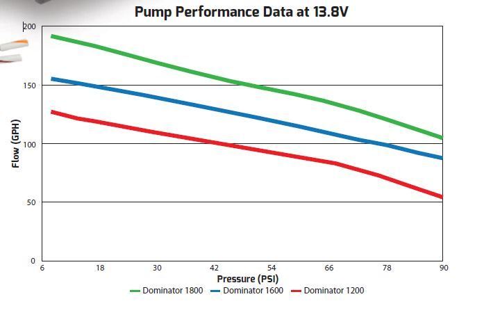

My fuel pumps are at the edge of being undersized if I were to use only E85 .. marginal with a 49% mixture. Might have to upgrade those
GPH=(max hp x bsfc) /7
I need about 101gph
I have the dominator 1200 and at 45psi it`s about there .
