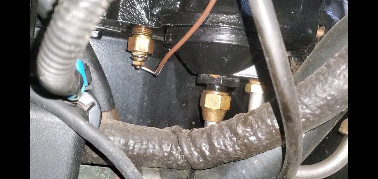

1998 454 mag mpi , Trying to figure out what this sensor is one of the motors has nothing connected to it the other motor has what I believe is the trim limit while you're going into it for some reason , The trim limit sender sender was not hooked up on either motor and I'm putting them in and as I'm trying to find the wires I realized this one went to the sensor does anyone have an ideal of what the sensor is located next to the oil pressure sender?

bigfarmer 12-01-2022 03:01 PM
Oil temp sensor
DrFeelgood 12-01-2022 03:02 PM
Oil temp sensor

OK is there 2 oil temp senders
Originally Posted by DrFeelgood (Post 4852659)
Oil temp sensor
how am I getting oil temp reading at the Guage when there not hooked up is the two oil temp sensors, the Pic with the wire going to sensor I'm 99% positive its the trim limit wire someone wired to it. The other motor has no wire going to sensor.
Robert Dunsmore 12-01-2022 03:40 PM
2 sensors on motor?
Originally Posted by bigfarmer (Post 4852658)
Oil temp sensor

ugh the trim limit switch wires were cut off at back of transom and trying to find wires they got o , wire diagram says brown and white wire , but the the oil temp wire on guages is brown white. Now I'm confused because I can't find another oil temp Guage . As I'm also replacing all my guages and putting in new senders , found all but oil temp sender , so the Pic I posted must be the oil temp sender and one of the guages must not have been working, as other motor didn't have wire hooked to that sensor. Its been 2 years since on water and I don't remember now if Guage worked.....

I'm going to do that, What I think it is is they use the Brown white wire that is for the trim sender and use it for the oil Temp gages instead of the trim Sender gauge because I have mechanical Indicators for my Trim and drive. We'll have more of an issue of trying to find the oil temp sensor but one of the previous posts said the picture I posted was the oil temp center I think I'm just gonna relocate it as its on bottom of motor and I have a new sender unit for oil temp that came with guage so I'll leave old one and find new place for new sender sensor , I fu$^/ING HATE Electrical s*** Color blind never helps me out!!! Because now I need to figure out how to hook up trim limit switches when I have no wires for it there was trim limit and sender units on the back of the Outdrives but the wires were cut off as they went through the hull not sure if they were ever used at any time but I would definitely want Do you have a trim limit so I don't raise my drives too high Because even with my mechanical indicators I have raised my drive too high before my mistake!
