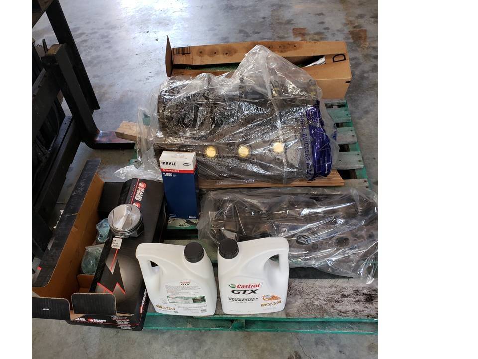

Will look for the 4.380 gasket. Was doing the compression ratio calculator (summitt) and must be entering something wrong because its coming up with 8.1
Bore 4.31
Stroke 4.0
Cyl head vol 118cc
Piston vol -2 (using standard pistons)
Deck .018 (std deck .018 to .020)
Gasket .039
https://cimg8.ibsrv.net/gimg/www.off...3ebddb4e0c.jpg
