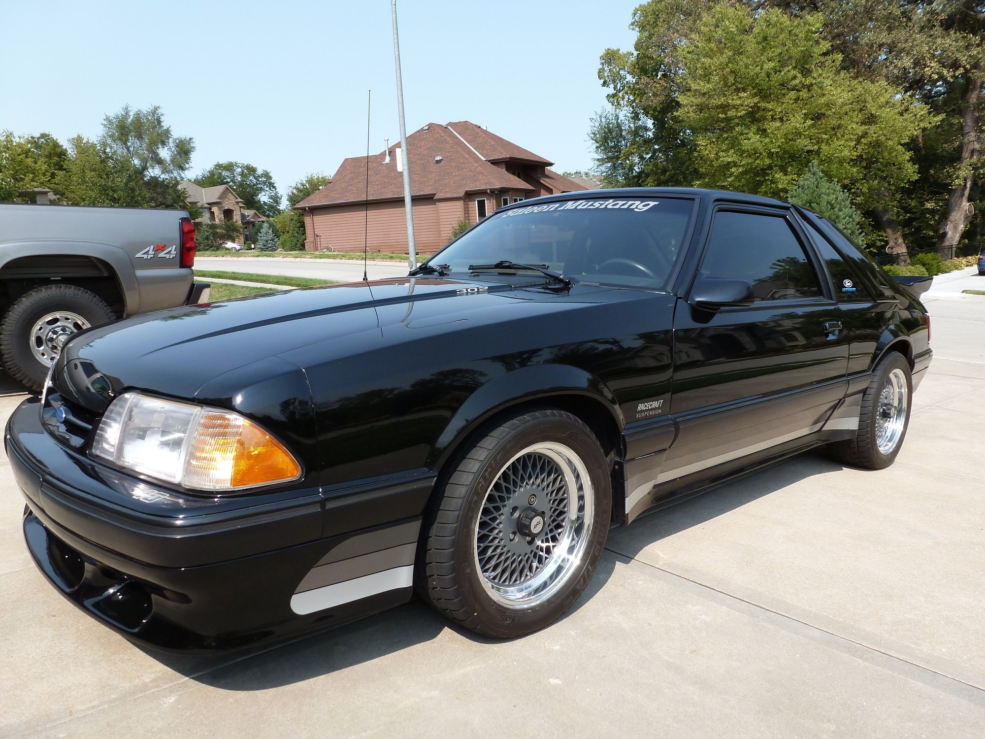

Of course not lol. Thank you. I posted pictures before, wasn't able to the other day. Here's my car I have owned for 33 years. 353 Dart 8.2 iron eagle, callies magnum crank, oliver rods, 9:1 je pistons, tea tw 205s with n02 exhaust port, t&d shaft rockers, full manual aod, strange 9" rear- 3.25 gears, full weight 100% street car. Has a very mild solid roller cam. Very easy to drive. My son actually drove it (with me) day of the picture. Ran 9.41 @149mph at 3500lbs with single turbo as the car sits in the picture, small drag radial. Didn't take it to the track with twin turbo but added 400+hp on new combo. Should be an easy 8 sec ride. ​​​​​​​
