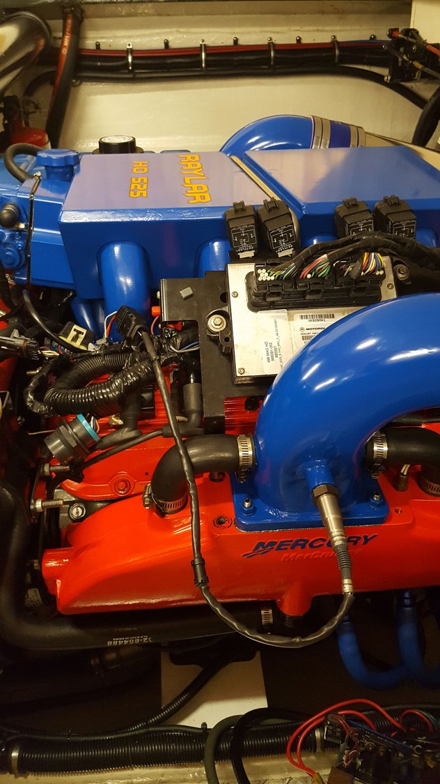

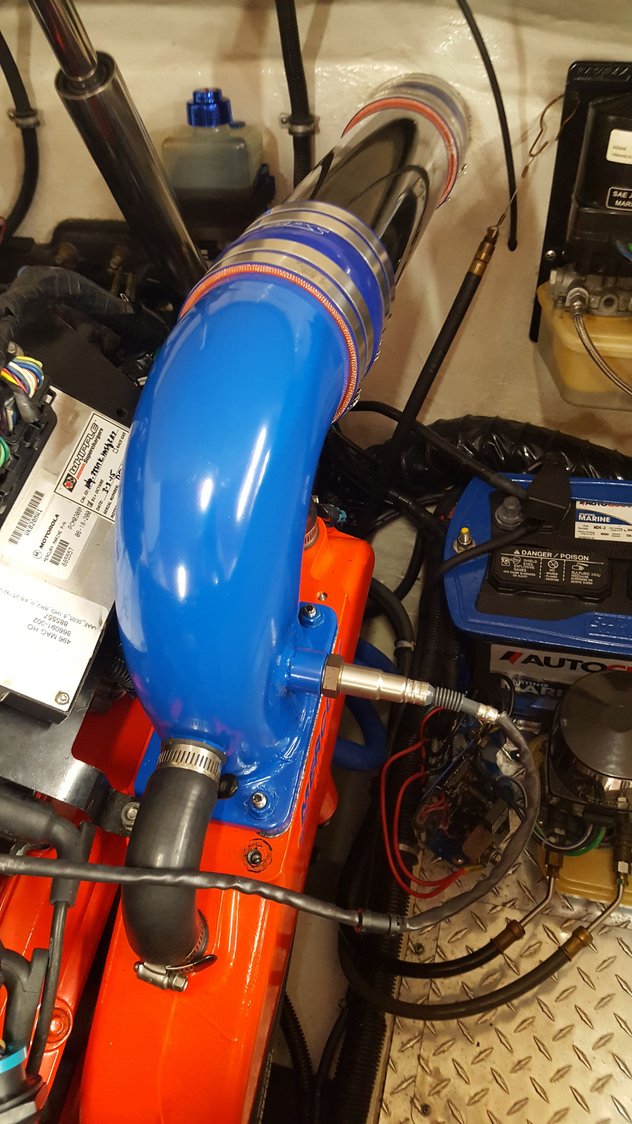

I am running the HO525 203 cam. Think 731 specs. The HO600 206 cam think 741 spec. You definitely want the better exhaust with the 206 cam. Stock exhaust is likely to revert with the 206 cam. Hence Larry moving you toward the stock exhaust friendly 203 cam.
The Dana Marine exhaust made 553hp with 203 cam. Stock exhaust was 530hp.
Run the 206 cam. Modify your stock risers like mine. Upgrade in future.
Follow my recipe.....3" stainless extensions welded onto the stock 496 risers. Mine were 12.5" long. Water mixes with exhaust at transom. If you are running rubber exhaust hose make sure extensions do not touch the rubber.
More info on your setup. Heads? Intake?
Follow my recipe.....3" stainless extensions welded onto the stock 496 risers. Mine were 16" long. Water mixes with exhaust at transom. If you are running rubber exhaust hose make sure extensions do not touch the rubber.
https://cimg9.ibsrv.net/gimg/www.off...28c47e1b5e.jpg
https://cimg5.ibsrv.net/gimg/www.off...1d769821bb.jpg
YESSSS! this is exactly what I need! Sent you a PM! Would love to talk to you about your Raylar experience as well!
