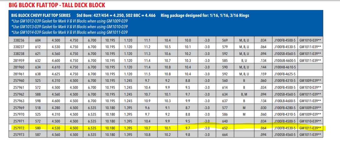

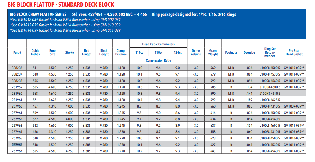

IMO, at 4.375 stroke, make a sacrifice on the rod length and go 4.5 stroke. 580CI at your bore. :cheer:
https://cimg3.ibsrv.net/gimg/www.off...535f0b8b82.png

Cheech,
That chart pertains to standard deck blocks. My hopes would be to use a tall deck and use longer rods to minimize rod angle. I was talked off the proverbial ledge on the idea of a 632 for this very reason. I'm just looking for where the conventional wisdom is on where to aim for the stackup. Do we aim high, over the deck height, and use head gaskets to establish final head gap, or do we aim low and machine the decks? I'm sure some of both will be in the final recipe, as I'm sure the 10.2" is not a super precise dimension with a new block.
Thanks. Brad.
(937)545-8991
cheech 03-20-2023 12:47 PM
Originally Posted by Brad Christy (Post 4862454)
Cheech,
Thanks. Brad.
(937)545-8991
I'm aware that was a short deck block.
I highlighted the piston number YOU linked in your previous post.
A piston doesn't know what deck height block it is in. The builder does!
Reread this:
Almost anything is possible with any combination $$$, but most shelf pistons are based off a set rod length, stroke, and deck height.
Then they derive the compression height.
Take half of stroke listed at that part # you picked out 2.125" + rod length 6.385" + CD 1.270= 9.780"
Just under the 9.8" nominal for short deck BBC. All laid out in those PDF catalogs.
Here if this fits you better here's "tall deck listings".
Just go for broke. 4.375" crank same $ as 4.5" stroke, you're above the 1.270 CD Smitty likes, rod is a menial .165" shorter than a 6.7.
And keep your Procharger regardless!!
https://cimg0.ibsrv.net/gimg/www.off...34c1d6d047.png
