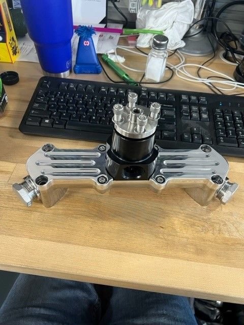

Well I bought one...seems to be a very nice AMERICAN made unit according to the box. Need to get it powder coated and get to working on the serpentine install! :boat:

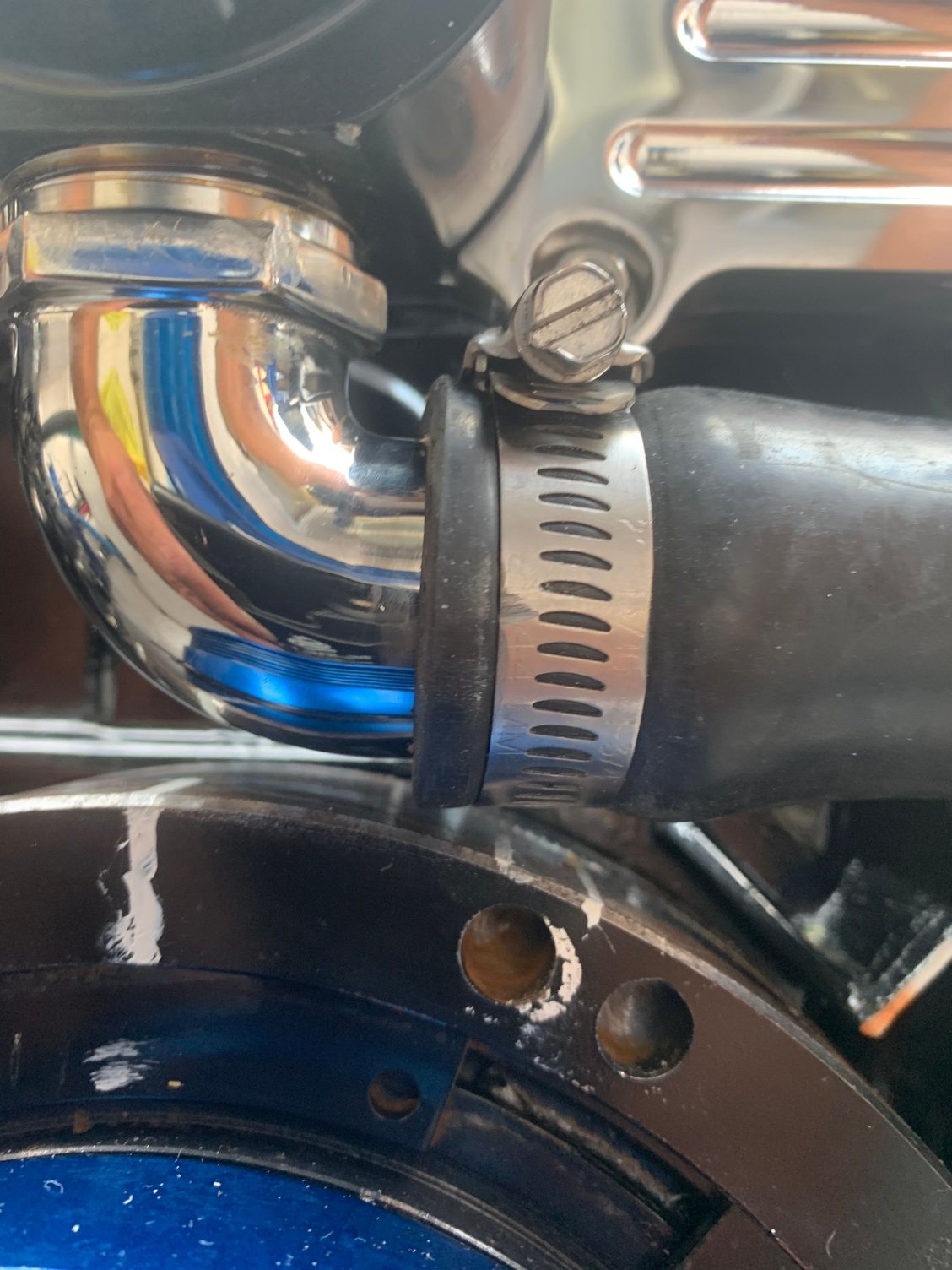

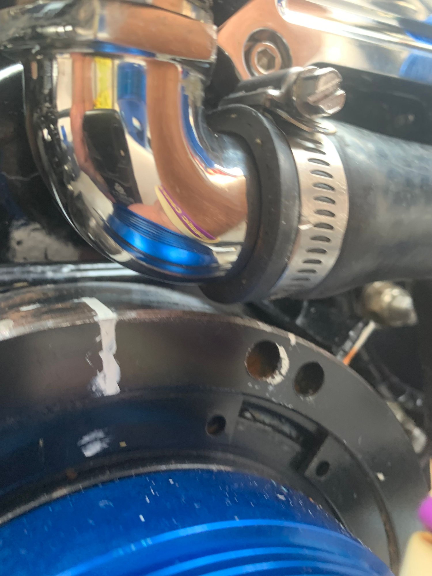

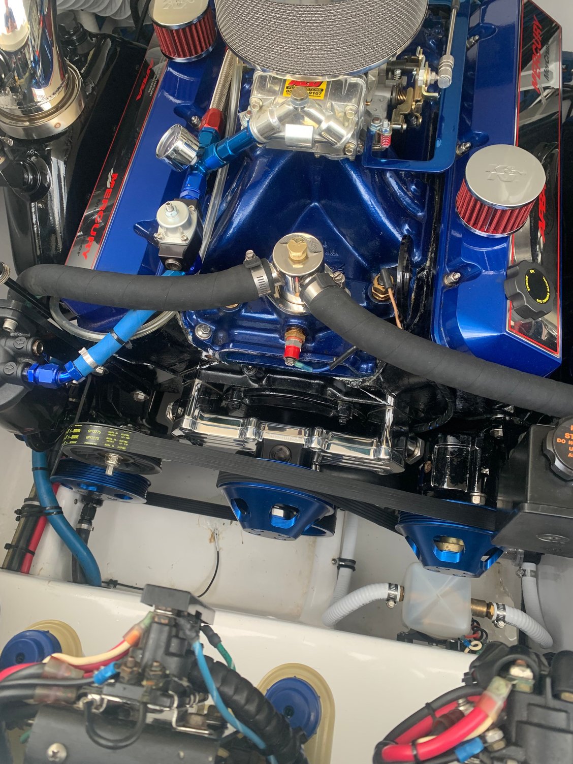

I have these on my boat and the only issue I had was using the bottom water inlet. When you put the 90 degree fitting in the bottom it hit the balancer so I bought a tap and was able to tap it some more so it wouldn’t hit the balancer. It worked but I can just about slip a credit card between the fitting and balancer. You can use the other 2 side ports to feed the engine also. I also had to go with a different belt size.

BBYSTWY 04-12-2023 10:35 AM
Oh yeah that is close! I have to wait to get everything installed to see what's gonna work. I'm hoping I can get my blower pulley past the crossover pulley without hitting!

BBYSTWY 04-12-2023 01:04 PM
Well....she's ready for powder coat along with a couple other items :evilb:
