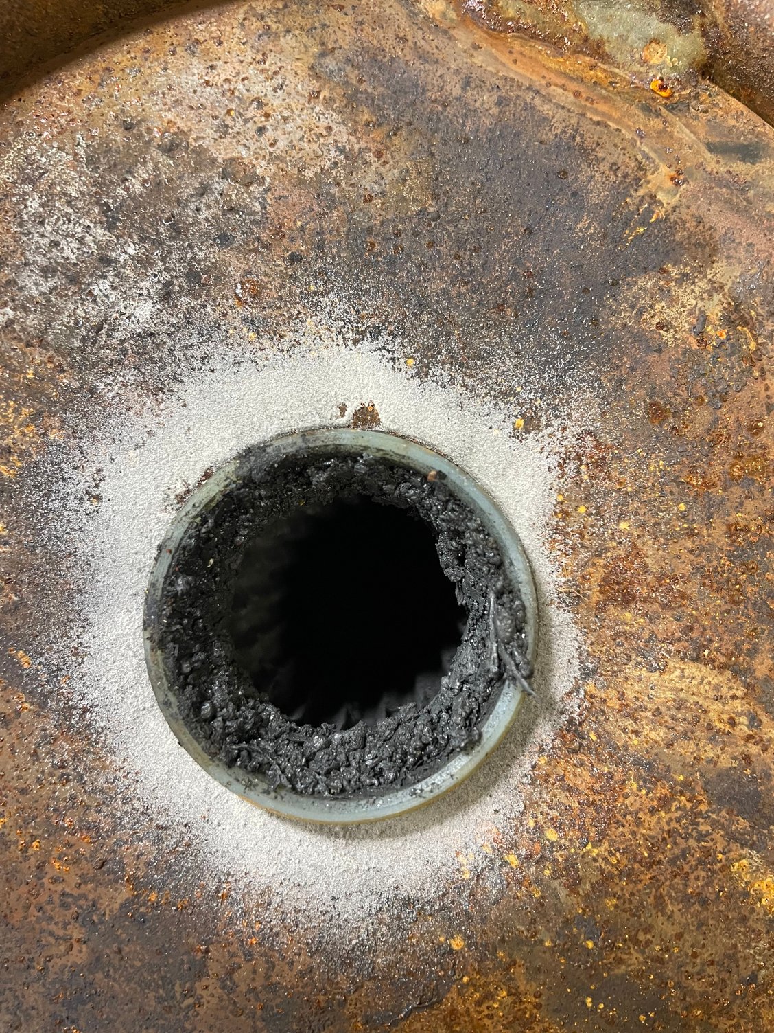

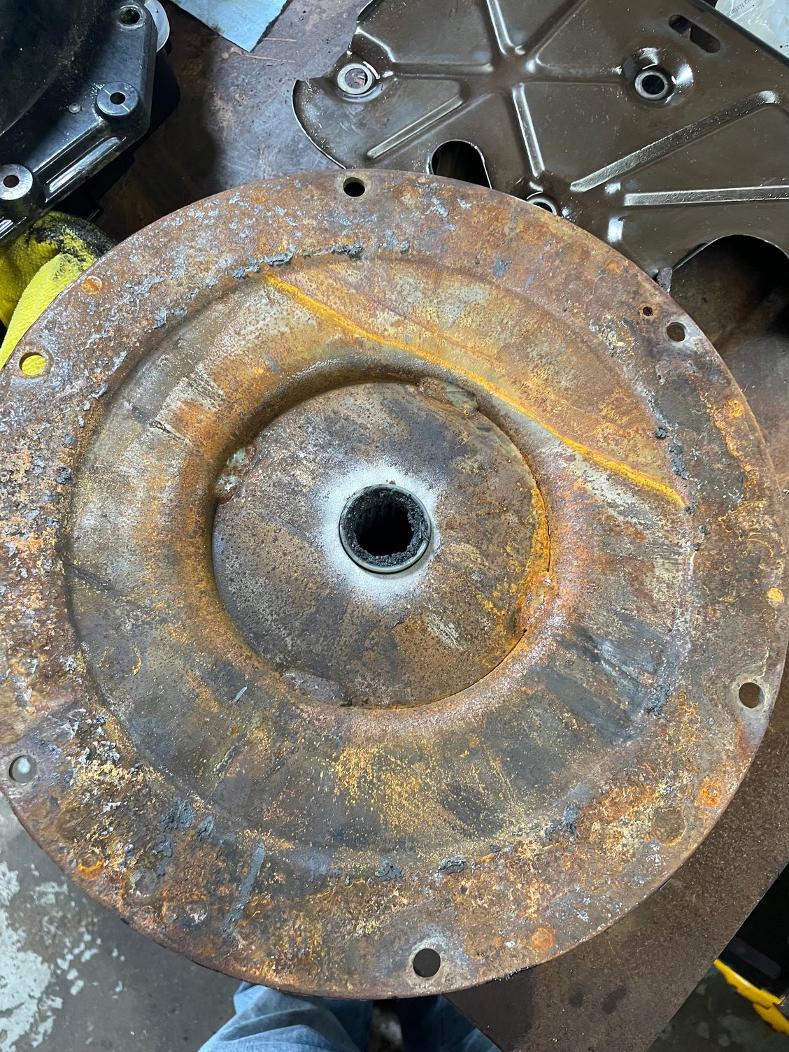

Good morning guys, As I am waiting for my rebuilt engine to finally be completed I want to be sure when it comes home I am ready to drop it in so I can get on the water ASAP. It has been a wallet unfriendly y so far as expected (BOAT!) It started because the boat was loosing power and speed plus the steering pin was leaking into the boat come to find out the engine had a blown head gasket and was injecting water so all the exhaust valves and seats were pitted to hell.

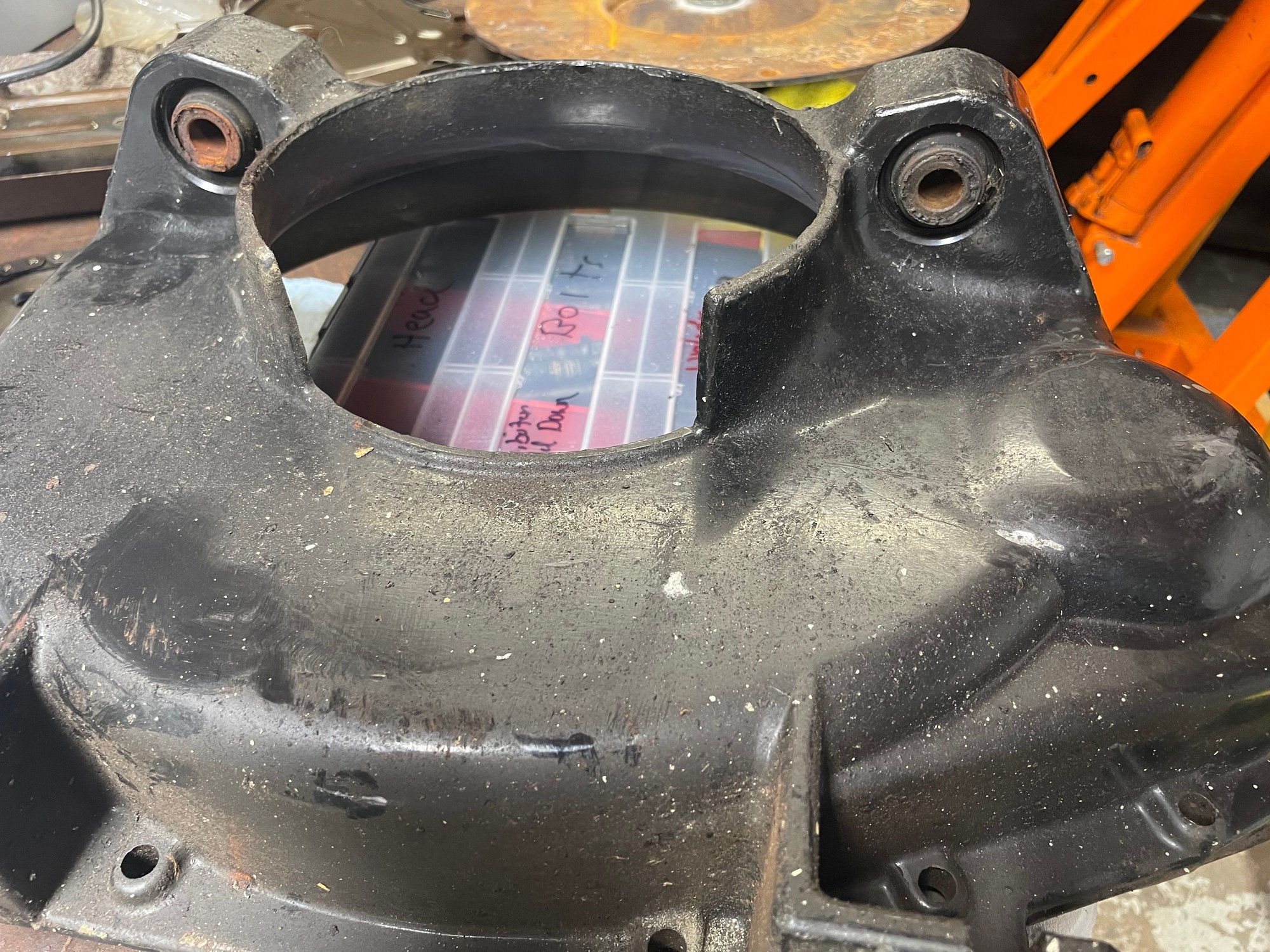

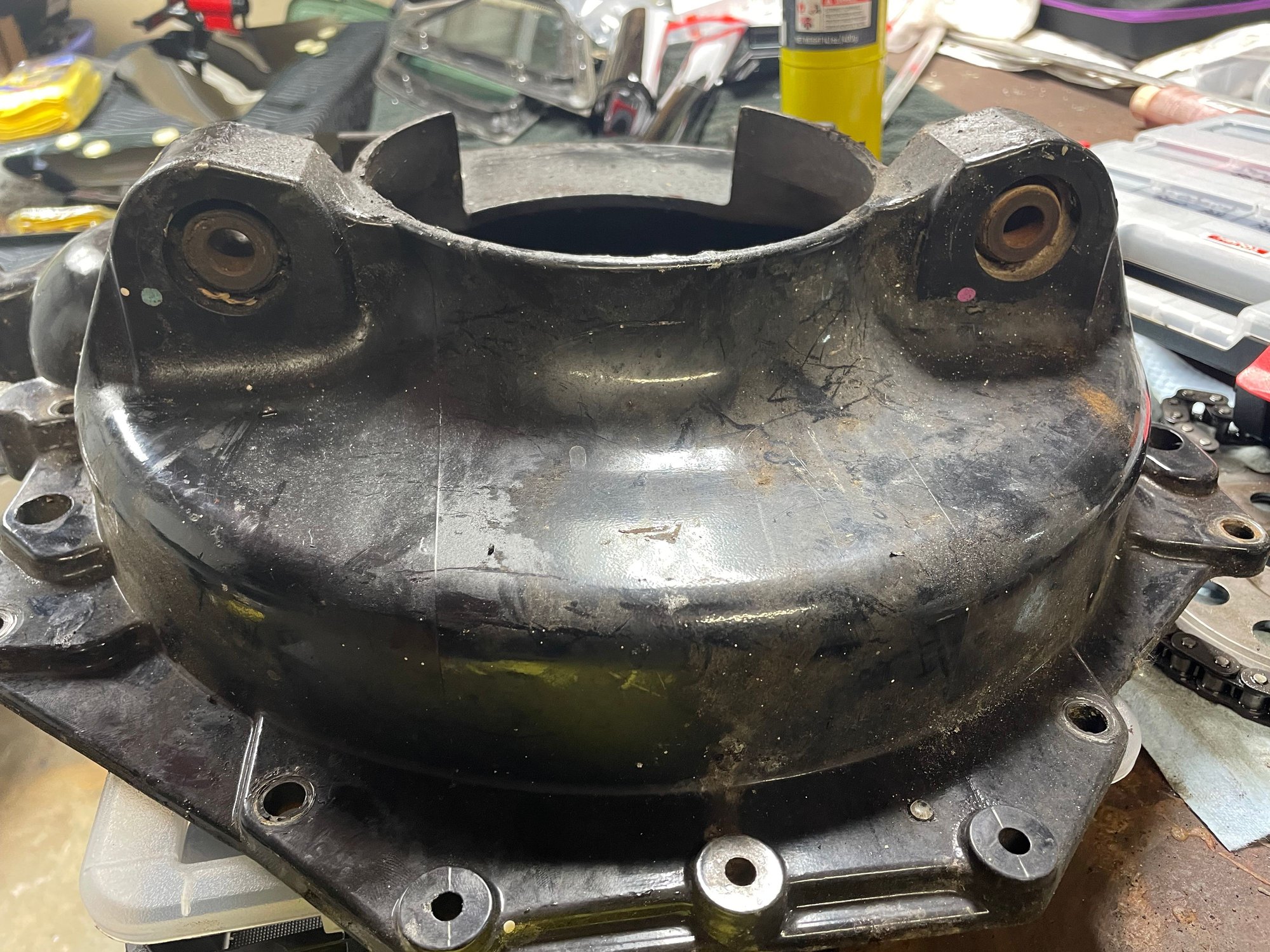

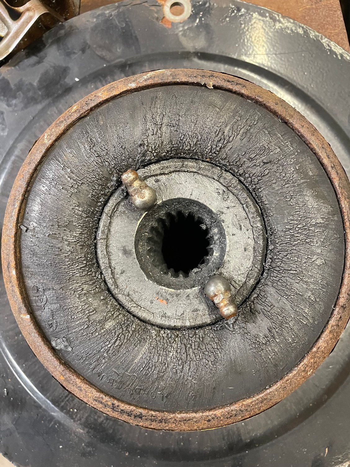

I have a brand new Bravo HP transom assembly now, engine is going to be completely rebuilt but what about the engine coupler and bushings in the bell housing. The splines look good on the coupler but is the rubber bad I do not know and the bushnings/bolts for the rear mounts, do they have upgraded ones I should look into changing too?

It is hard to tell for sure because of the grease on the splines, but they look pretty worn to me. The teeth should be flat on the surface, not pointed. Clean it up and take a better look. As far as the bushings go, they are relatively inexpensive and easy to change with a ball joint press.

ive always cleaned them and regrease, the easiest way is once its clean if the splines are sharp, worn and pointy like this /\, then it needs replacing, or if the rubber really moves while testing it with a shaft. the cost of a new one, or a nicer used one is worth it while you have the engine out would be lost if it spun on you while out.

I agree, I have no interest in doing it twice. I will clean it up this weekend and evaluate it.

I will get it cleaned up today, is there an upgraded bushing & bolt kit I can switch too or doesn't matter?
