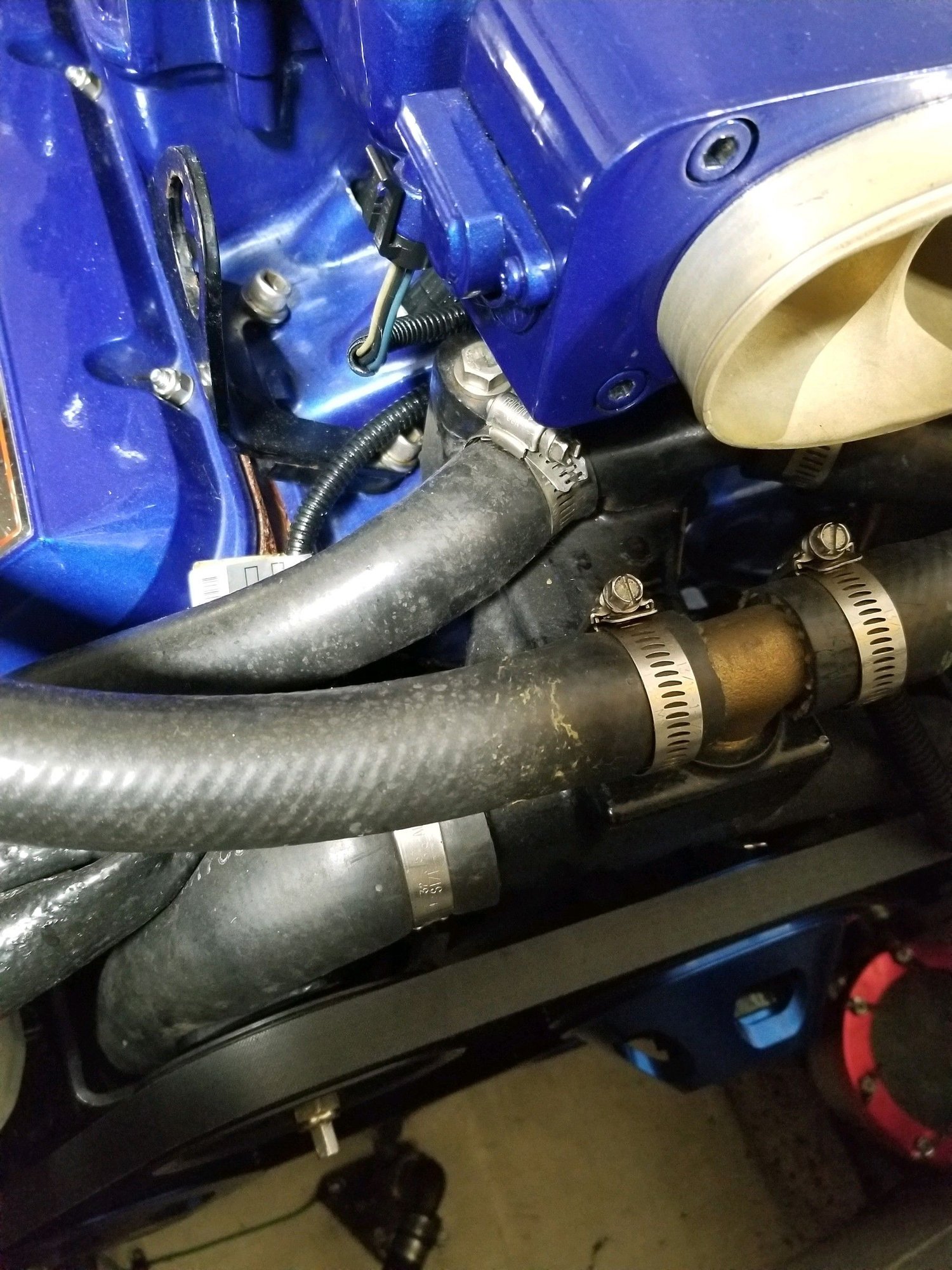

Based on the input above regarding using the block drains and how hard it is to access them, etc. I've decided to drill and tap the thermostat housing. Aside from avoiding drilling into the thermostat itself are there any other things to watch out for? Does it matter what side of the thermostat I tap?

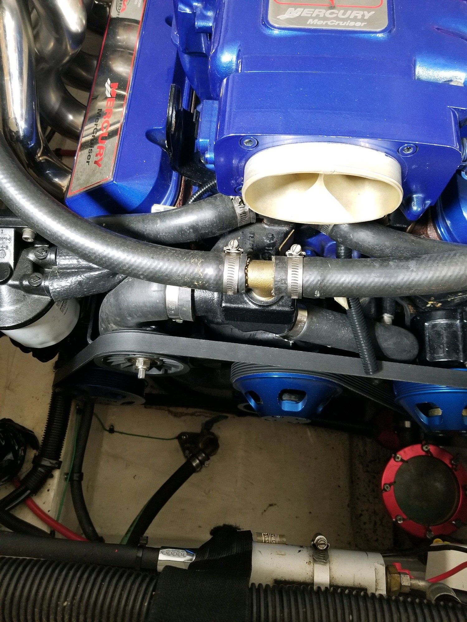

F-2 Speedy 04-13-2023 04:00 PM
pq what thermo housing do you have post a pic

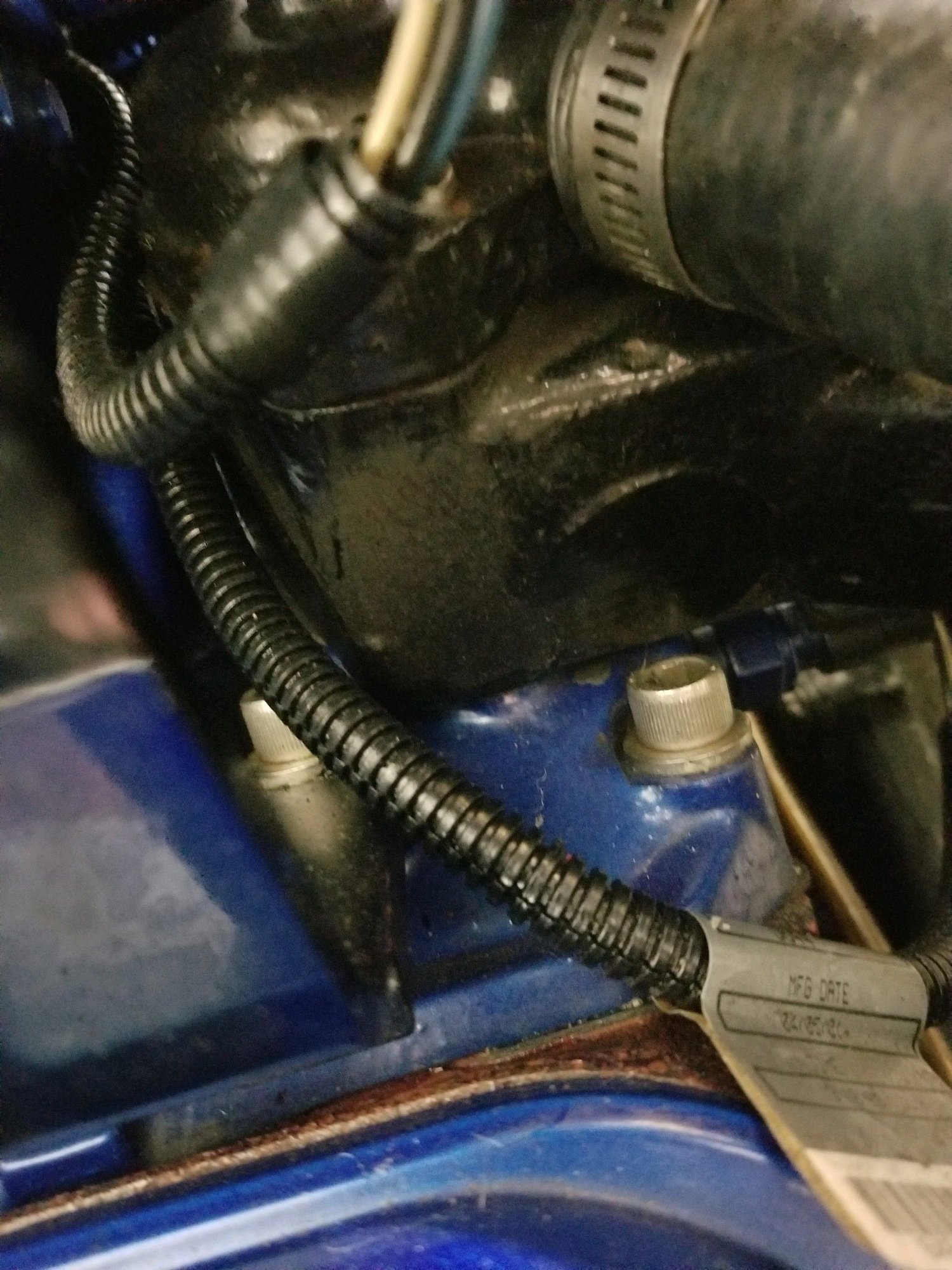

pq270jtw 04-14-2023 05:38 PM
Man what a rookiie. First time trying to upload pics on here. Anyway not real easy to see but on the left lower (below the thermostat) is where I plan on drilling and tapping.
https://cimg3.ibsrv.net/gimg/www.off...1fc60e8ceb.jpg
https://cimg5.ibsrv.net/gimg/www.off...18229c6883.jpg
https://cimg7.ibsrv.net/gimg/www.off...160cb53143.jpg
F-2 Speedy 04-14-2023 06:35 PM
sorry I didnt see your first post being 500 efi, that should work
