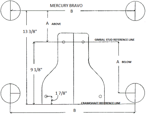

Is it possible to measure using the transom assembly stud holes to find where the trim pivot center is? Assuming crank centerline is same as the trim pivot centerline. If so does anyone know this measurement? I have the transom assemblies off and need to find this centerline to mount Imco steering bracket.
I found this exhaust measurement searching the web, wondering if 1 7/8" is accurate.
