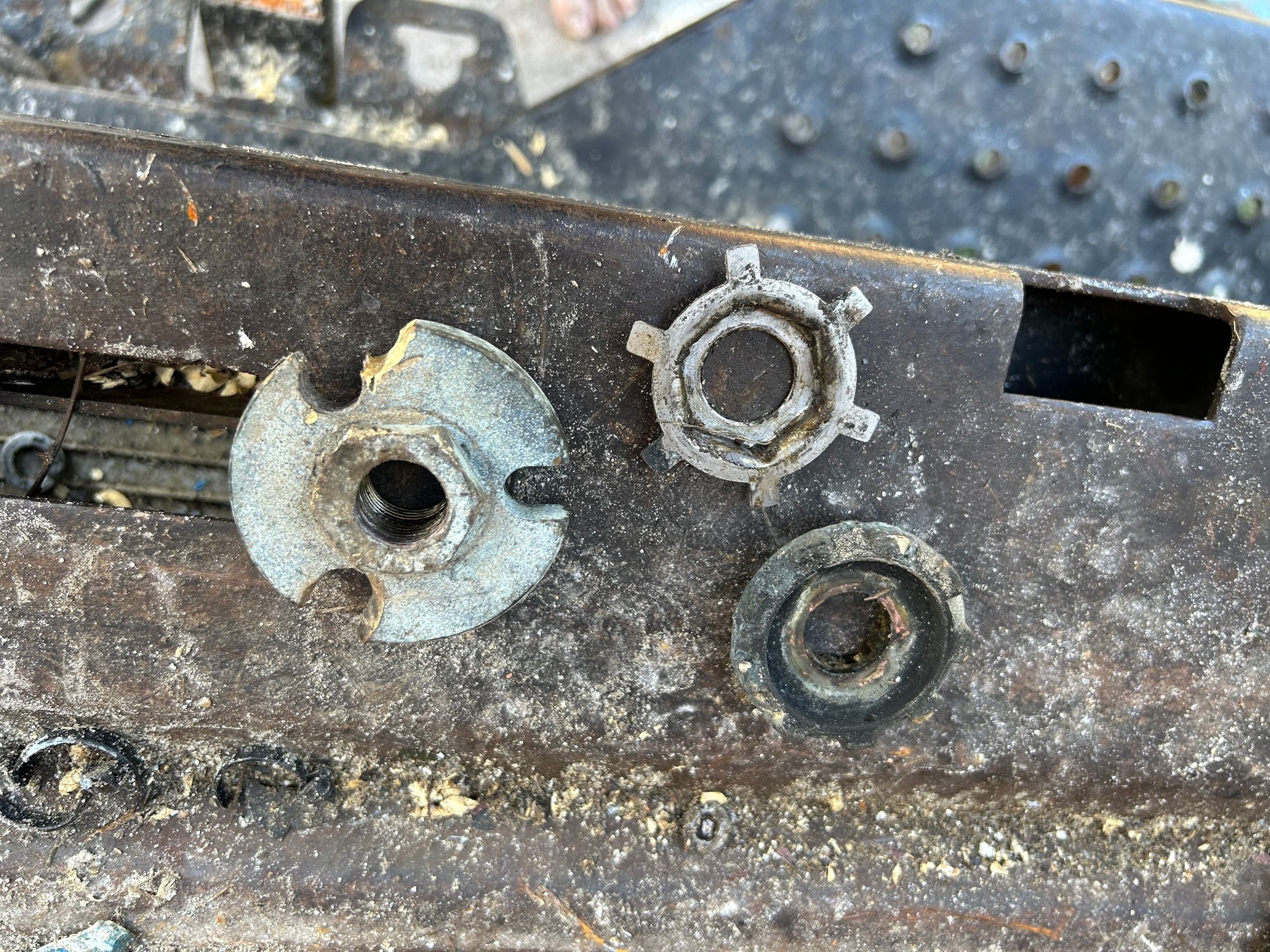

prop retainer i have never seen before
https://cimg6.ibsrv.net/gimg/www.off...3884ea2a3.jpeg
this is on an early mercury v6 outboard. essentially an alpha with a long driveshaft. looks like a set screw. 3/8 or 7/16th thread and i guess i need a small 3 pin spanner socket. or is this more of a hammer-and-chisel type of removal method?

I dont think that is a prop retainer
I remove it with a punch or big screwdriver 🪛 and hammer 🔨

PQ290Enticer 04-25-2023 06:40 AM
Well no body is stealing that prop. Maybe a lot of penetrating oil and needle nose pliers or 8 penny nails and vice grips? Let us know how it goes.
dereknkathy 04-25-2023 07:12 AM
tried to find a 3 pin spanner socket, but all are big enough for trim cylinder ends or larger. thanks. sort-of ideas there...well, the big nut is bronze. dremel made short work of the set screw. got nut off, and now looks like i need to burn the hub and pull or cut the inner parti of the hub. wife asked "why do you have to drink to enjoy boating?" "I don't. I drink to kill the PAIN of boating!!"

speicher lane 04-25-2023 07:25 AM
Is that just a set screw that just puts pressure on the prop? It almost looks like a modern retainer behind the prop nut...
Does the small screw even protrude into anything to lock it in place? If it does - just drill it out

I Know this kind of retainers from Older aftermarket wheels. they had them on the wheel caps for protection against stealing them. Older Borbet wheels had them on my Volkswagen Corrado years back. The 3 holes were slightly out of middle so that you needed the particular key for them. chisel and hammer did the job when i lost the key back then.

SB 04-25-2023 08:09 AM
I never saw one until your pic, but i entered:
security 3 hole bolt
into google and a whole bunch show up.

dereknkathy 04-25-2023 01:04 PM
it is a standard merc retainer. the set screw held one in. the big nut is bronze. dremel did the trick. then hammer and punch to loosen it cuz bronze wrench flats don't stay flat very long. so now i am down to the typical frozen on prop even though nut and retainer are off. wreck the hub with a torch puller or cutoff wheel or both.
I guess it’s the prop version of the McGuard wheel lock. Without the stupid little wrench, you can’t get the prop off. Or a Dremel.
https://cimg3.ibsrv.net/gimg/www.off...6c6bc0d8a.jpeg
The little setscrew nut dropped down inside the prop when I knocked it loose. And it doesn’t want to come out. I’m sure it will later if this lower unit ever ends up running again.
