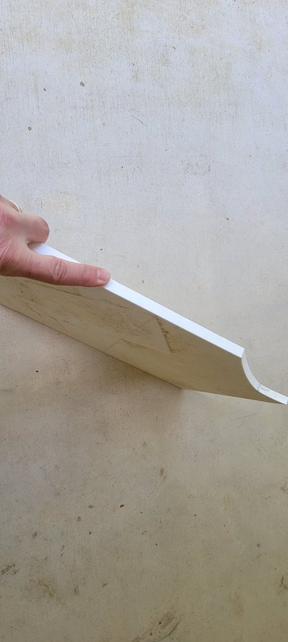

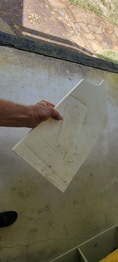

I'm looking for a source for sheet PVC or Starboard to build the frame for a rear bench seat. I've looked thru McMaster, and some other sites, Found a few options but don't think it is what the industry is using. I tried searching the forum and came up empty. Anyone know where to purchase the plastic marine board to construct seats with? Or the correct name of the product I'm looking for would be helpful. I'll add a pic of the product i'm looking for if i can.
thx
tomcei 05-07-2023 01:02 PM
The scrap I have is 3/8"- 7/16" thick.
