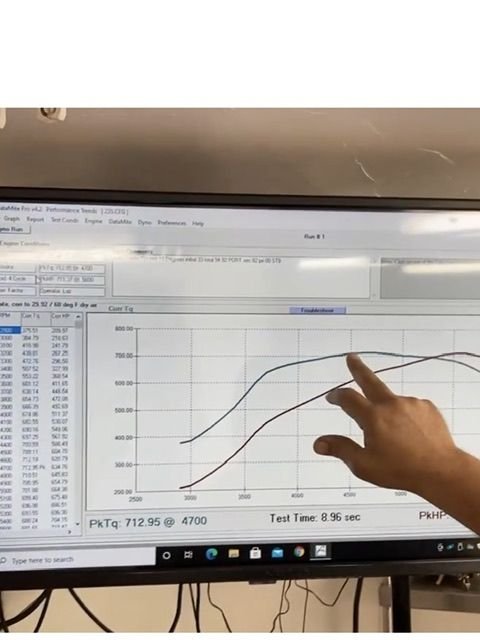

Mine is a little north of 700 using Dart Pro 1 335s. Torque was all in at 4700 rpm and same HP at 5600. It’s in a Donzi 22 classic. Cruise rpm just under 3000 at 50 mph and my limiter is set at 5400 , just north of 86 mph.

How are you propped currently? Solid numbers!
smokediver 06-14-2023 02:39 PM
I am running a 30p Bravo1 labbed by wilson custom marine.
