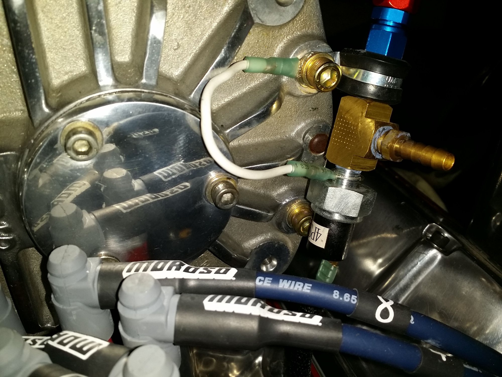

Originally Posted by PQ290Enticer
I saw on a different thread that you shouldn't use any tape or sealer on this sending unit because it could keep it from making a ground contact. I of course saw that after mine was installed. I also used the sealer where the fitting goes into the oil filter block and the other end is a rubber hose so in this scenario it was never going to work???
If the sender has just one wire, you need to ground the sender since the spot you have your sender (in line) is not grounded. Don’t worry about ‘too much’ sealer in your case.
Simply run a ground wire to it from block ground point. Use a male spade connector and put flat against a flat of sender and use a hose clamp to keep it pressed against it there. I do this with 1 wire coolant temp senders on hard anodized intake manifolds because they are ‘electrically dead’ when hard anodized.

I may have other problems with this set up. The one wire post on both senders spins. I don't know if this is really a problem or not? Also, I touched the sender and ground in several locations and the ohm meter did not "tone" but I touched the post and ground and it did "tone". It doesn't sound correct to me but I don't know how it works. I will have to try one of the grounding techniques shown here to see if that helps. I may have broken them and will have to buy a couple new ones.
This really does not mean much. What was the actual resistance ?
Do you have any idea what the resistance should be?
I dont know what the resistance is on that particular sender. Is there a part number on the sender ? You should be able to hook one lead of your ohmmeter to the body and one to the post and it should change as you heat the sender up. A hair dryer should do the trick.
Do you think it's a problem that the post spins?
I have never seen a sender where the post spins unless the post screws in and it has come loose.
Do you think the problem is a "lack of ground"?
Thats what I think combined with maybe the loose center post on the gauge. You should be able to easily check that by rigging a ground wire between the body of the sender and a known good engine ground.

I grounded the sending unit by zip tying the wire to it and the neg battery post and what do you know, it works!! It was a half hearted attempt because I really thought I broke it when the post started spinning. I only did it on the port engine. Anyway, I took it out and used my "Pedestrian" data logger (GoPro) and videoed several different runs. The oil was running at and slightly above the 230 degree mark when running hard. Might have been climbing but I ran out of river and had to go back to "no wake" It's 90 degrees here and probably not the best time for a WOT run to see what it will do but with the B-1's 26 pitch it looked like 5200 rpm and about the same 75 mph. The RH prop I think is untouched but the left has been worked on so not a matched set. I also think that the LH rpm was lower. I will try and post some pics with the info
