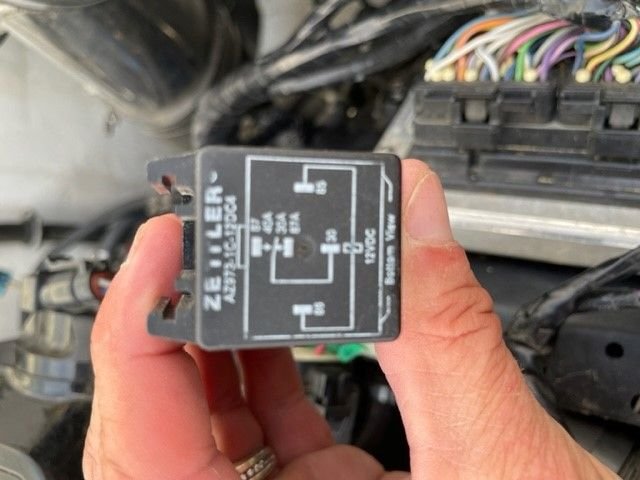

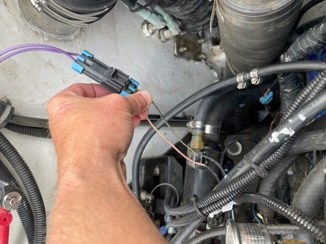

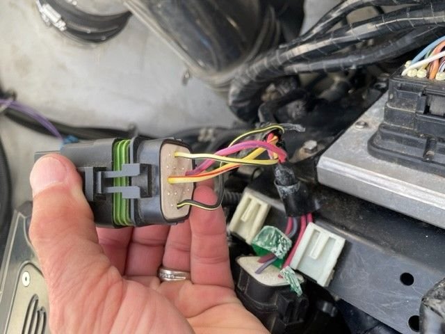

My relay wiring is as follows: 30 pin is red/purple , 85- yellow/black, 86- black/yellow and 87- yellow/red. Here are some pics, I included a picture of my nuetral safety switch wiring.

compedgemarine 07-16-2023 10:15 PM
red/purple should be constant power, yellow/red goes to the starter. if you remove the relay and jump those two the starter should spin. the other two activate so we need to know which is which. thinking the black/yellow is ground but hard to tell. take a test light and go to battery pos. and one of those should light as the ground. the other should light when the light is on ground and the key is start. hard to tell on the neutral switch, assuming the purple are the switch itself but what are the colors on the other side, look like maybe black/yellow and yellow/red?

if i am following correct then the black/yellow should light at the relay when key is in start. if it does then the yellow/black should be a ground as it is on a trans version which would mean that it is not connected to ground. is this the correct harness? I had a 496 here a while back that was originally a trans engine but was now wired for bravo and they had to find the original wires for the trans neutral switch and tie them together
Im using my sons login, Acually, the yellow/black should light when key is in start position. I verified this on my port motor. I followed the yellow/black wire to the 14 pin connector, it turns into a yellow/red wire on the helm side of the wiring. Im going to check power at the neutral safety switch on my shifter to see if there power from the ignition switch in start position. Do you know if this is fused or not? This is what Im thinking anyway. If you have any other ideas, please let me know, I do appreciate your input.
