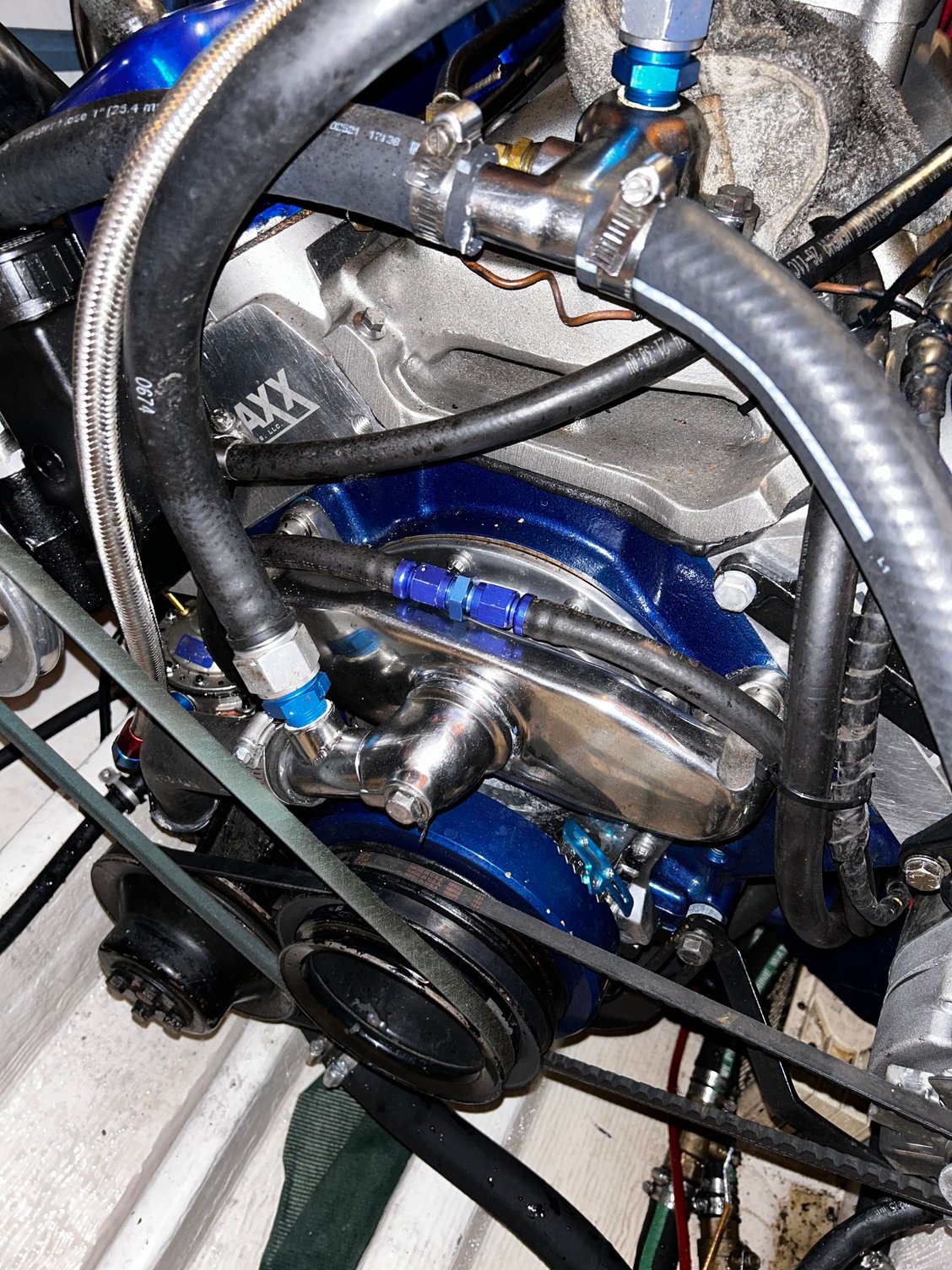

I videod but can’t upload however I got probably about 1/2 to 1 cup of water from each.
To my “not” surprise I went to drain the blocks and not one drained (nothing). I couldn’t even blow through 3/8 hose to release any block boogers. It took a fair amount of air pressure on all four. It’s kind of a mucky area where I beach my boat (marina janks hate me). Regardless you’d think after running for a good hour in good fresh water before pulling the boat it would clean out the.blocks for most part. Not at all and water was nasty and will flush more before filling with rv antifreeze.
I really think more guys should drain their blocks from time to time and one of the benefits of having a quick drain system in place. I’ve seen this several times. Very inexpensive to do! Not sure how all the crud gets past the strainers but does. Looked like chitty oil draining out once cleared.
