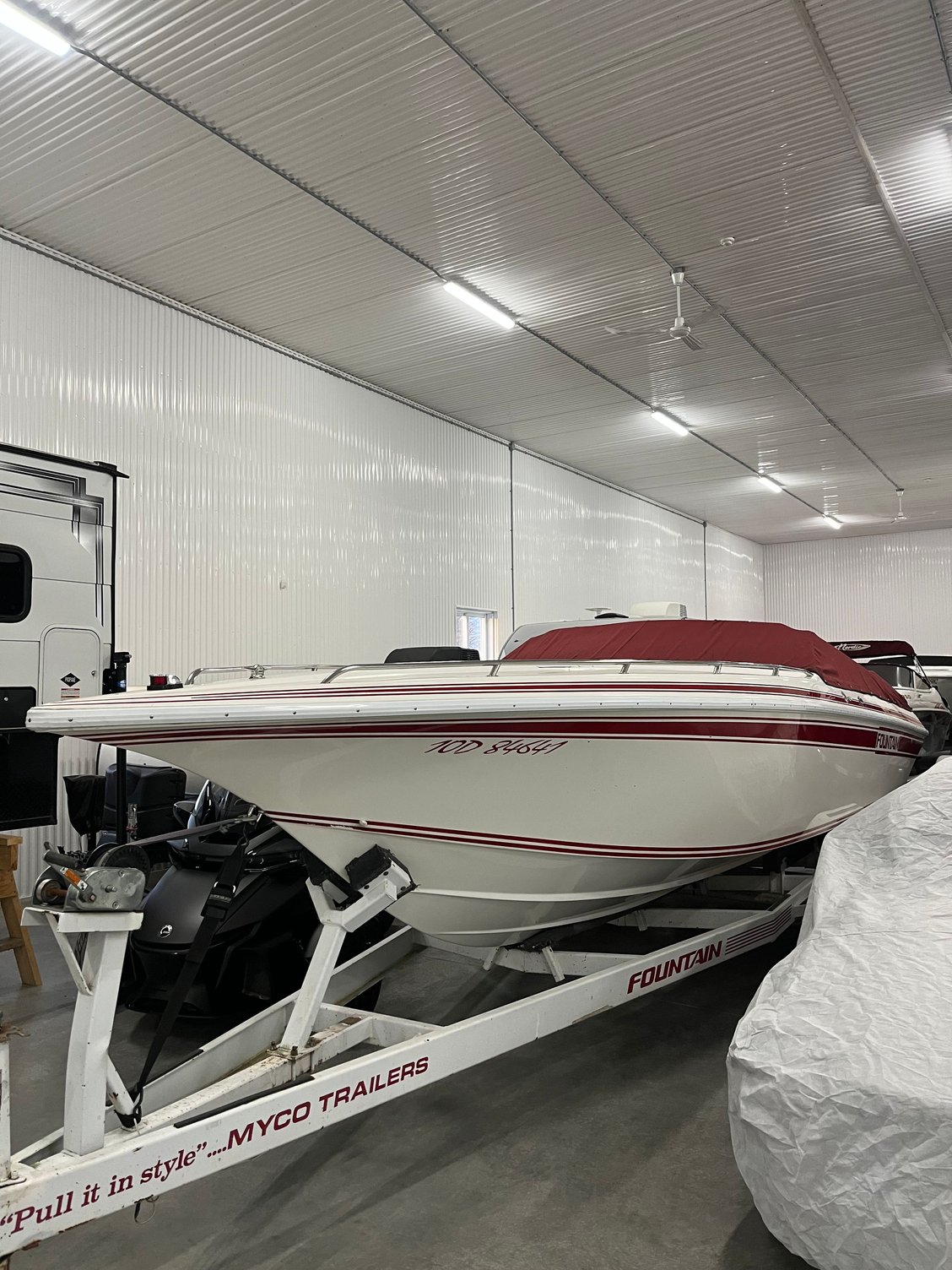

Hello evryone . Y bought a boat last summer .
fountain fever 27 1992
engine was supossed to be a bullet 540 650HP
bloc is a merlin III whit Merlin IV cast iron head .
me question is what the rpm range ?
i run a 28p on bravo XR sportmaster 1.50 whit steeling extension box . Run 5000rpm at 70mph … it realy slow …

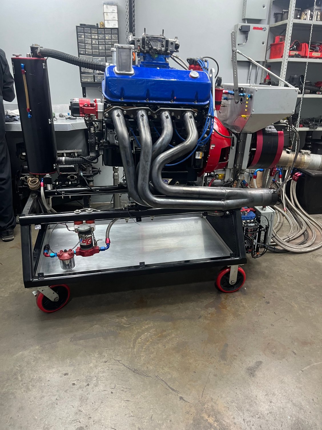

Pref125 05-01-2024 08:09 PM
https://cimg2.ibsrv.net/gimg/www.off...8aa142d33.jpeg
Go on dyno today . For the first pull it’s too lean… asjust the carbs and it 645HP at 5700 rpm’s 😎

JaniH 05-02-2024 04:01 AM
Go on dyno today . For the first pull it’s too lean… asjust the carbs and it 650HP at 5700 rpm’s 😎
looking good, could you post the dyno sheet when its all done?
