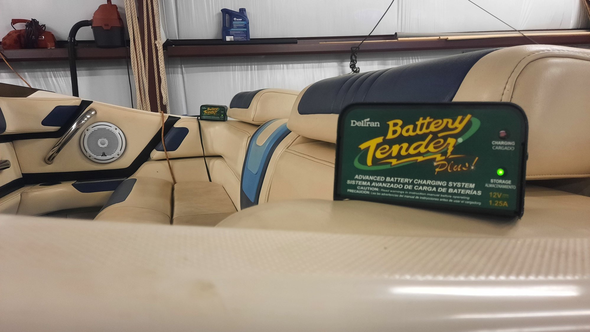

Originally Posted by Tartilla
But I can't see that both batts have a dead cell.
Sounds like just the port batt. When you remove a fully charged batt from a tender/trickler type charger for a bit then re-attach, its normal for the yellow light to come on for a while before switching to green. I have 5 trickle chargers from 4 different manufs and they all act like that. I suspect the starboard batt will go green if left on trickle charger for a while.
If no joy by Monday, I'd take it back to the store. They will do a quick charge then a load test.
I used to pull batts for winter, but haven't done it for the last few years. Doesn't seem to make any difference. They stay on the maintainer all winter.
If batt isn't sealed, should verify water level is good. A specific gravity test would also be a good idea if you happen to have a tester handy.
ZZ,
Yup. It was just the port battery. At least until I swapped the leads. Then both stayed on “faulty yellow”, even after swapping them back. I’m hoping/thinking it’s just the charger that has gone south, if it’s not just that they were allowed to discharge too far before hooking them up. We’ll see.
Thanks. Brad.

Old 03-30-2024 | 09:24 PM
Joined: Feb 2013
Posts: 1,463
Likes: 392
Just noticed you're using a 2 bank charger. I have no experience with those. Could be one side died and the other may be affected too??
I bought these single batt maintainers abt 8 years ago from Walmart. They have worked flawlessly on my Interstate marine Batts. On season 6 this year.
