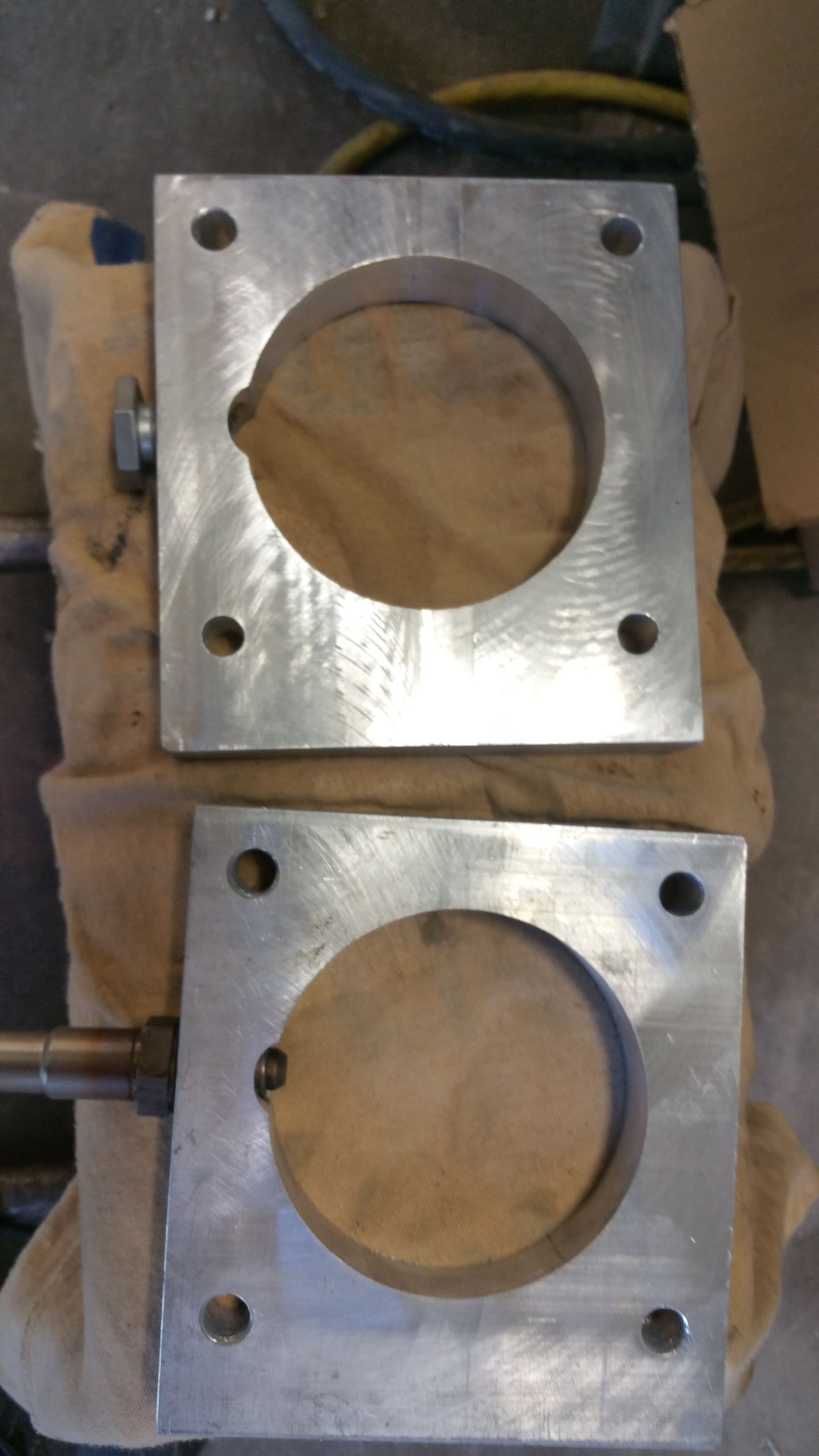

I made my own on a manual milling machine and lathe. Anybody local with a small machine shop should be able to do it for you.

Resurrected,
That's exactly what I would do. In fact, I've given it some thought, as I'd like to get a handle on my AFRs myself. That said... While these would be among the simpler work I'd have done, by a lot, I can't touch doing them for what Affordable FI does them for. Not even close. I like making stuff for myself, sometimes mostly because I can, but I'd buy from them.
It is interesting, though... Having CNC mills, I don't see these as lathe parts at all. Didn't even enter my mind. I had to think about it for a second when you mentioned doing them on a lathe. I've done 4-jaw lathe work before, but I just don't process parts like this that way. Circular interpolation simplifies a LOT of process complications.

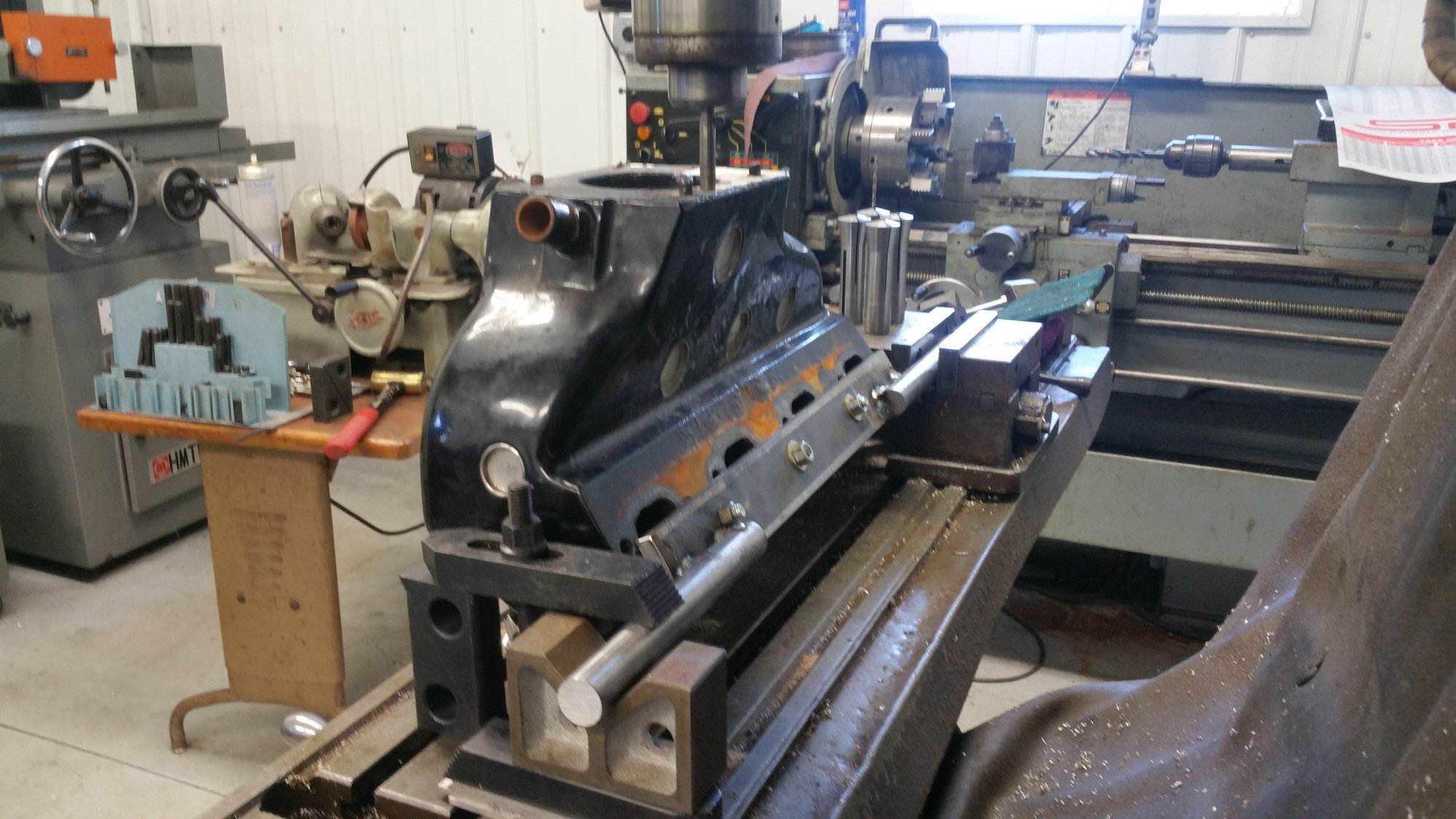

https://cimg1.ibsrv.net/gimg/www.off...9bfaacfa7c.jpg
https://cimg9.ibsrv.net/gimg/www.off...5b53c8107d.jpg
These were the 2 I made to tune my Baja with when I switched it to gils right before selling it. In my case, it was MUCH better to have o2s in side vs front or rear. In T Banzers case, from pics he showed me after I dynoed and tuned his 540 they'd also have to face forward as his rears real tight and with his vortec supercharger, Im not sure hed have much if ANY forward clearance.

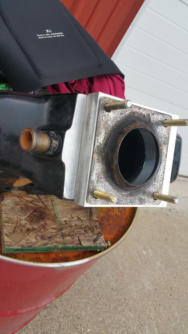

https://cimg8.ibsrv.net/gimg/www.off...f2a70a372d.jpg
https://cimg8.ibsrv.net/gimg/www.off...a9852e585e.jpg
couldnt find better pics, I simply put a block of aluminum in mill table at a angle then fly cut it before boring the hole for exhaust stream, Smitty
resurrected 05-17-2024 06:51 AM
Sorry for the delay in responding, I have not been in the office for a while.
I'm just a shade tree machinist, I didn't have a fly cutter at that time, so the easiest way for me to make the center hole nice and clean was in the lathe. I could of used a hole saw and polished the hole after, but I do like the lathe.
Setting up the 4 jaw is pretty quick. Easy way to polish it as well.
The first one took a while to figure out the angles and most correct procedure, but after that it was easy.
High school trig to get the O2 hole in the correct location and angle!
I did make it harder on myself by making the bottom flat and angling the top and trying to get as much angle into the sensor bung as well.
Looking back I should have just put the bung in square then angle the bottom.
