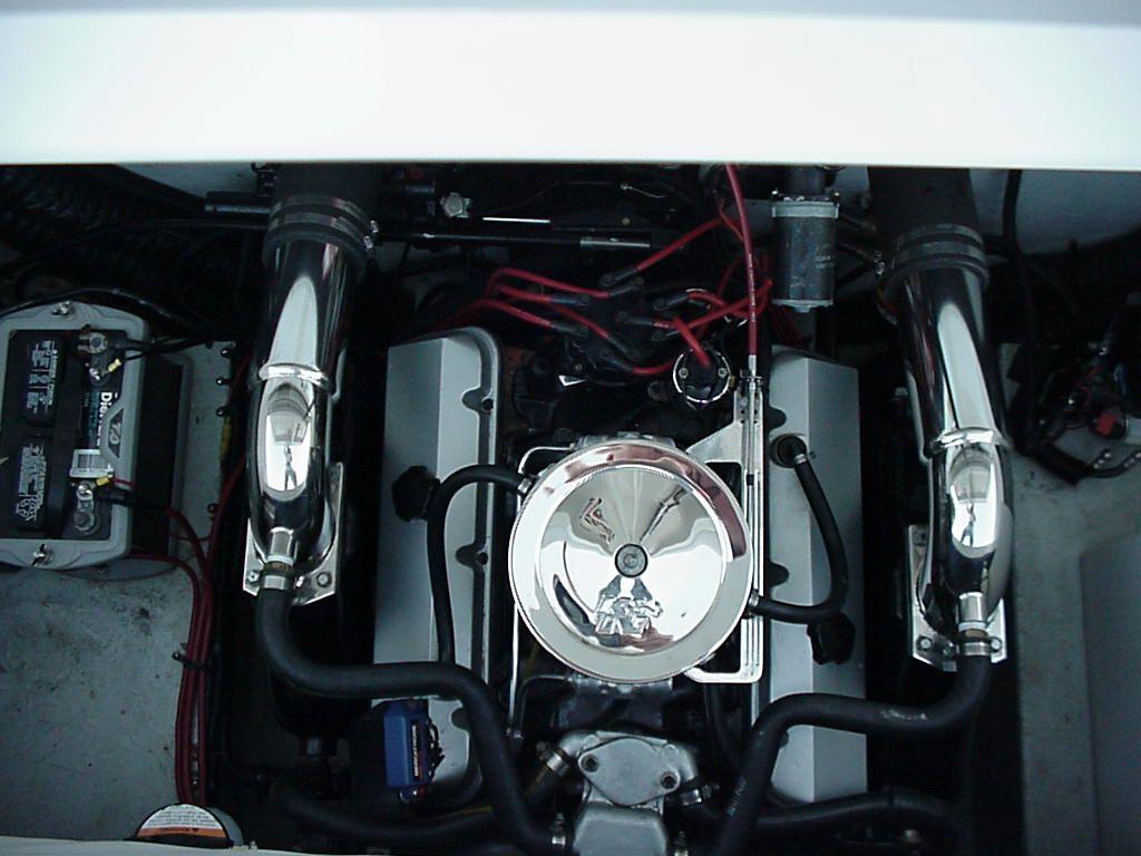

Post a pic of what you have. Either T stat housing should work fine.

Zekester 08-01-2024 04:03 PM
https://cimg3.ibsrv.net/gimg/www.off...428774f4a8.jpg
https://cimg4.ibsrv.net/gimg/www.off...5ed256467e.jpg

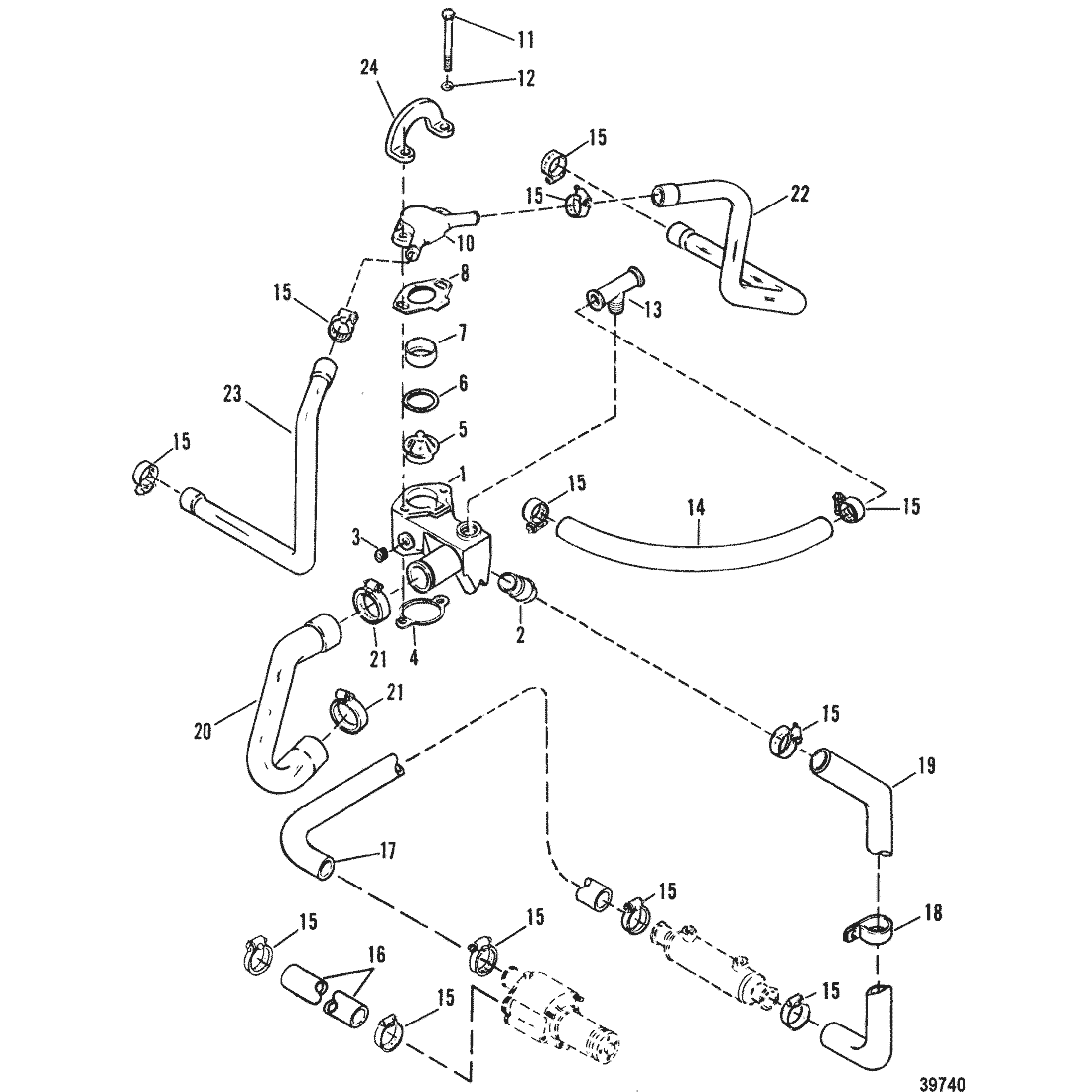

and this looks like what you are using presently?
https://www.mercruiserparts.com/sear...true&orderBy=0
OK, so know we know what parts are what but I don't know the functional differences. I am familiar with the operation of the first two I linked, not the one you are using. There are few of the 8M0061381 here and there on e-bay and amazon has a china knockoff in stainless but probably crap.
I think you have to match the T-stat housing design and operation to the type of exhaust manifold you have, two hose 4 hose?
https://www.mercruiserparts.com/bam/...31953/5725/110
vs.
https://www.mercruiserparts.com/bam/...31796/1614/190
Never really thought about it that much but did not have mix-and-match parts.
Zekester 08-02-2024 11:13 AM
-Yes this is similar to what I'm using, the '4 hose" which was stock on the 330 454 '86-92, https://www.mercruiserparts.com/sear...true&orderBy=0,
The only difference is my top gasket does not have a hole in it. with the solid sleeve in place, and no hole, the only way the exhaust manifolds get cooling water is when the tstat opens. The old 330 had signs of overheating the heads, and I think this might have something to do with it.
-On the 454 magnum, and 502, the manifold is the two hose, which has cooling to the exhaust manifolds right away, but no direct cooling to the elbows, the elbows get water from below from the manifolds. when the tstat opens it just allows hot engine water to go to the exhaust manifolds...in addition to the water already coming from the cold side of tstat.
-the only difference from the 4 to 2 hose elbows is the 2 hose have plugs not inlets, so they get all their water from the exhaust...
It looks like the 502 two hose style was more common, used on small blocks and big blocks...
I'm thinking the 502 style 2 hose is more stable, with the manifolds getting water right away, for the price of a tsat housing the hoses and two plugs, i've the 4 hose...might just try it and use a temp gun to check temps...maybe with this style my temps will run hotter, I still can't figure out why the 4 hose is running so cold...
Do you have experience with the 4 hose? I have mine as per the parts drawing, and it's just too cold...

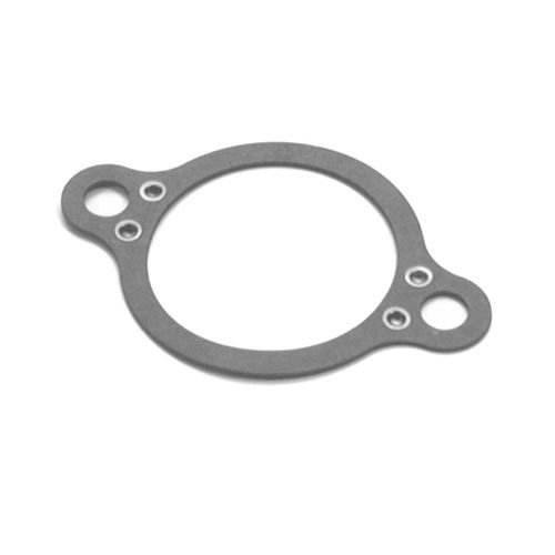

question - did you use tstat housing base gasket with rivets that grounds it to the intake ? If not, your coolant temp sensor may not read anything
https://cimg4.ibsrv.net/gimg/www.off...ab80a6a47.jpeg
Yes, I ran the numbers in the parts diagram and put all the correct gaskets in place...I checked the guage by grounding the wire to the sender case and to a bolt on the intake,
Right now I have the corrct base gasket, the correct tstat, the correct upper gasket (with no hole) and the correct sleeve in the housing, as per to 330 diagram, and have the cooling issue...I'm contemplating switching the housing to the 502 style 2 hose, and seeing if that works...

Yes that's what I have...so the elbows get water from the balled T fitting right away....but the manifolds only get water after the t stat opens, he gasket and sleeve block off and flow until then...Im guessing but maybe the coolant is going through the intake, and out the t fitting to the elbows so it never gets held up to absorb heat...there is always flow...in the 454Magnum/502 set up, the water is held in the intake by the tstat, so it has to warm up before it opens and flows...
does that make sense, or am i missing something about the 4 hose setup i have?

So this is what I have now, the manifolds only get cooling water after the tstat opens, would this not allow the heads to overheat when there is no flow? the tstat doesnt hold any flow as the engine warms up, allowing coolig water to blast by...maybe this is my running cold problem?

My 1993 454 mag ran a 6 hose T stat housing original from Merc. Like I said earlier, either Tstat housing should work fine if plumbed and assembled correctly
Mine was the same as what you have. Merc diagram THERMOSTAT HOUSING(STANDARD COOLING) S/N: 0F3519999 & BELOW (mercruiserparts.com)
