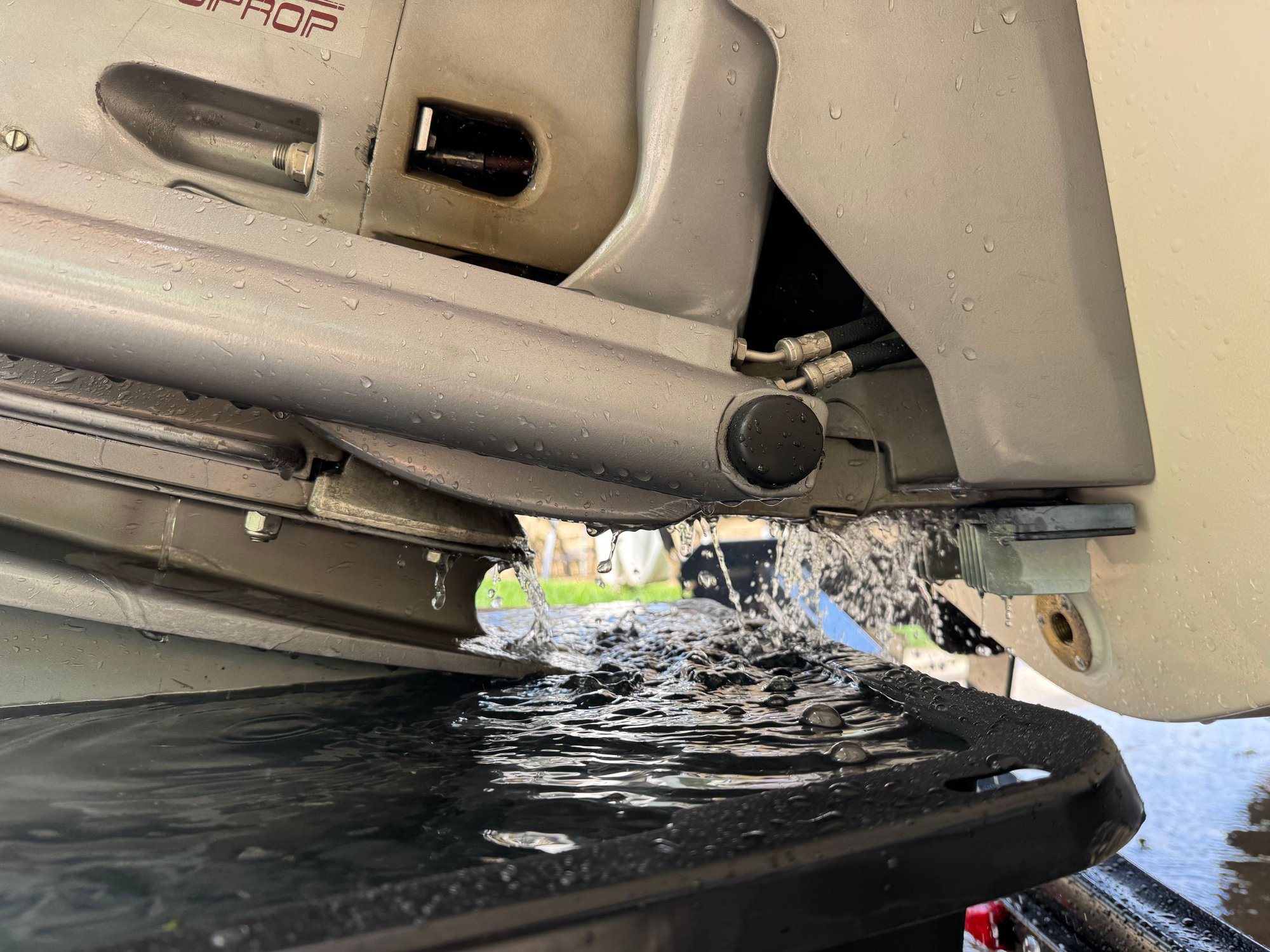

I pulled hoses off the exhaust manifolds today and water quickly and freely drained out.

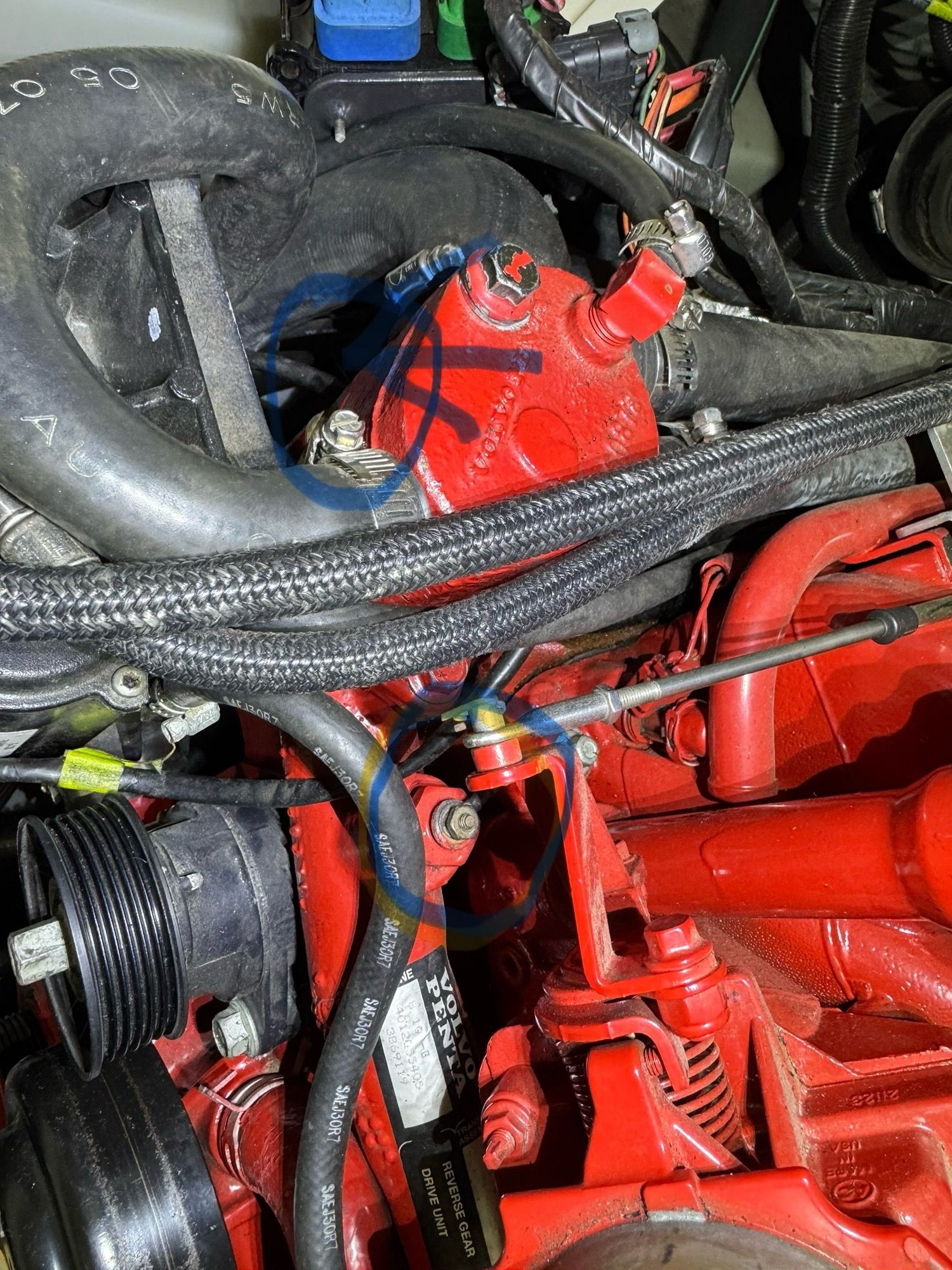

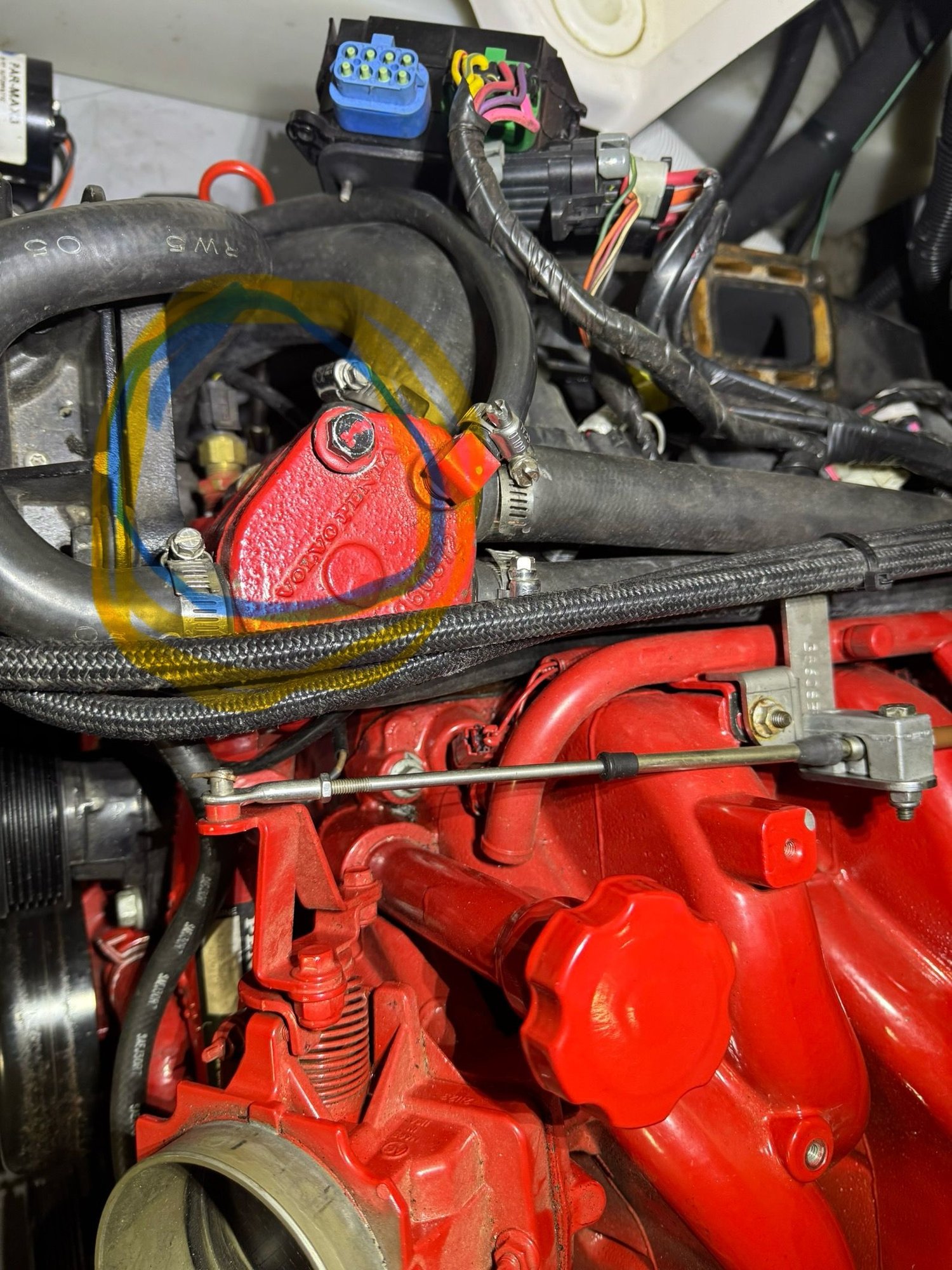

There are two water temp sensors, locate within about 12” of each other on the thermostat housing and crossover tube.

Temp senders

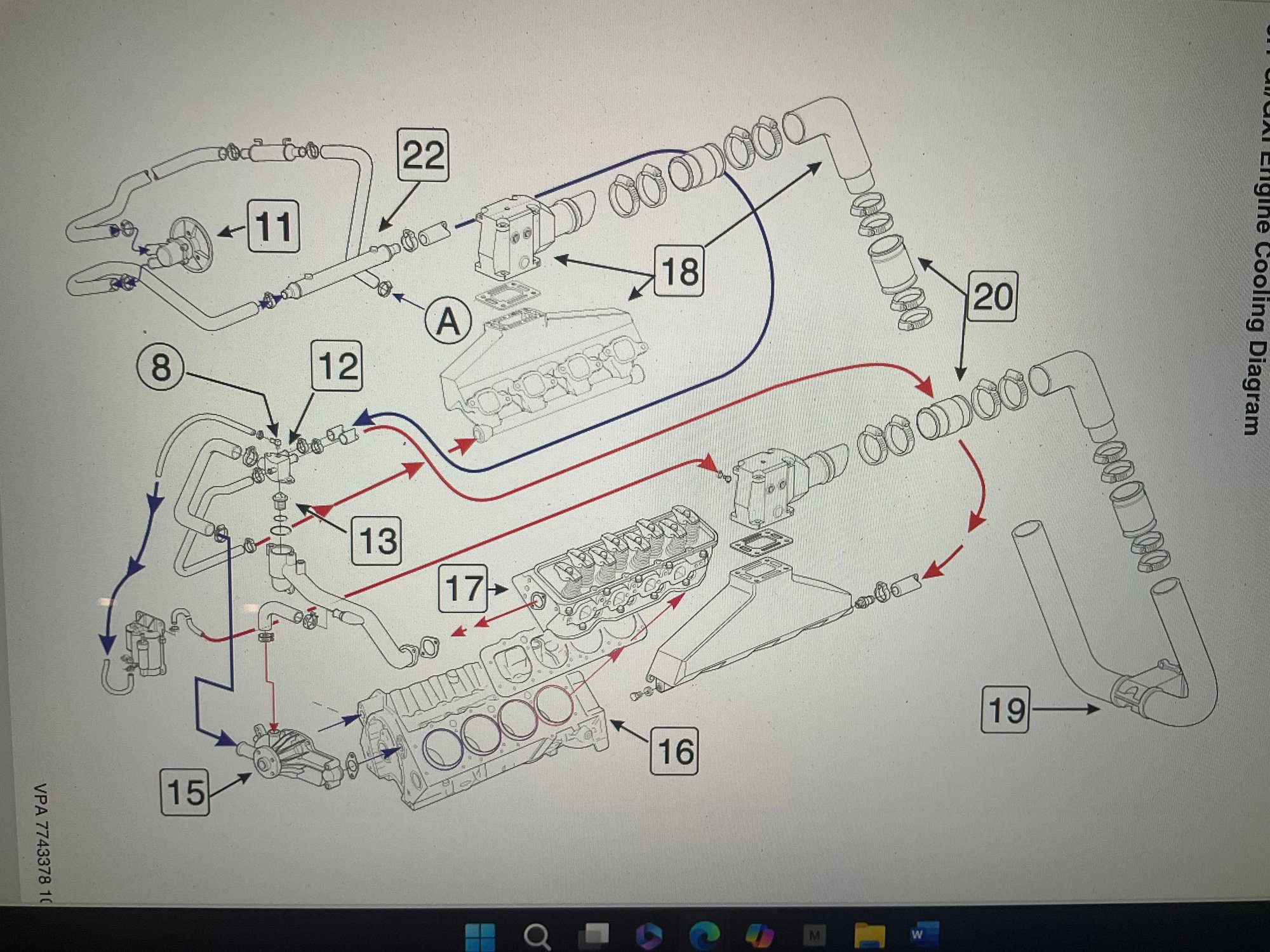

No water pressure sensor or gauge on this one. I can probably hook up a temporary one inline. I thought about mounting a GoPro back there to watch that hose. Wish they put a stainless steel spring inside or a stiffer hose. What did your friend do? Just replace the hose?
Yes, he replaced the hose assembly in the transom assembly. I would definitely hook up a temporary water pressure gauge. There may be a port on your intake or t stat housing that you can use or if not, you can use one of the block drains.
My guess is your issue could be the hose circled in red. The hose my friend replaced was essentially this hose in a Bravo transom assembly.
