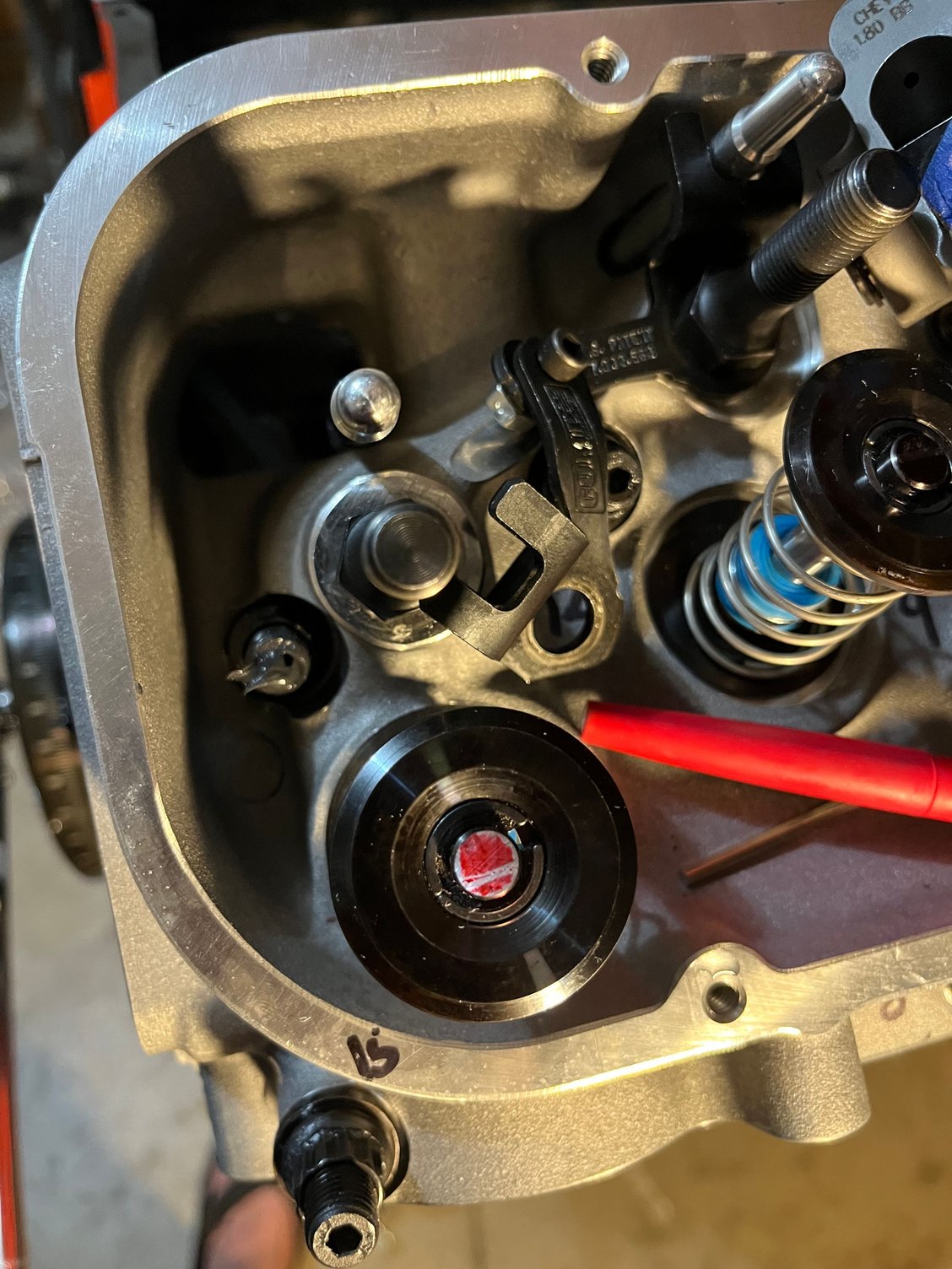

The exhaust push rod witness mark looked good, first photo.
Exhaust valve marking

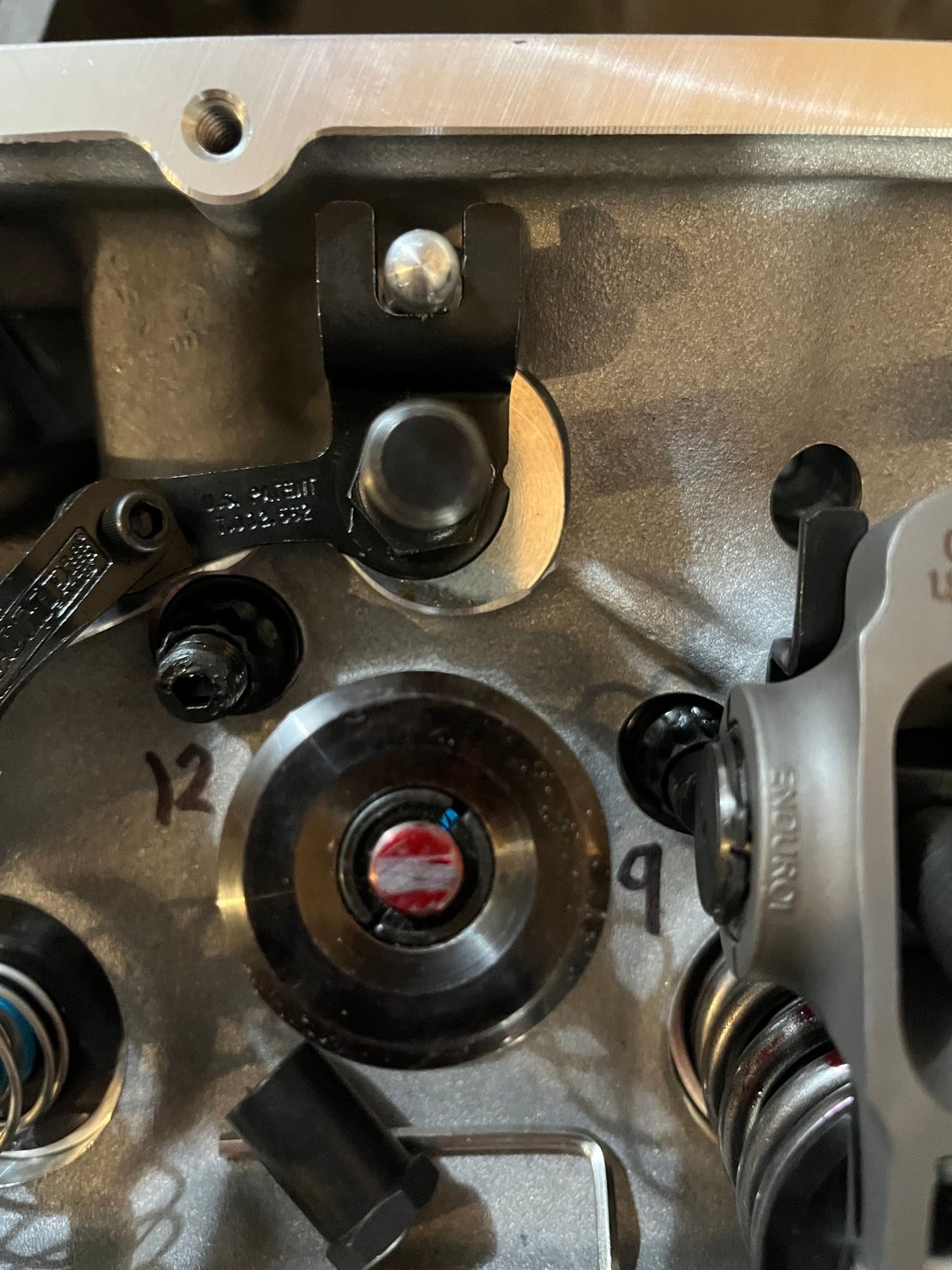

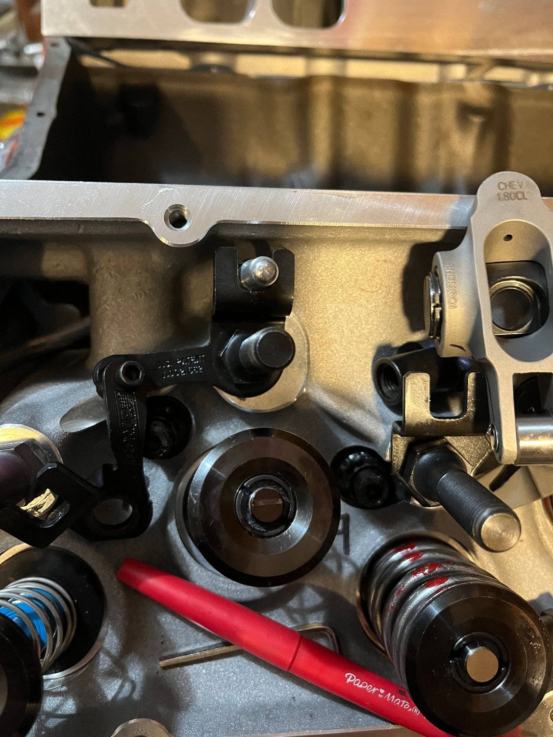

The intake valve is another story. To get a narrow mark I have to have that rod fairly long, such that it puts the mark near the edge of the valve. On top of that, I most likely need a longer stud for here. 2nd photo, close to the mid lift process. The 3rd photo is of a shorter rod and as you can see the witness mark is centered but very wide.
Intake mid lift approach.
Intake valve shorter pushrod centered mark but wide.

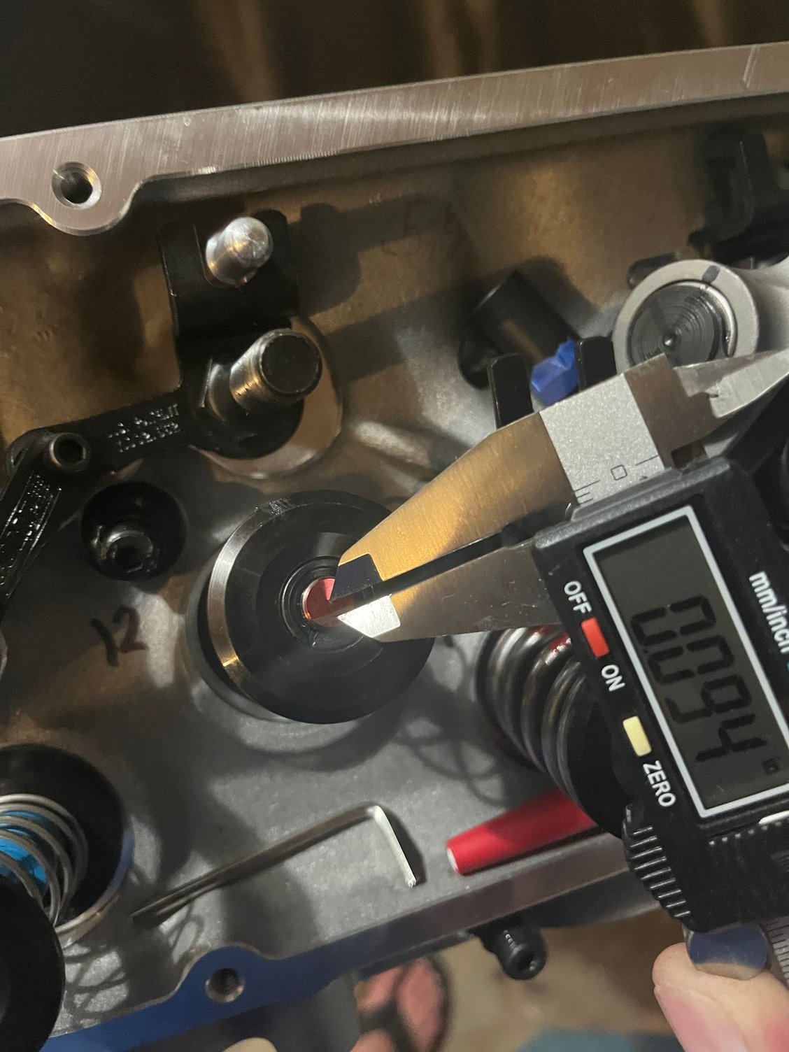

below are the results of that test and then with a micrometer. I measured center of mark to back toward center of valve. The largest offset crower has is 0.090 so I’m thinking that’s what I need.
do you agree?
Micrometer reading.
do you agree?
Micrometer reading.

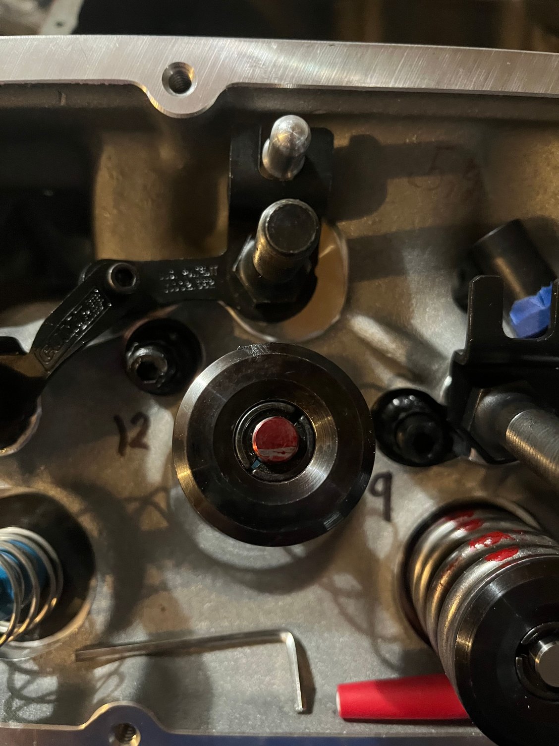

All right…. Update guys, need to hear your blessings on if these are ok.
Below is the repeat of the exhaust valve, which I think looks good. Estimated contact pattern width is 0.042”.
Exhaust
As suggested, thank you, I picked up an 0.090” offset rocker and below is the intake pattern, estimated at 0.056” width.
Intake
Am I good to go and move on to the next stage of this build?
Intake

The original exhaust pic looked not bad. Was narrow and relatively centred,
The exh you just posted is not like that˙ at all.
I wouldn't run the exh the way it is. Too far off the center, despite being narrow.
The intake looks far better now. Would the 0.050" have place the contact patch in the center vs where the 0.090" pulled it past center tonthe other side?
