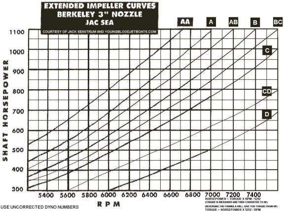

The problem with jets, in regard to cam'ing, jet drive need high rpm to get the water flowing effectively. You end up with a high cruise rpm with a high vacuum. The engine doesn't work very hard, but it's inefficient.
Berkely impeller chart:
https://cimg6.ibsrv.net/gimg/www.off...b72379d24d.jpg
500 HP at 5400 rpm. That's if the A imp isn't already cut down to increase rpm.
450 HP at 5200.
Cam: HR mid 22x Int with a lower 23X Ex with 0.550" lifts.

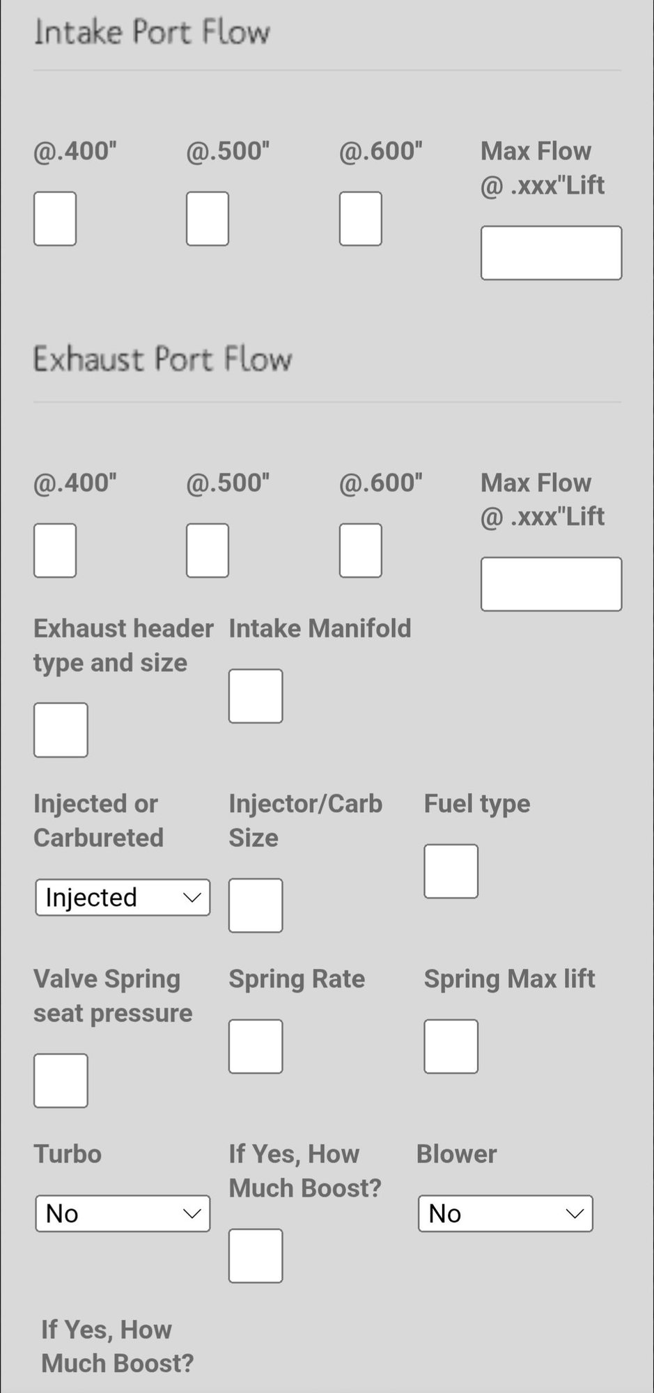

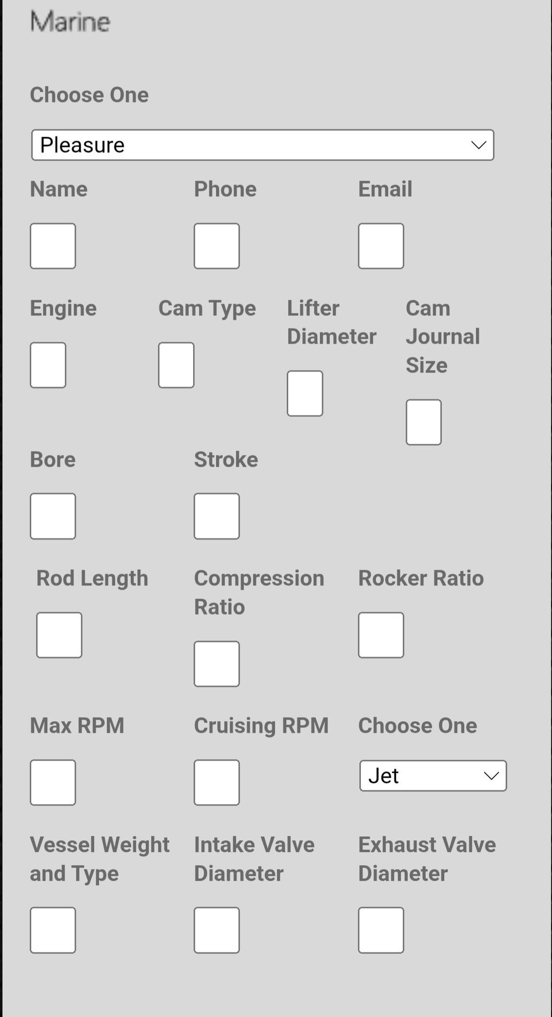

Jones Cams Marine Cam Selection Sheet copy:
https://cimg1.ibsrv.net/gimg/www.off...a808276d5e.jpg
https://cimg3.ibsrv.net/gimg/www.off...4fd6b358d7.jpg
There's a drop down selection where it says 'Jet' for various drive systems.
Where it speaks to seat pressure etc, that would/could be prescribed by the cam suggestion...unless required to work with what you have etc.
