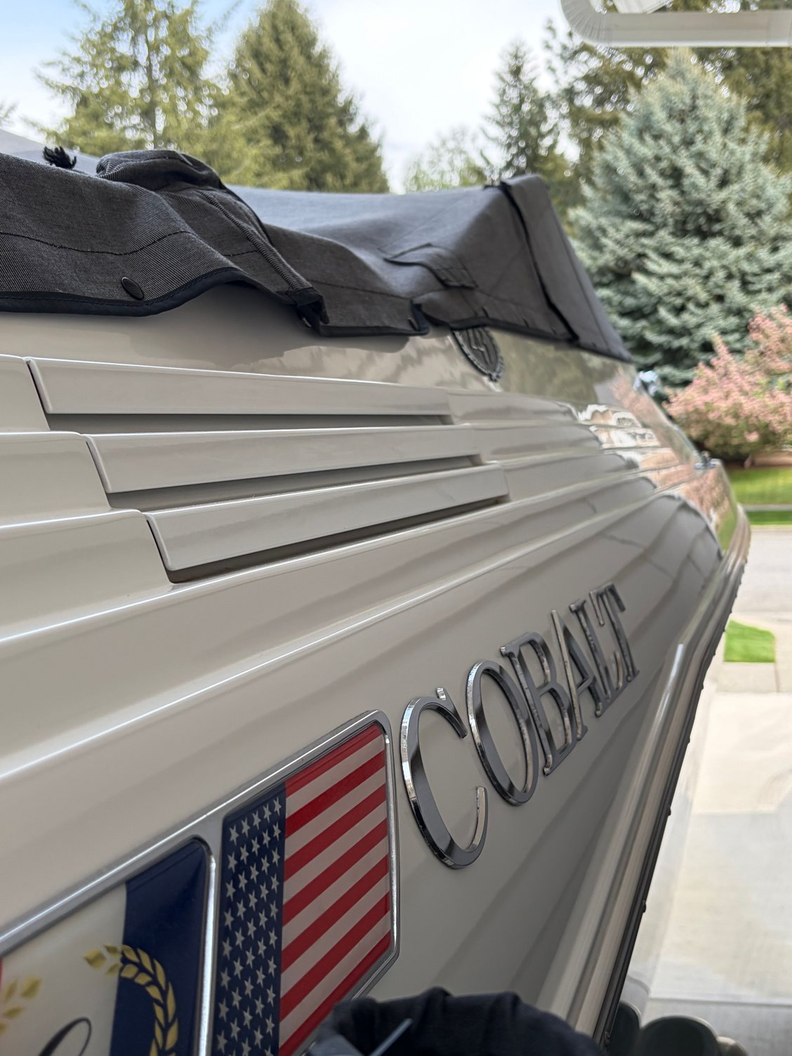

Port side has no plenum box just open to engine compartment. Both terminations are non-directional.
https://cimg1.ibsrv.net/gimg/www.off...0ed85cb2c.jpeg

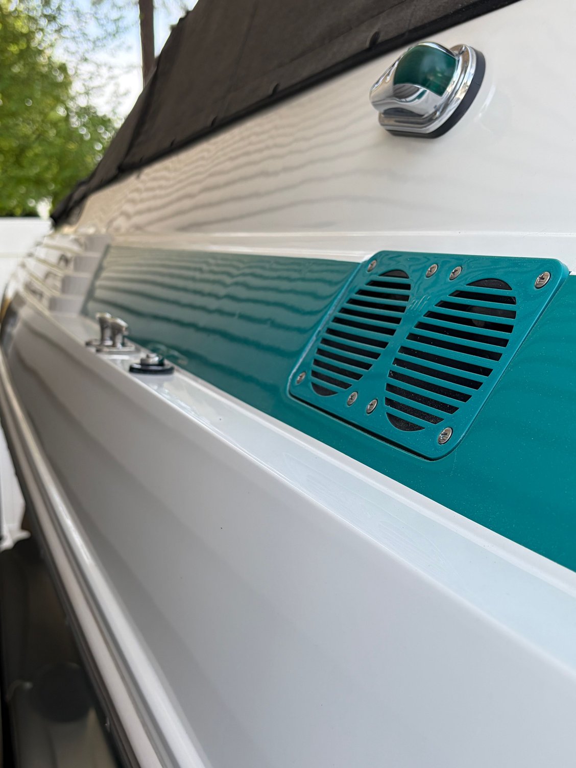

Starboard side does have these two small vents that may tie in somehow…
https://cimg7.ibsrv.net/gimg/www.off...5bbd6b940.jpeg
Starboard side 7’ forward of exit vent. Must tie together in behind upholstery.

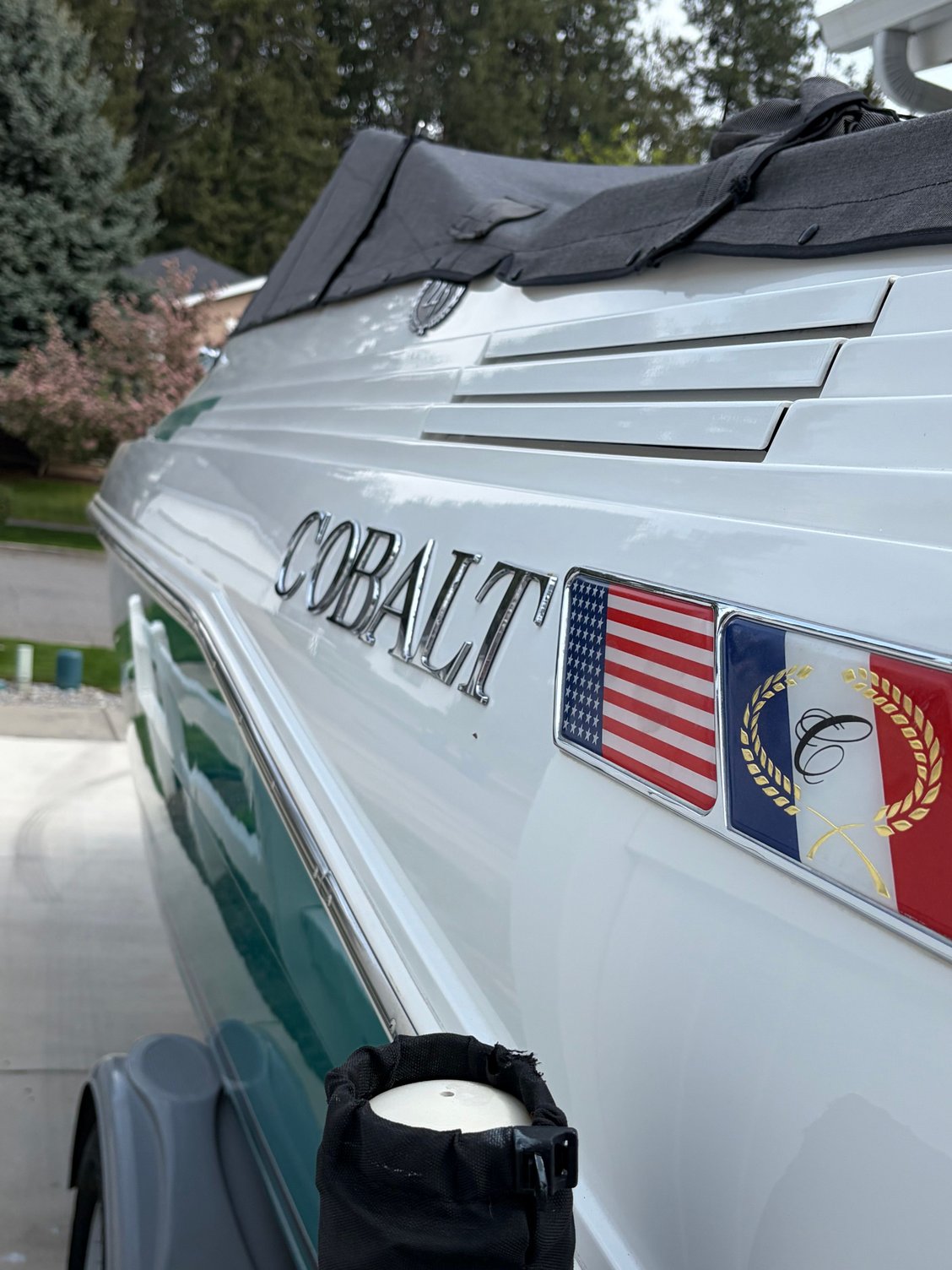

https://cimg8.ibsrv.net/gimg/www.off...af9a9d6ca.jpeg
Starboard side non-directional termination.
