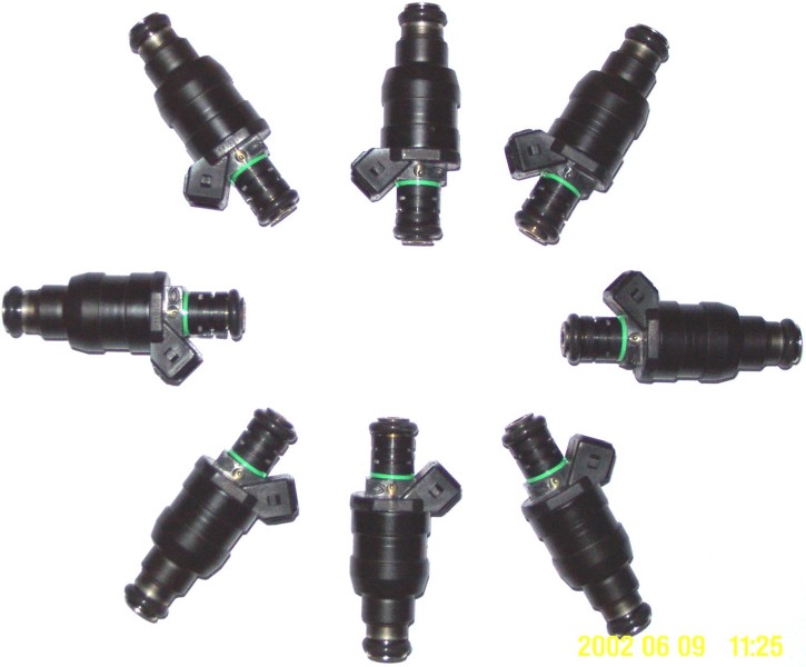

What injectors are you running? Are they the same impedence as the original? Could the ECM injector drivers be overloading?
Elite Marine 04-21-2003 03:47 PM
I'm running Lucas 42# injectors:
http://www.racetronix.com/product/In...s/621031a1.jpg
Elite Marine 04-21-2003 03:48 PM
These injectors are 15.9 ohms
