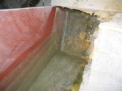

Well finally got to spend some time on the old girl this weekend. First thing I did yesterday was to glass the other side of the bulkhead. This did not take long, probably only a hour or so.
Attached Thumbnails Stringer Replacement Formula 302-35-bulkhead-glassing-small-.jpg

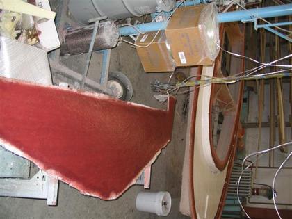

I am using the Okuma/Okume on all the stringers and bulkheads. The slight addition in cost seemed worth it to me. I am not adding anything as far as stringers or bulkheads. I figure the boat lasted almost 25 years the way it was before and it was done incorrectly (IMO) the first time so now with the new stuff it should be good for a LONG time to come
I then took DB glass and cut it to shorter more manageable lengths. This also allowed me to go around all the corners easier. For each location I did three layers of glass.
Attached Thumbnails Stringer Replacement Formula 302-38-stringer-tabbing-small-.jpg

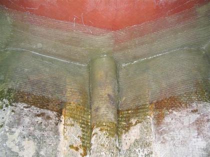

This is a picture of what it looks like all tabbed into the boat. Going around the drain proved to be a LOT easier then I thought it would be. One of the nice things about DB glass is that it bends easy.
Attached Thumbnails Stringer Replacement Formula 302-36-stinger-tabbing-small-.jpg

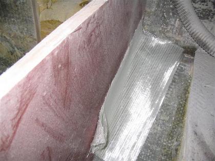

I used cabosile/cavosile (same thing as West System 401 first to trowel in a radius for the glass to go around. I mixed up a good paste and then used a bondo spreader to radius the turn. The Cabosile is great also for sticking down the glass and bonding.
Attached Thumbnails Stringer Replacement Formula 302-37-stringer-tabbing-small-.jpg
