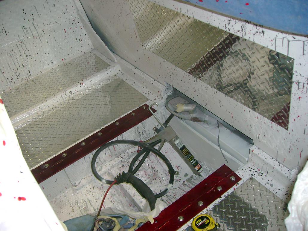

I wanted show you my new motor mounts. I had to do alot of stringer repair in the bilge, then fabed some killer new motor mounts at Sennekers. I used angle Aluminum, then welded an ear on it so it totally hugs the stringer. It's bolted down with 20 lags and epoxied. Check it out. I also bought a harwood scoop from Cig3. Attachment 324105

Nice! Send me the pics via e-mail.
Be sure to add some glass to the inside of that harwood! I would hate to see you kill someone this summer:angry-smiley-038:
